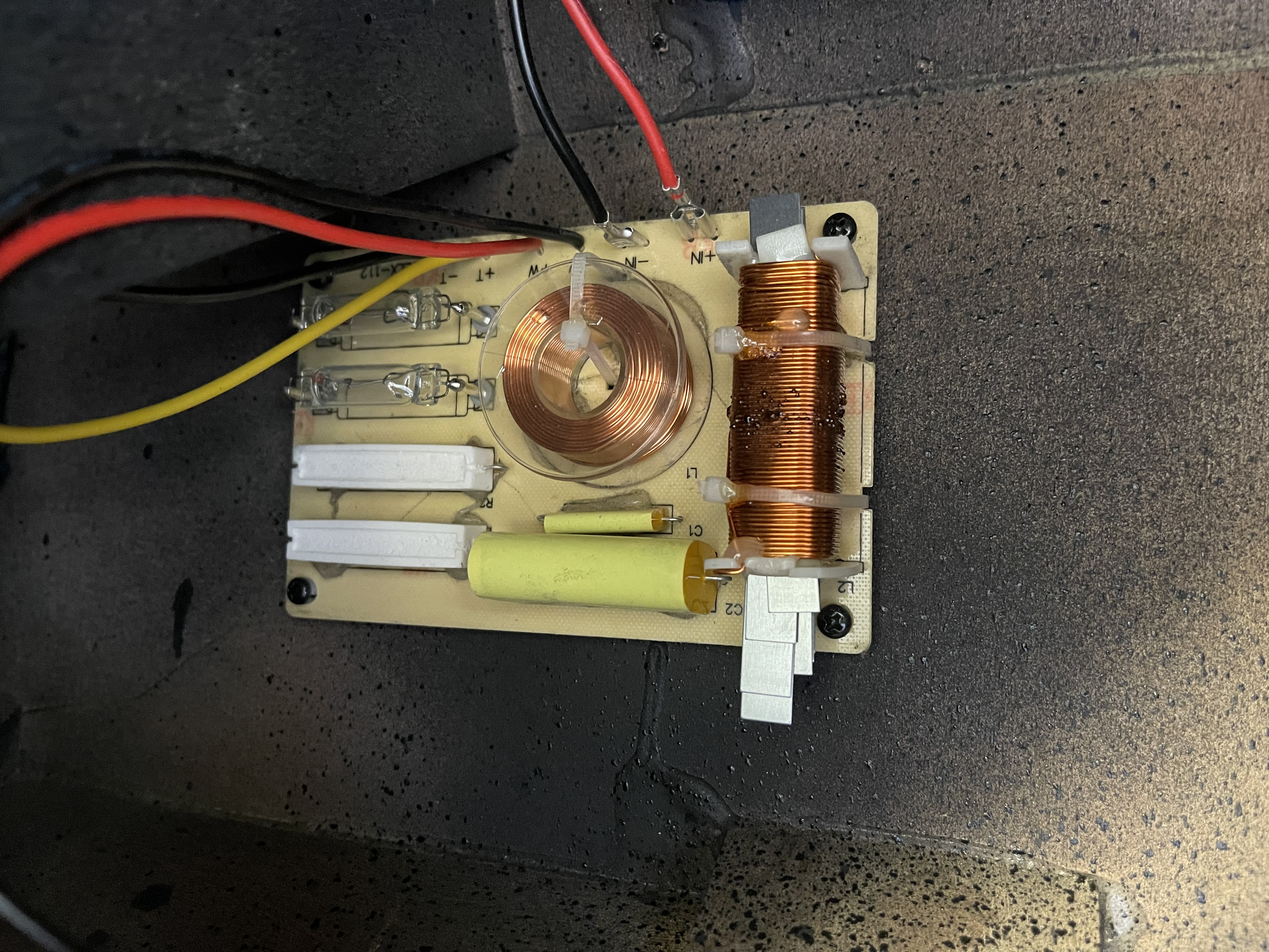

Local venue brought me another blown monitor. I've already replaced two drivers for 'em. Popped out the driver and it's toast. But, it's what I saw inside that has me concerned.
I've never seen an inductor/coil with it's guts hanging out. The plates are stuck there and I couldn't get them to slide back in. The crossover is passing signal/voltage.
Could that thing cause a blown speaker?

That would only happen with extreme overpowering. Since it's cored for minimum DCR it's likely the lowpass filter, with the coil wired in series with the woofer. The overpowering would easily toast the woofer voice coil, which would be of a much lighter gauge than the inductor wire. It's a very safe bet that their monitor amp isn't limited or high passed.

Are you saying that the damage to the coil is from overpowering?Bill Fitzmaurice wrote: ↑Mon Aug 12, 2024 12:38 pm That would only happen with extreme overpowering. Since it's cored for minimum DCR it's likely the lowpass filter, with the coil wired in series with the woofer. The overpowering would easily toast the woofer voice coil, which would be of a much lighter gauge than the inductor wire. It's a very safe bet that their monitor amp isn't limited or high passed.
Absolutely no question that its overpowered. QSC4050 driving monitors. I've stressed to them to keep the monitors high passed at no lower than 70hz. But, the regular guy who I've trained isn't always there.
So, is that coil damaged in a way that would cause the driver failure? Or, is it ok and it's just an overpowering issue?
I'm thinking of putting in a 3012HO with much higher xmax to try and help the situation, buy don't want to blow a new, more expensive driver because of damage to the coil.
Should that crossover be repaired or replaced? Or, does it just look bad, but is still functionable in that condition?

The coil appears cooked. It would take a lot of power to do that, more than enough to blow the woofer. It may be OK, or there could be shorting between the windings. I can't think of how the individual leaves of the core ended up like that. I also can't imagine running monitors loud enough to damage even the woofer, let alone the coil, unless it's total garbage.

The way the crossover is positioned in the box, I was wondering if it had been dropped to cause that, but I couldn't push 'em back in there at all - so I doubt dropping it could cause that.Bill Fitzmaurice wrote: ↑Mon Aug 12, 2024 4:32 pm The coil appears cooked. It would take a lot of power to do that, more than enough to blow the woofer. It may be OK, or there could be shorting between the windings. I can't think of how the individual leaves of the core ended up like that. I also can't imagine running monitors loud enough to damage even the woofer, let alone the coil, unless it's total garbage.
The boxes are EV ELX112. Not bad sounding boxes. But this is the 3rd driver (woofer) we've lost in less than a year. I figured it was over-excursion and probably was on the others.....maybe on this one too......but never with the coil doing that.
I think I'll try to get 'em to replace the crossover and be done with it. Just hung up with the sound guy there and went over some preventative measures that might protect 'em. I guess we could turn down the volume on the amps. At least they are located in the basement where they shouldn't be touched. Might be worth doing that as an extra meaure of protection.

I noticed that there are a bunch of tiny blobs on that same coil.

Yeah, it kinda' looks and feels like glue. Maybe it bubbled up when it melted.
