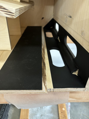

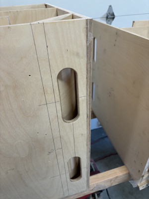

Question: For the T48 square backs I'm building I'm considering pre painting the inside of the cabinet and the face of panel #9 where it is going to be visible through the hand holds. Same for panel #11 at the back/bottom corner.
Will that affect the PL adhesion in any way if it's a painted surface? I'm using flat black exterior latex paint (it was the cheapest) as a primer and would use that in these cavities to black them out.
Couldn't find anything specific about this on the PL data sheet. If that's a problem I can probably tape off where the joint is and keep it bare. But if I don't have to worry about it I'd like to know. Thanks!

- Posts: 8677
Re: 4x T48 and 4x OT12 build
Put some blue painter's tape on the glue lines, paint it, pull off the tape. Then you have a clean glue line and paint where you want it.
Ya that's what I did.

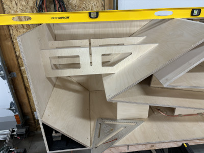

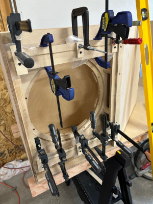

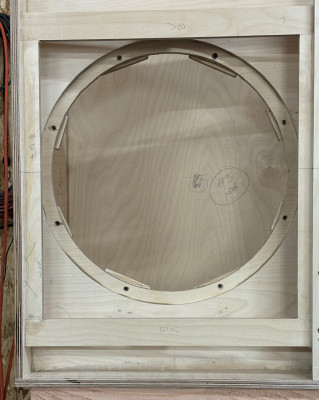

Haven't updated in a while. Been slowly making progress. Spending a lot of time figuring things out, making templates, dry fitting, and on just overall OCD perfectionism. I get a lot of satisfaction out of a day in the shop. My wife feels a bit abandoned lately but we're about to leave on a 3 week trip around England and Scotland so she'll get some attention there.
Have one T48 cab just about ready to put the final side on. The other 3 are trailing not far behind. I'm definitely glad I'm building one first this way as recommended by Bill and others. I've had to correct several mistakes on the first one that taught me how to do the other 3.

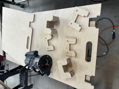

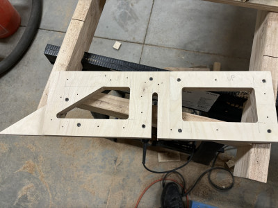

Speaking of templates, thought I'd share a few more I did. Really worth the time to make them!
Cutting the 6/10 braces. The half inch template bit makes a perfect slot! I'm using recessed corner casters. The cutouts were tedious with a jigsaw but with a template & router, piece of cake! Btw, those are stacks of caster anchor braces there in that last photo. Maybe not necessary but I felt like why not. One of my guys rolls it off a curb or something and there might be some significant impact. Better safe than sorry.
