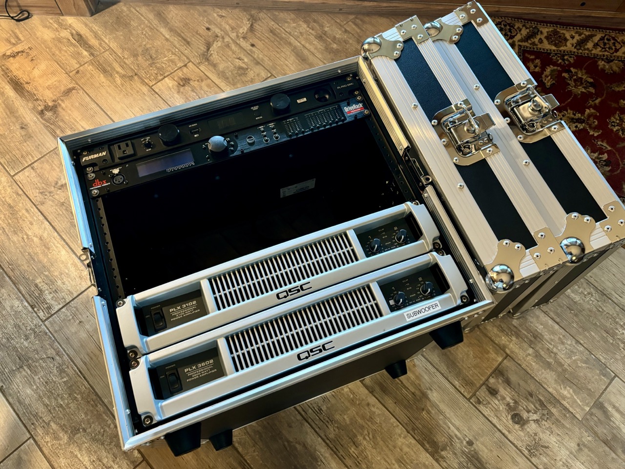

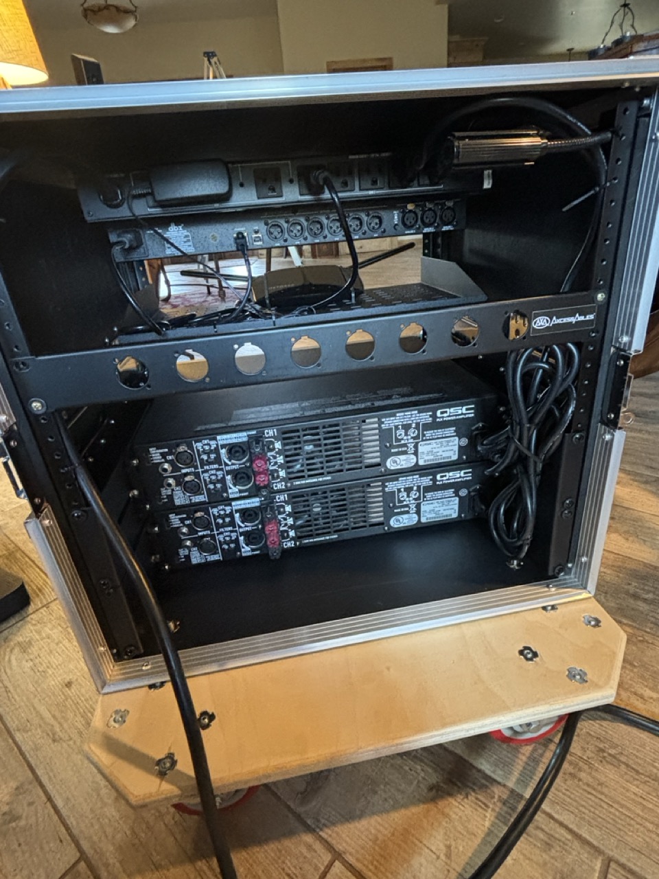

The amp rack is coming together too. (Still need to put a caster board on it)

Amp rack has wheels now and I just need to wire it up. I'll paint the caster board when I do the speakers.

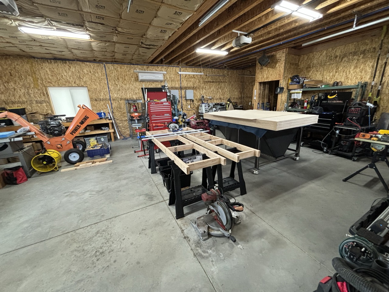

Had some other shop projects I needed to work on to clear space to start this build. Did that and now have the BB in the shop and built my cutting table. Pretty much ready to start cutting panels. Santa in the brown truck comes tomorrow with all the drivers!

What little time I had over the weekend I spent finishing up the wiring in the amp rack. It's ready to gig now.

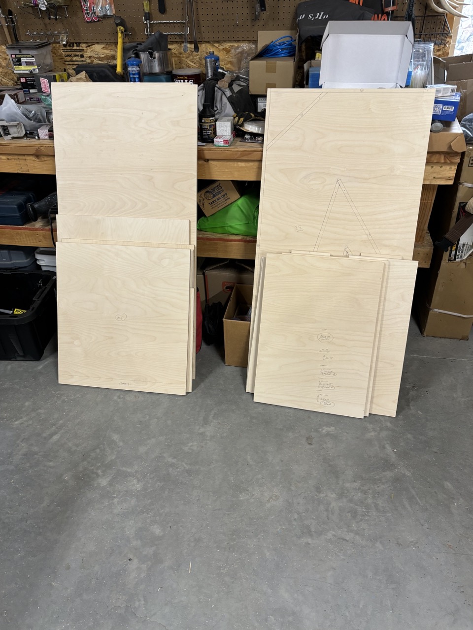

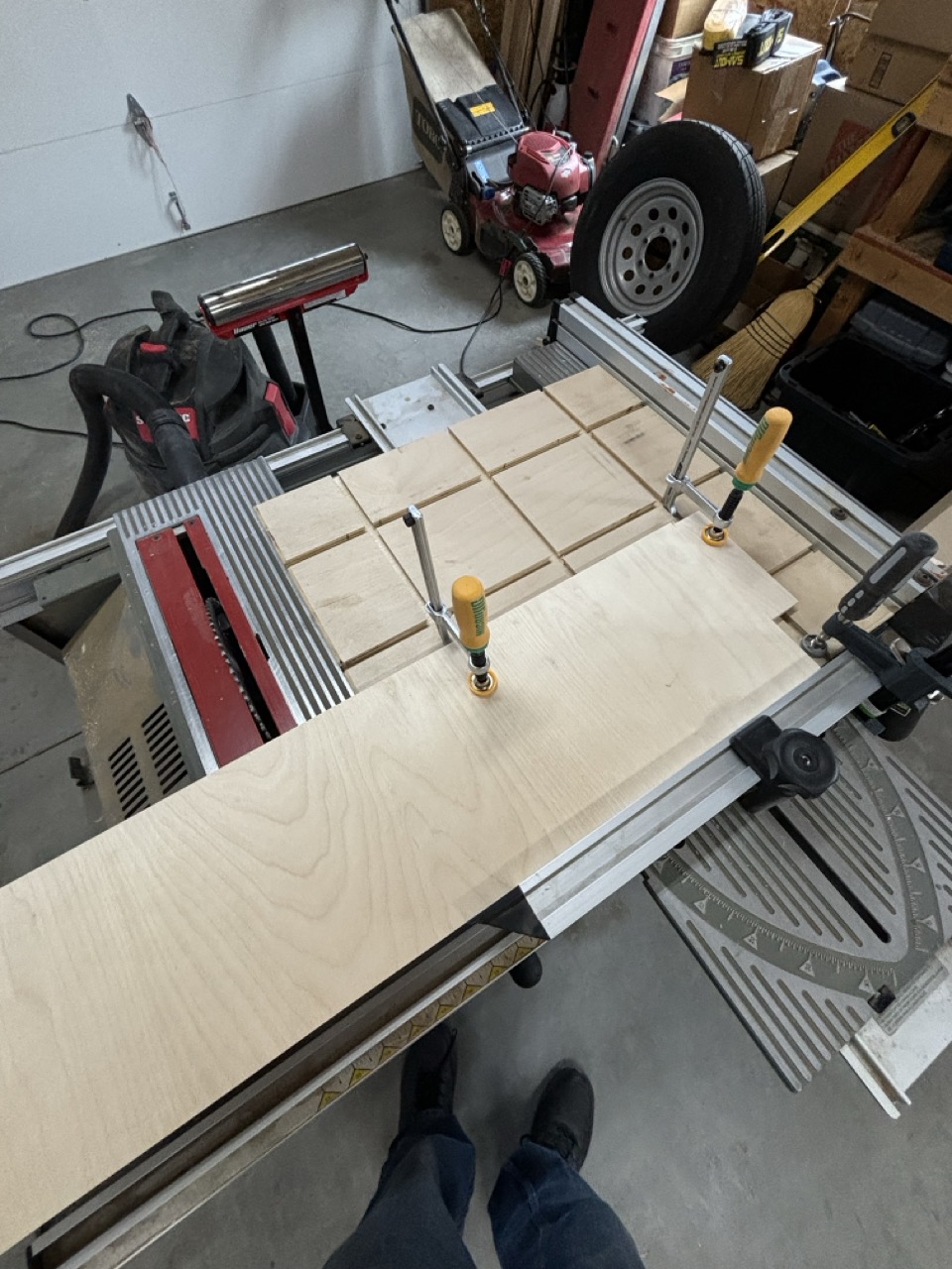

Finally started cutting yesterday. Doesn't look like much but this is a solid half day in the shop.
I'm going slow and following Bill's suggestion to cut and assemble one cab first. Then do the rest. I'm glad I am because I'm getting a list of questions how they'll actually need to be cut to fit as I cut panels. I'm writing questions and notes on each panel so when it comes time to fit it, I'll capture the results in my build notes and have a better idea when cutting for the rest of the cabs.

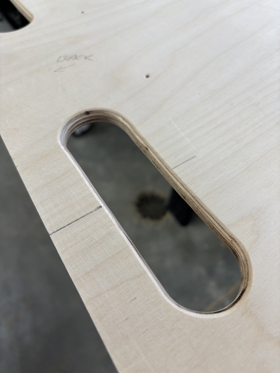

What are folks using to round off hand holds in the top and bottom of T48 full back cabs?
I’ve got a 3/8 in radius round off bit that looks good for the outside but the inside (except for where I the 1/4 round goes) is still pretty sharp. Once one side is rounded can’t use a round over on the other side. I guess I can just sand it some but wondering if any one has found a good solution.

You can round both sides, you just need to clamp or screw a piece of plywood to the already rounded side for the router base to follow.

Ok why didn’t I think of that? I can just flip the template over to the other side.

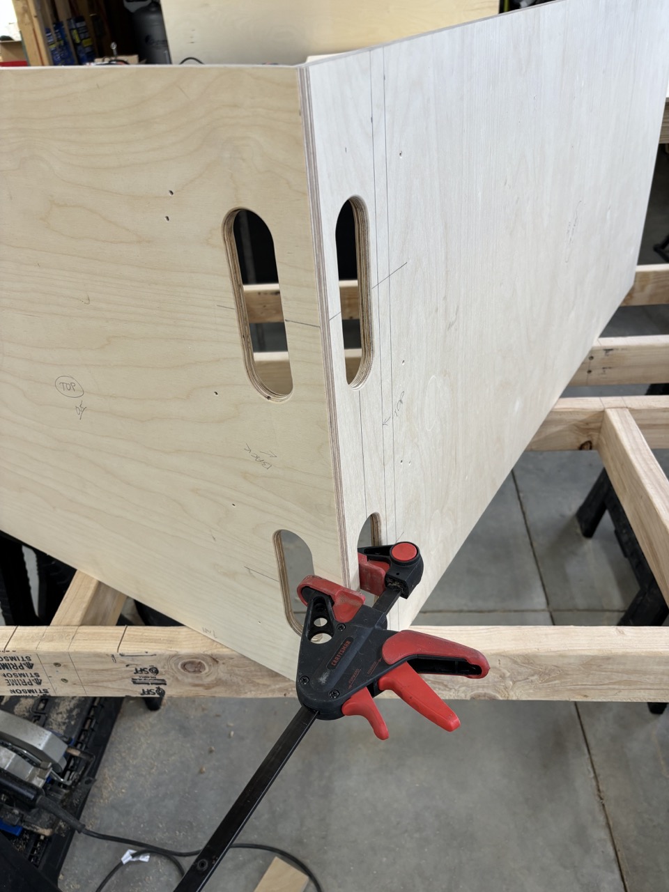

Ok pic heavy update.

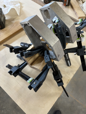

Things have been slow from a build perspective. Spending a lot of time on jigs, templates and just figuring things out. SO glad I followed Bill's advice to go all the way through one cab first, then build the others.

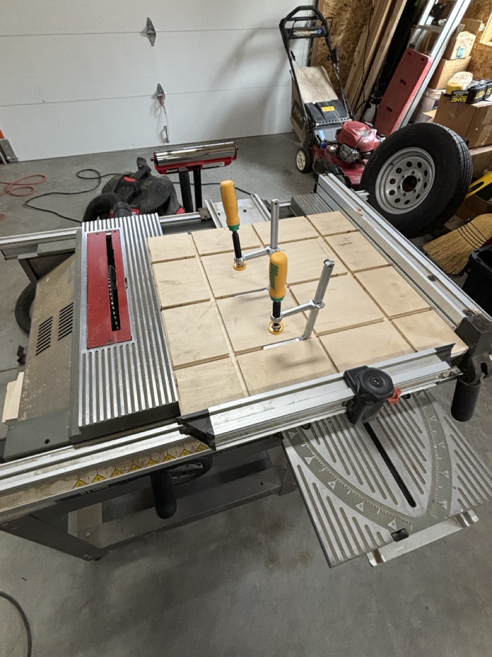

Built a small parts jig using MicroJig stuff.
The jig at work.

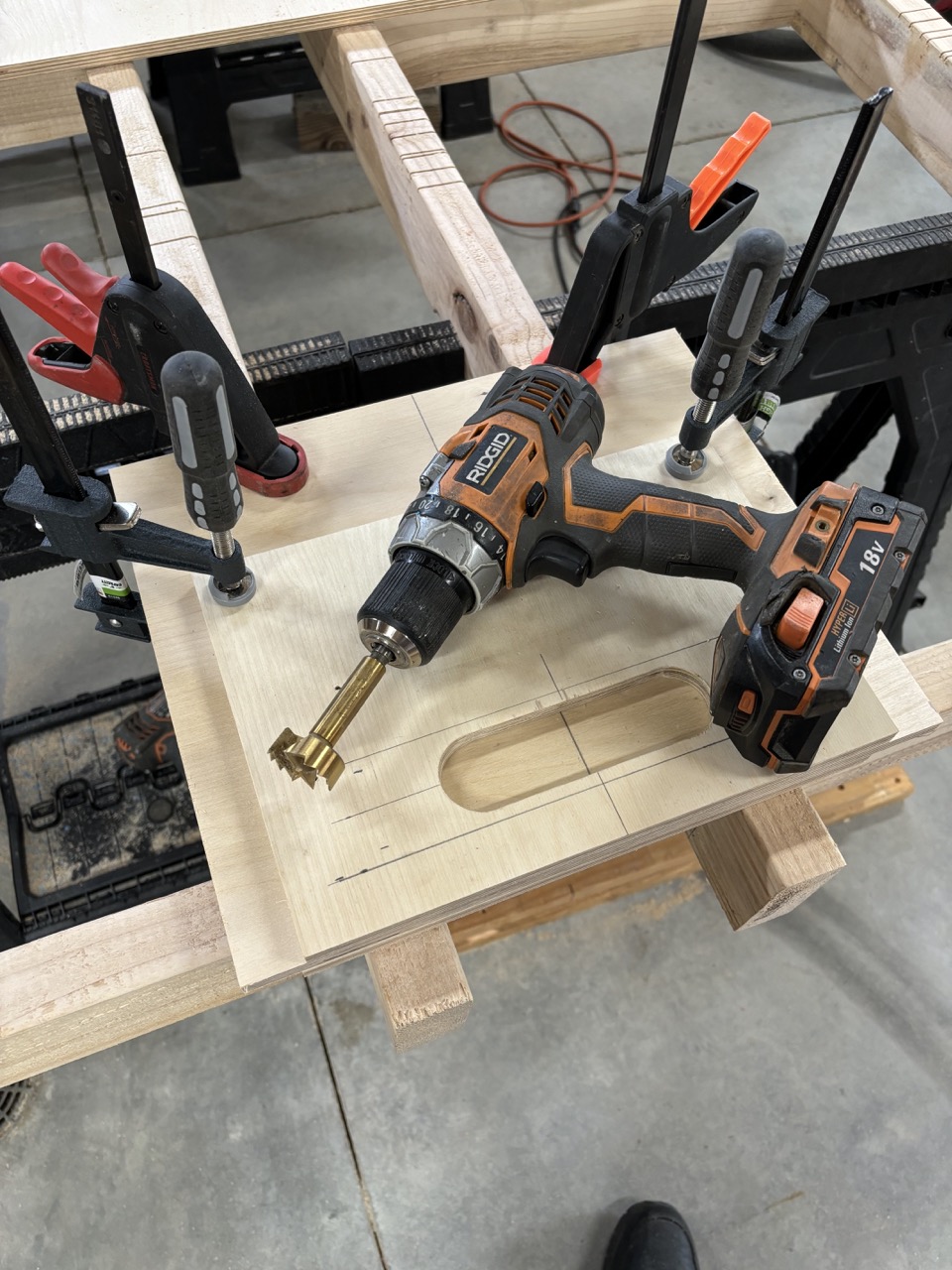

Spent a lot of time figuring out just how I want to do the hand holds. Experimented around with several iterations on a router template. There may be better ways but this is what I came up with. Note using the Forster bit to remove some material really helps. If you've got a better router and better bit you might not need to but this helped with my wimpy router. I'm using a 1/4" trim bit with a bottom bushing so template has to go underneath the work.
The template is made so the edges is EXACTLY aligned with the edge of the top. Add a piece of 1/2" scrap when aligning with the back. The template cuts the hole so there's exactly the right clearance inside for the 1/4 round. I have a center line in the template that lines up with the centerline of the hole on the workpiece. I line up the template with clamps then mark the hole. Remove the template and use a slightly smaller Forster bit to remove some material. Clamp a sacrificial piece underneath to prevent blow out.
Realign the template edge & centerline and clamp it. Flip it over so it's on the BOTTOM. Screw it on from the top with flat head drywall screws and be sure the heads are below the surface so they don't interfere with the router. Now trim to the template.
Here's a hole rounded off with a 3/16" bit.
Test fitting the Top & Back to see how it's looking.

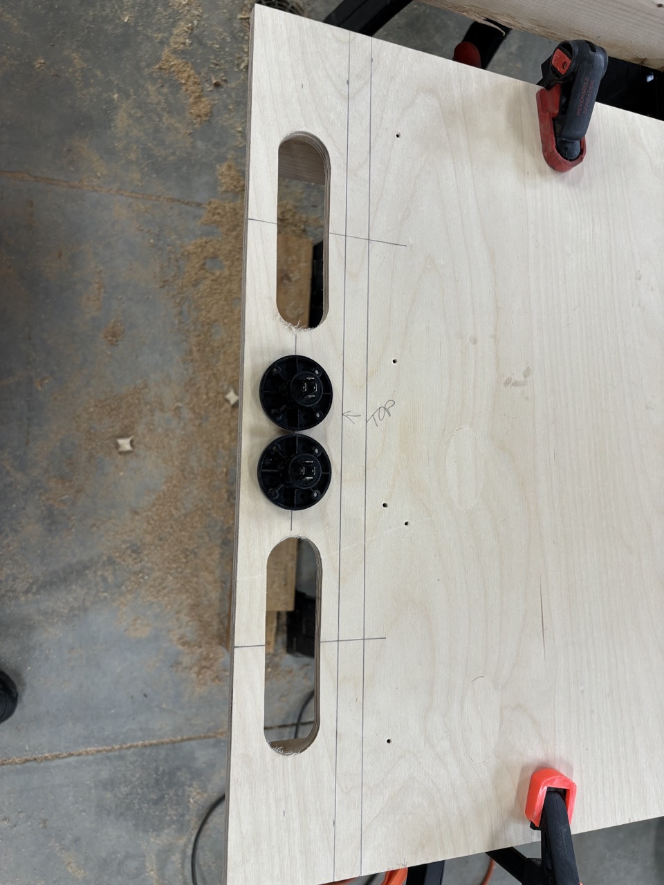

Then I realize I may not have left enough room between the handles for my NL4 connectors. So I check and it's really tight but I think they'll work. I had just picked an arbitrary distance (6" from the side) to center the handles because it looked good. Should have thought that one through a bit more.
If only I'd set the handles 1" each way to the side I'd have 2" more there and be fine. I'll probably do that on the remaining 3 cabs even though this one will be different.

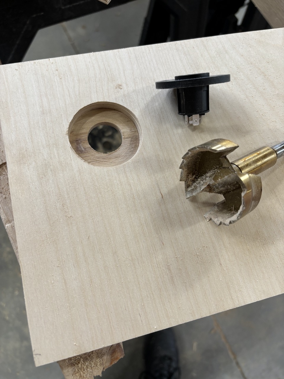

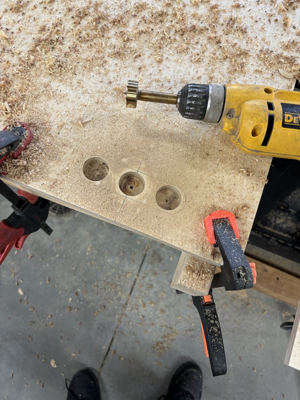

My plan is to inset the NL4 connectors so they're just flush and put a backer behind that for the screws to go into. This is me experimenting with that inset and test fitting in some scrap. Again, using Forster bits. A 2" in this case for the inset and a 1" for the center hole.
There's really not much room behind panel #9 up in the top of the cab. But that seems like the most desirable (for me at least) place to put them.
