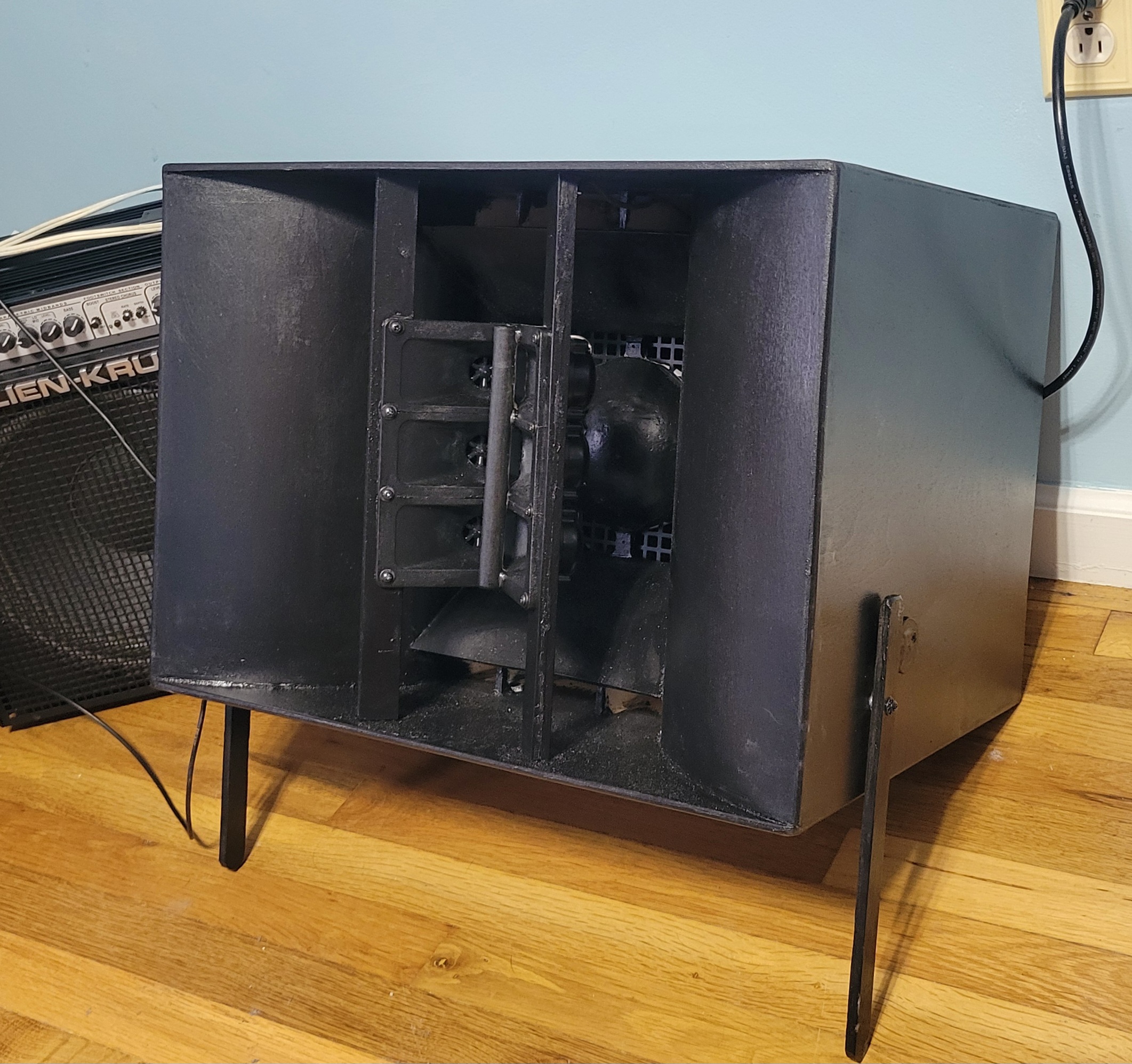

Thanks again. I just glued up 4, but no big deal to add 2. Makes sense to have the extra sensitivity, if that is the correct term. Anyway, I think it will look better too.

Yes, this has been a different kind of project, but the plans are really great. Bill's advice to go slow and just do a little at a time is really smart. I don't know about form regarding starting another thread, but I've had great help with my questions here. Must admit it's taken me a while to soak it all in, but I can tell you the cab sounds really spectacular. I've been stumbling through, but Bill's plans really cover the details extremely well. Just put some black primer on yesterday and played music and my five string through it. Fantastic. One thing I need to figure out is if there is a way to regulate the hiss out of my tweeters. I took the easy way out with crossovers and just put in two pre-made boards from Dayton Audio. Super simple and it basically works, but probably best if I now build up the exact design Bill shows in the plans ....anyway, maybe there is a simple pot to put in line somewhere and just back off on the tweets. But I sure don't want to lose the sound in the process! I fully agree with Bill about the tweeters being essential for bass. I ended up with a melded array using 6 tweets. Excellent
I did rig up legs for it to tilt and will try and post a picture shortly. All I can say is go for it!

First timer - just primed, no duratex yet
