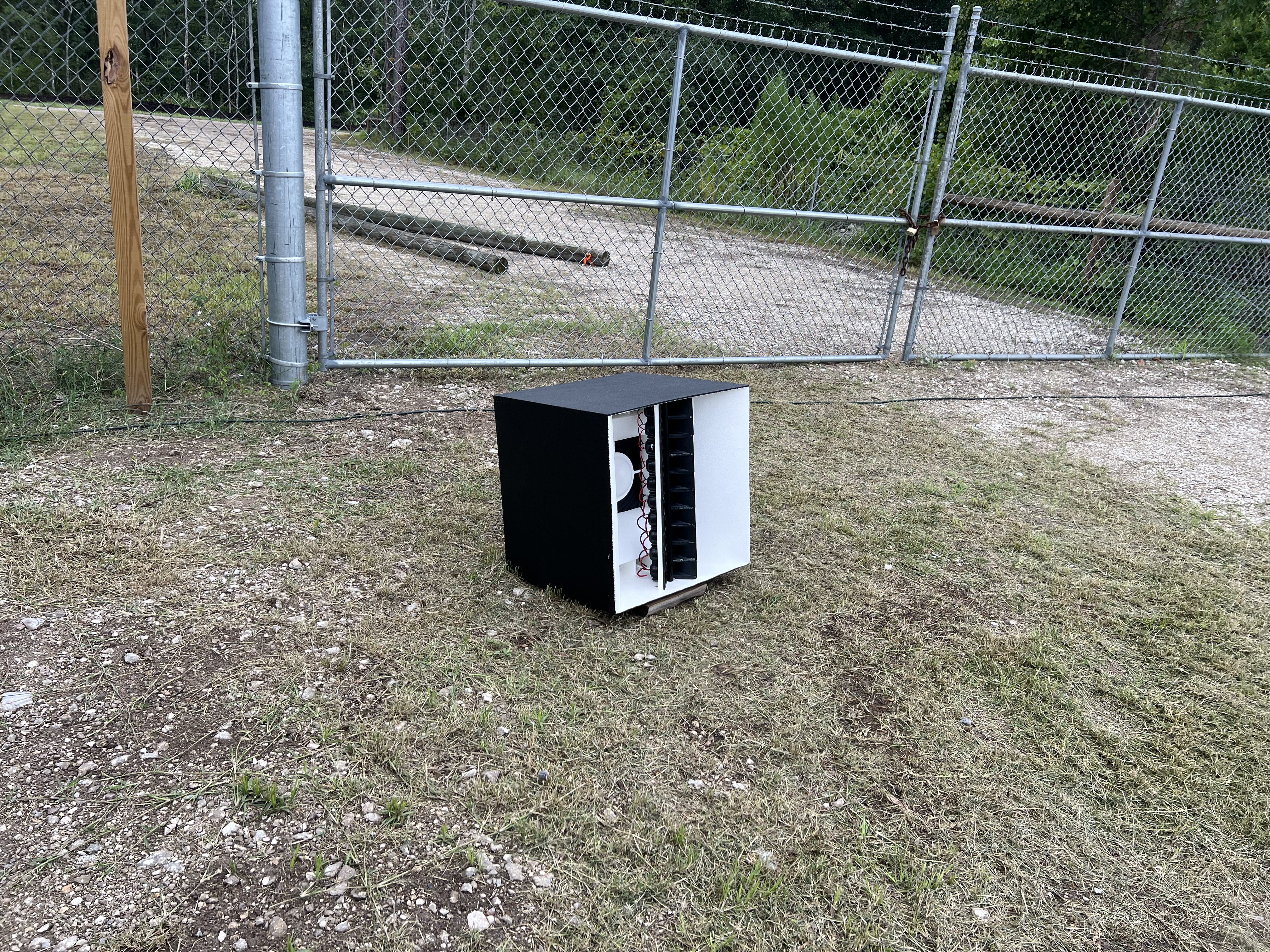

Practically fully completed this cab. Is it perfect? Not by far. I am glad I took on the challenge though and will be better off for the next build. It needs the glue residue taken off the tweeter faces, even though I used wax paper on the jig. Maybe too much glue. Some touch up Duratex, etc.
You can see it is powered by a Milwaukee M18 tool battery which feeds a Dayton 4x100 watt bluetooth amp module. I bridged two of the channels for the woofer. I am pretty happy for casual listening by the pool and such. Many fellow listeners were also impressed by it. I wired the tweeter crossover with the ‘less bright’ resistor option, yet it is still plenty loud in the highs department. The bottom end obviously suffers from lack of power. The amp certainly needs EQ work to reduce the bottom end. The Apple Music preset EQ functions are decent in the meantime. I run it on the ‘reduce bass’ setting. The vocals are incredibly clear and defined even at 75’ away with such power.
Trying to figure a power and amp solution still as the temptation to turn it up is mighty strong. Very apparent this cab has much more to offer if given what it wants in terms of power. The plate amp is the obvious best fit, but lugging around a power station or generator is not. Will either do a custom LiFePO4 pack built in an ‘add on’ back panel with a step down converter for a 12 volt amp or something else. The Sure Electronics modules don’t make much true power at 8 Ohms without much higher voltage. I just strongly prefer a one box self contained cabinet…a boombox so to speak. Any other power/amp ideas are welcomed!
For fun, I had it running in a standard cab F-150 truck with the doors shut. Wow, the cabin gain is unreal!! It’s wild the responsiveness/punchy nature this cab has. Could only imagine if an AutoTuba of sorts would be as punchy and loud (yes, I know it’s a much different design)?

That amplifier should have plenty of power for that cab. The battery voltage is limiting the amplifiers output capability. If you wire a second M18 battery in series, the amplifier will likely put out 4x the power it currently does, which equates to +6dB maximum output potential, slightly less than twice the current perceived volume max. I'd recommend you add a second battery before trying anything else.
Alternately, you could try a voltage boost converter like CarterKraft used in his Omni 12 Tall Boy Build to get the voltage up. However, a second battery would be my choice.
If you haven't read it already, that Tall Boy thread is a good read and has lot's of tuning advice pertinent to your project too.
Once you get that done, you can use your smartphone and a free RTA app to dial in the EQ. Once you get that set all tasty, you can use the "Super Bass" plugin to fool your ears into thinking they're hearing subwoofer frequencies for a nice full sound.
Please keep us posted as your project continues and feel free to ask as many questions as you like along the way.
