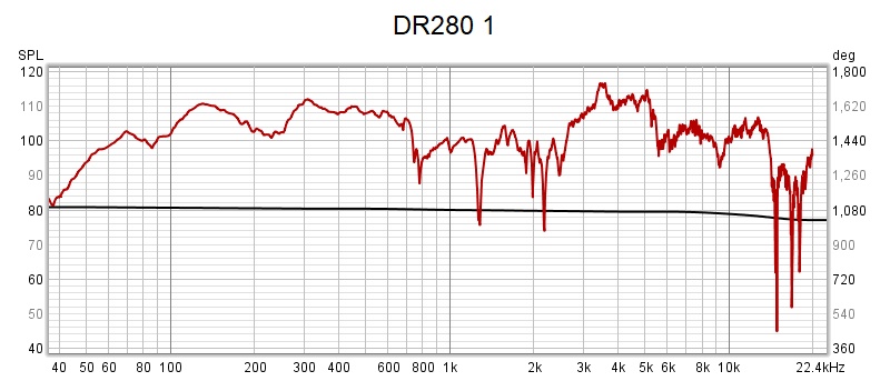

I did a thing..
Does that woofer look average to you? Also is the 3-6k peak something to diagnose?

It's an "FS" brand 400w woofer, melded array. Set up was mic and cab on speaker stands, l set the amp to 2.83v at 500hz, then hit measure on REW.
Posts: 29007
Re: Measuring cabs to create sensitivity reponse charts
#8 Post by Bill Fitzmaurice »
That's not how it's done. You take two measurements. The first is ground plane, the cab on the ground, the mic a few inches above the ground two meters away. This gives you the half-space result below the baffle step frequency; add 6dB to get the 1 meter result. The second is with the cab on its back facing up, the mic suspended two meters above it. This gives the half-space result above the baffle step. Superimpose the two charts, splice them where they intersect in the lower midrange. Use 1/6 octave smoothing, as you can't hear with better resolution than that, and it gets rid of the minor peaks and valleys that are of no consequence.
