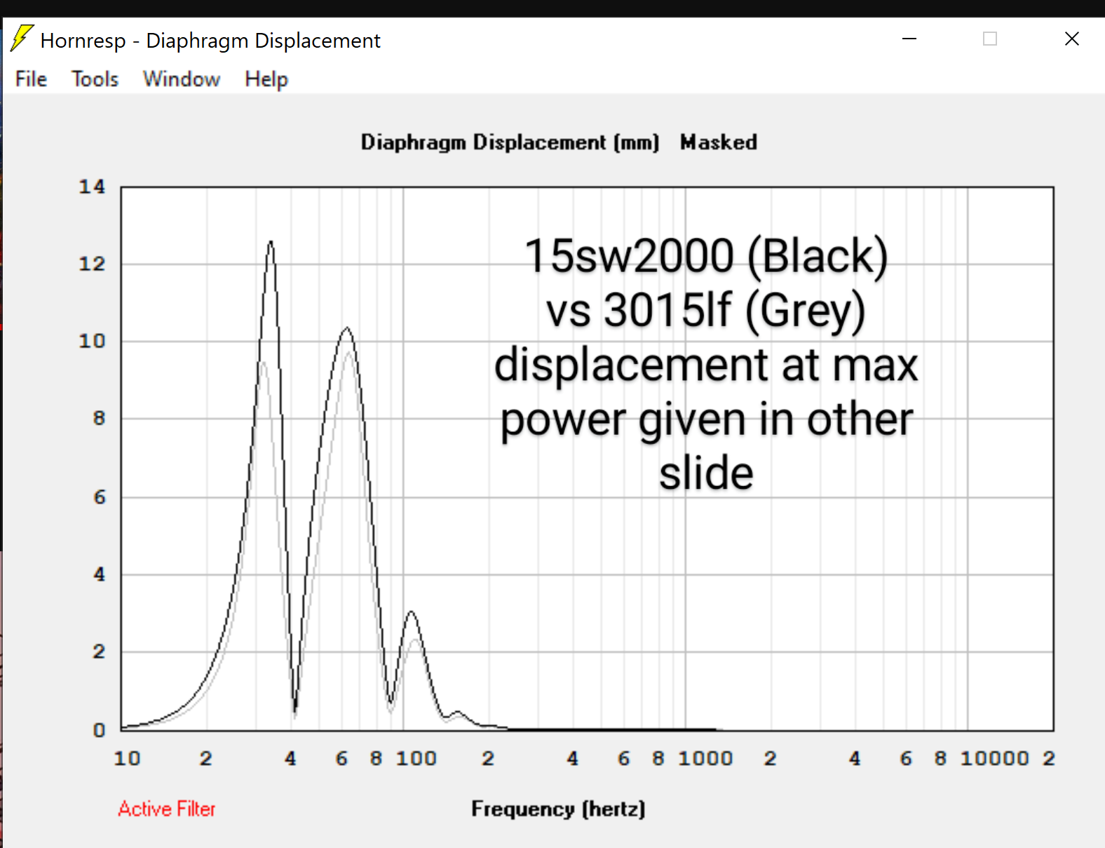

Hey y'all, I'm back. So as I mentioned in a previous post I've been simulating various different drivers in the t48 and I've found one in particular that stuck out to me. The PRV 15sw2000 is fairly new, within the last 5 years, it's 190usd and it's available all over the internet in the US. First party recone kits are readily available and shipping is surprisingly timely. I ordered one and it showed up about 3 days early so that was exciting. We dropped it in a freshly built t48 (no need for chamber reducers) and sent it to hell for about 20 minutes just to see if it could really stand up to the pressures in the throat before we go doing anything in the field. I am happy to report that after literally blowing the driver up, voice coil on fire and everything, this driver is a monster. The failure mode was entirely coil related, it bottomed out jumped the gap and lit on fire. We were DEFINITELY exceeding power rating significantly and the soft parts of the woofer were in great shape! Spider was totally fine, cone was intact and the surround looked great.

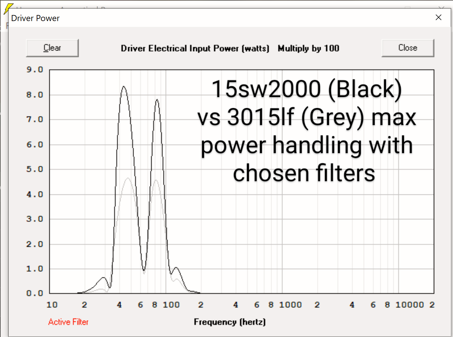

I used a high pass filter at 36hz 4th order butterworth because hornresp says it will take around 900wrms out of its 1000w rating with said filter. I might move that filter up 1hz but it's probably unnecessary. However we were producing some pretty insane spl before noting the voice coil bottoming out. Much beyond where we would set a limiter. It seriously sounded like there was more than one of them I was EXTREMELY impressed. Not only was it significantly louder than the 3015lf it performed better down below 50hz and the pronounced peak at 60hz after crossover filters with the kappalites did not exist with the 15sw2000. They sounded great without any sort of EQ where the 3015lf would have needed a fair bit of sculpting. I think this woofer is a great bargain! For the price I'm absolutely blown away. It digs just as deep, offers much more power handling and excursion than the 290$ 3015lf, and even if this cost significantly more I would be equally as impressed. I would argue that I actually think this woofer actually sounds better than the kappalite. I'm contemplating swapping some mine out.

So, Hornresp indicates 85v with 24dB/octave filter set to 36Hz keeps the linear excursion below 12.5mm throughout the whole pass band? Or, mostly so?

So according to hornresp, at 36hz 4th order butterworth the prv will take around 78v with a DC resistance of 5.5ohms which turns out to be around 850 watts, a little under that. This takes advantage of the full excursion of the driver. In my mind, even if you didn't take advantage of the full power handling, it exhibits much flatter response than the kappalites and just offers more energy at 40hz at a given voltage. When messing with the filter wizard and adding the usual filters the prv does not need EQ to be usable it's all well within 5db. The kappalite is about 9db down at 40hz from peak at 60hz. Also according to the simulations the group delay caused by mouth reflections is SIGNIFICANTLY reduced by using this driver. I'm not sure exactly why that is, but I do believe this contributed to my opinion that this driver sounds better than the kappalites. At least cab for cab. Ive attached some hornresp charts using 4th order Butterworth at 36hz and 100hz on the prv and 38hz/100hz on the kappalite. The difference in low frequency output is not insignificant. It's not just louder at 40hz it's also more sensitive there. I think it's worth noting that both of these drivers have a DC resistance of 5.5 ohms.

Wylandright206 wrote: ↑Sat Nov 25, 2023 2:54 pm So according to hornresp, at 36hz 4th order butterworth the prv will take around 78v with a DC resistance of 5.5ohms which turns out to be around 850 watts, a little under that.
78v at 5.5Ω DCR is 1106 Wats. But, 78v and 850 Watts equates to roughly 7.2Ω impedance, which is what I assume your numbers are coming from. However, power isn't really important as long as it doesn't exceed the drivers thermal rating. Other than choosing an appropriate amplifier, Watts/power has little to no importance within this particular conversation... unless I'm overlooking something(?), which is entirely possible.
It took me years to let go of thinking the power rating of a driver meant it was louder, somehow better than a driver with a lower power rating, or that if I didn't power it with at least that much "power" I was leaving performance on the table. Fact is, I'd personally be happy if a driver reached it's peak potential at a voltage that equates to any amount of power based on nominal impedance that's less than the driver's RMS rating... even half. Power and power ratings have nearly zero importance once it's verified the thermal rating of the driver isn't the limiting factor for setting the limiter. There are instances, but it's outside the scope of how we do things here....This (voltage) takes advantage of the full excursion of the driver. In my mind, even if you didn't take advantage of the full power handling, it exhibits much flatter response than the kappalites and just offers more energy at 40hz at a given voltage.
Looking at the charts, if the actual performance holds mostly true to the model, I'd say the increase in sensitivity in the 35-40Hz region is a huge benefit to the overall peak output level of the whole system. Like, considerably so. So much so, I'd personally choose this driver as a default recommendation for the T48 and only recommend the 3015LF for people who need the weight savings. Although, the weight savings of a 3015LF would come at a huge hit in output potential. Would be tough to steer anyone that direction... if the differences indicated in the model hold true and accurate.When messing with the filter wizard and adding the usual filters the prv does not need EQ to be usable it's all well within 5db. The kappalite is about 9db down at 40hz from peak at 60hz. Also according to the simulations the group delay caused by mouth reflections is SIGNIFICANTLY reduced by using this driver. I'm not sure exactly why that is, but I do believe this contributed to my opinion that this driver sounds better than the kappalites. At least cab for cab. Ive attached some hornresp charts using 4th order Butterworth at 36hz and 100hz on the prv and 38hz/100hz on the kappalite. The difference in low frequency output is not insignificant. It's not just louder at 40hz it's also more sensitive there. I think it's worth noting that both of these drivers have a DC resistance of 5.5 ohms.

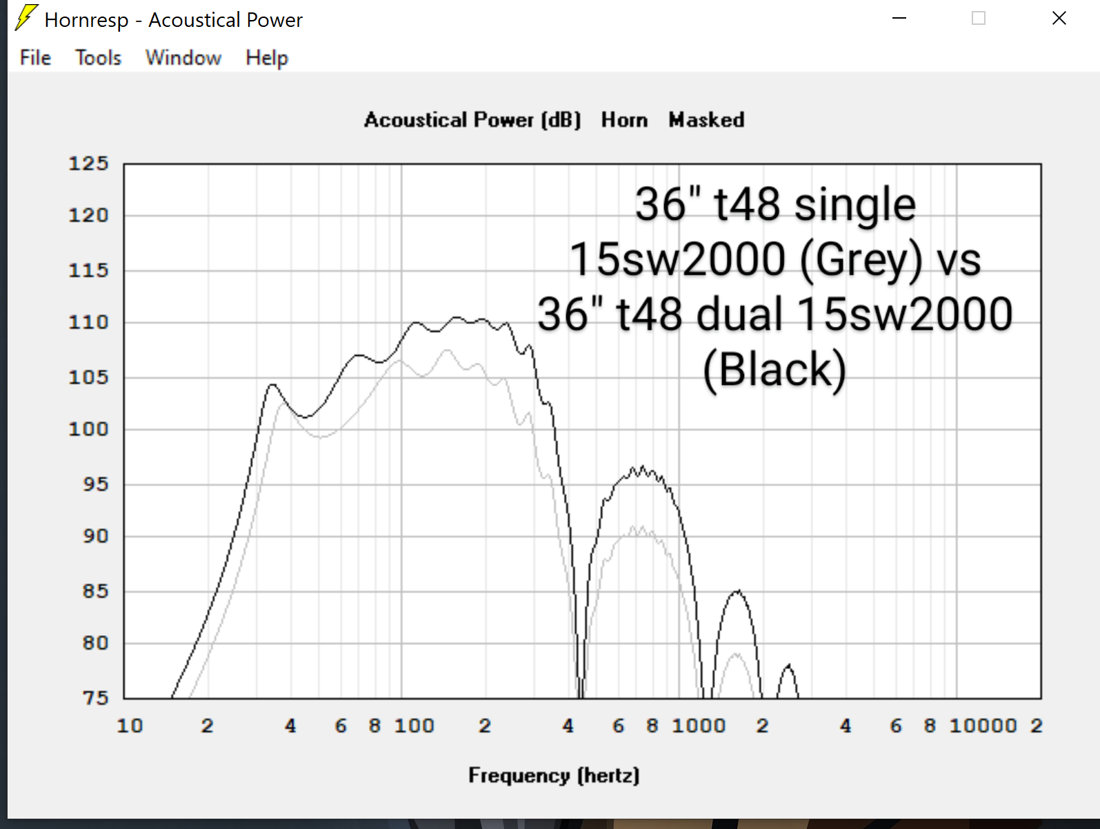

There's something odd to the two graphs around 40-45hz.
With ONE 3015, the 36" T-48 makes about 99dB.
With TWO 3015s, it makes... about 99dB.
Should we check on the public works dept in Denmark? #somethingisrotten

Link, add to post, or describe which graph you're talking about please. It's probably staring me in the face, but for some reason it's not obvious to me which graph you're talking about.
However, I will say the cab (width) does the work. A dual loaded cab acts like two cabs of half the width and the natural occurring benefits of having a wider cab are greatly diminished.

Oh, I see what you're talking about... the single loaded trace from the top chart and the dual loaded trace from the bottom chart. You're right, that little dip right there is very similar on both traces.

Here are some comparison sims of single versus dual loaded 36 inchers with the two drivers. The single prv loaded one looks very similar to the lavoce waf154.00 and b&c 15tbw100 (significantly more expensive drivers I might add) in sims now that it has such a large rear chamber. Once you add a second driver you gain extension and output. But not at 40hz, same with the kappalites. Im not sure what's going on here since I just noticed this phenomenon as well, but my thought was that the two drivers sharing a chamber acting on each other was having a significant effect on their total compliance, which is what would lead the response to change pretty significantly. This effect can be seen when simulating all enclosure types with multiple drivers. Some drivers are not meant to share a chamber. You see lots of commercial bass bins that are just two single 18s stuck together. I would be happy to be proven wrong I just thought I would share my theory as to why the response is so different. Now the fact that 40hz doesn't gain benefit from either driver could be a coincidence or it could be something beyond my current scope of understanding. It sounds like Seth has had these thoughts before.

I have. And here's the conclusion I came to, which is the same as Bill has said forever... the only time dual loading a cab is desirable and appropriate is when you need to manipulate the final impedance of the cab. Otherwise, single loaded cabs, built as wide as you can transport are, hands down and by far, the optimum way to go.
I'm sure I'm not the only one who's mind keeps trying to figure out the best configuration and how to get the most output from a cab. Adding a second driver was my first impulse. And it makes sense. More is better, right? Arguably, yes. But, doubling the driver count is not the same as doubling the cab count.
If a guy has the ability to transport a 36" dual loaded T48, 99 times out of 100 he would also have the ability to transport 2 single loaded 24" T48's. Two single loaded cabs of half the width of a double loaded cab will match the performance potential. And two single loaded cabs of any width that is wider than half that of a dual loaded cab will outperform the dual loaded cabs performance potential.
So, unless we need to manipulate the impedance of a cab, which is nearly never the case, there is absolutely no reason whatsoever to even consider or speculate dual loaded cabs. That said, it seems to be one of those things that's like trying to not look at a naked lady or an automobile accident on the highway.
