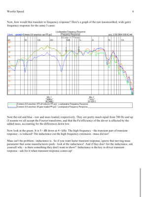

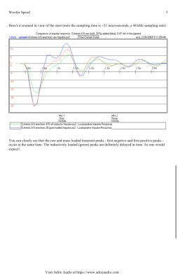

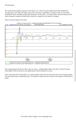

I saw this old post and was curious in relation to this white paper from Dan. I know it seems like he kind of fell off the grid, but think he was somewhat ‘known’ around here.
Are the subwoofer specs mentioned in the paper relatively moot because of the effects of the horn itself or ?
