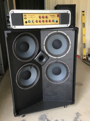

I decided to get a bass rig.
I’ve had 4 x BP102 8’s for ages, gathering dust. I had thought to use them in a pair of dual loaded 28” T39’s, but changed my mind.
Went searching, found a cab that recommends BP’s as suitable drivers.
I got the download, a scetchup file from Leland, and that’s what you build from.
A big thanks to Bill, what I’ve learnt from building his designs was invaluable in this build!
I decided to add HF with a piezo. It might have been a mistake ( very in your face ), so if I can find the same size horn with a screw thread, I might change to a compression driver I have sitting around.
I don’t have enough grill material left, I’ve got a sheet on order, though that may take a while to turn up.
The WT400 David Eden head is a cracker, I got it for a pretty reasonable price. Valve ( pre amp ) looks to be in good order, will get some spares though.

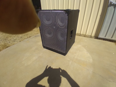

All in all, enjoyable, quick, and with the angled baffles to reduce comb filtering, sounds not to bad to this drummers ears...

The only issue with that configuration for bass is that it results in less internal volume, which reduces low end sensitivity. That's not a problem with guitar cabs, as they don't need low end sensitivity.
Re: Off reservation, Duke Lejeune 4 x 10 build.
Great point. Does porting change that?Bill Fitzmaurice wrote: ↑Sun May 22, 2022 8:59 pm The only issue with that configuration for bass is that it results in less internal volume, which reduces low end sensitivity. That's not a problem with guitar cabs, as they don't need low end sensitivity.

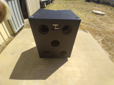

It is ported, 5 of them on the back.
Here's the expected response from the ported cab:
8 ohm BP102: +3.8 dB @ 82 Hz and -0.2 dB @ 62 Hz (upper bass +3.8 dB @ 100 Hz)
The sealed cab specs are certainly lower...

Porting doesn't allow the internal volume to be smaller. The ideal volume for the BP102 in a ported box is 4.2 cu ft net, per driver, although 1.5 cu ft per driver can work reasonably well, albeit a bit boomy.
Thanks, we'll see how it goes.Bill Fitzmaurice wrote: ↑Mon May 23, 2022 11:12 am Porting doesn't allow the internal volume to be smaller. The ideal volume for the BP102 in a ported box is 4.2 cu ft net, per driver, although 1.5 cu ft per driver can work reasonably well, albeit a bit boomy.

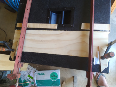

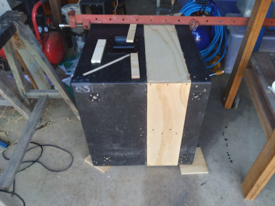

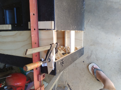

Taking on board what Bill said in this thread earlier;
I decided to revise this build some.
I added 7" in depth to the cab.
That takes the cab to an internal volume of roughly 7.5 cubic feet, or 1.8 to 1.9 cubic feet/driver.
Adding 7 inches added 2.7 cubic feet, so as it was it was not even 1.5 cubic feet/driver.
It's not ideal, it's a compromise based on ply on hand, portability, weight, overall size etc.
I always find it nerve wracking enough to mod cabs, but it was already top and front heavy, so I didn't think I could go up in height as well.
I'm hoping the casters will still let the cab go up my truck ramp!
I also changed the piezo to a compression driver with a 2K filter.
I thought it was to much to move the handles and new/more bracing prevented that anyway.
Adding the depth added some stability to the cab in terms of the front/top heavy aspect.
Bass players playing the pre modded cab said it was fine (but not brilliant or crap), so we'll see.
Chopped and adding in 7 inches: And finished, with grille: ^Excuse the finger, it was very sunny and I was struggling to see the phone screen.
Thanks for looking...
