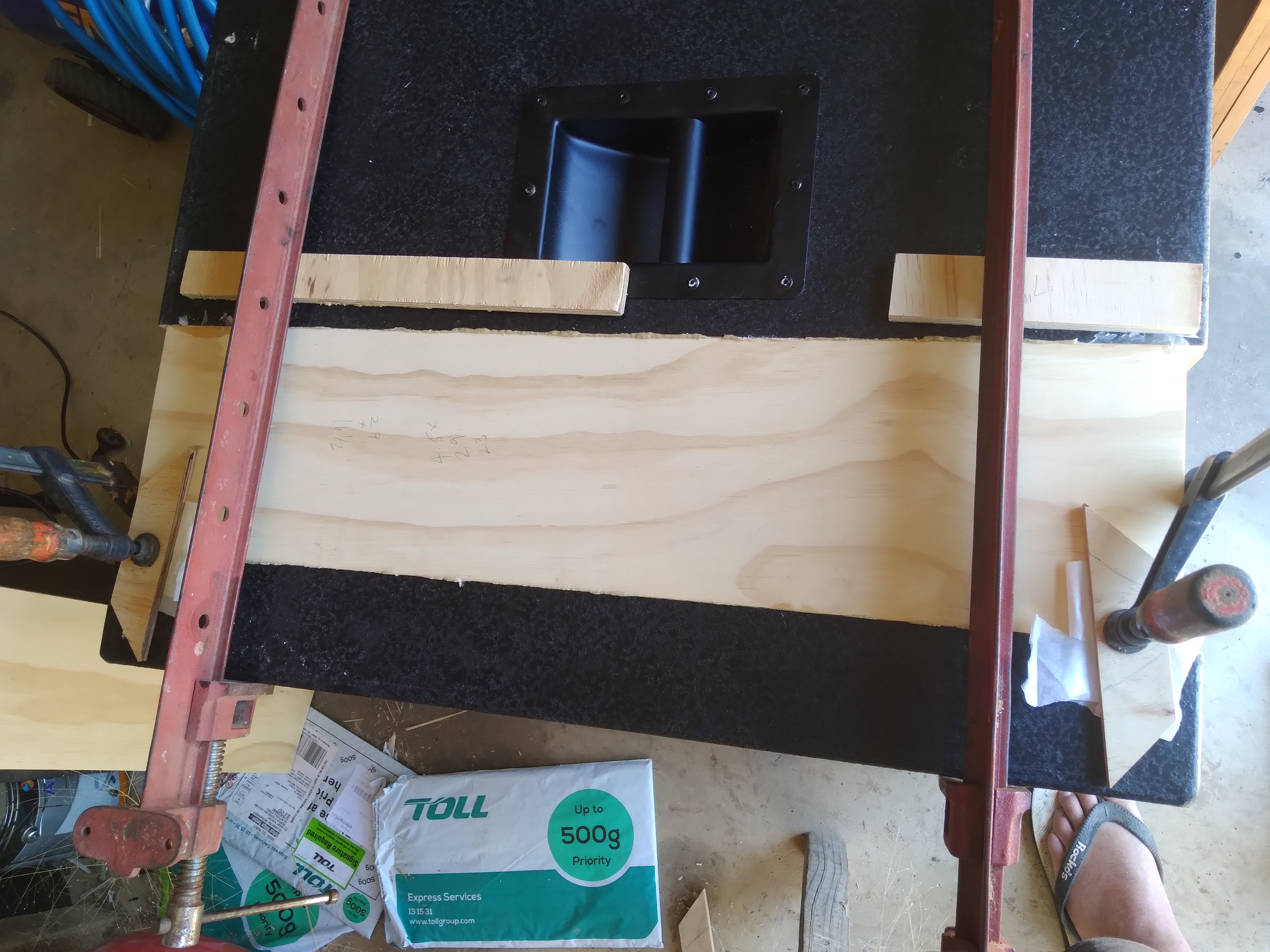

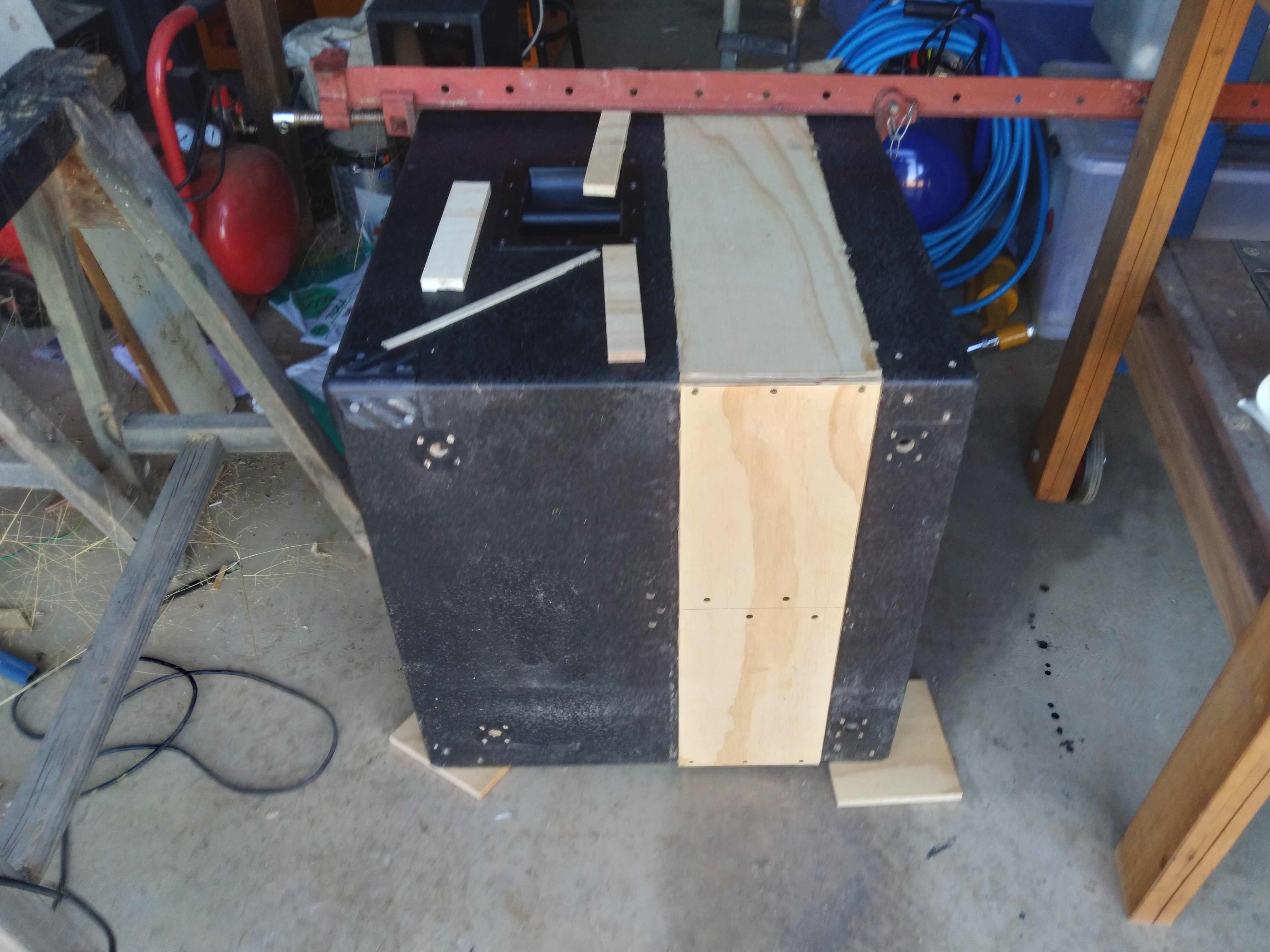

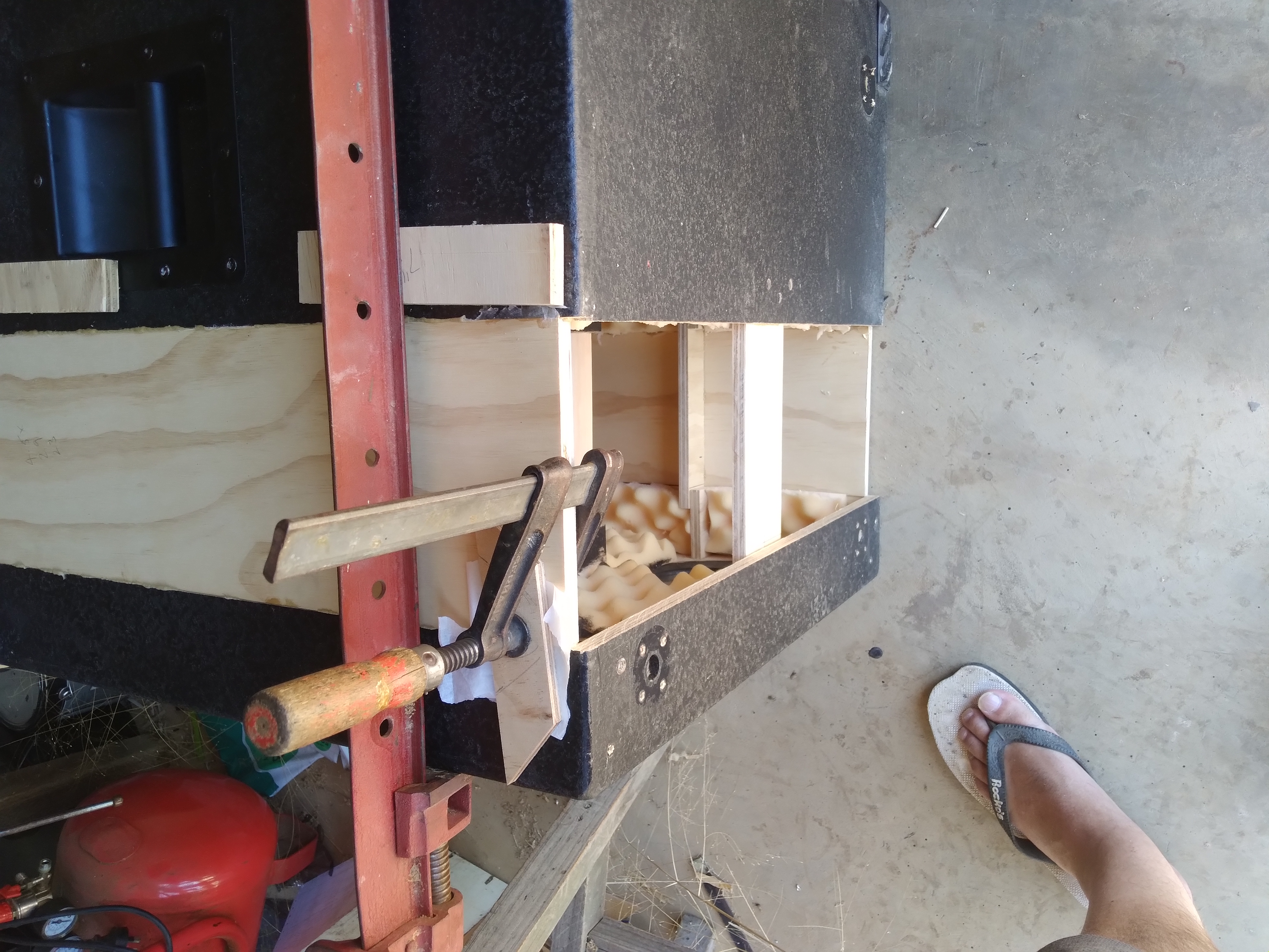

Taking on board what Bill said in this thread earlier;
I decided to revise this build some.
I added 7" in depth to the cab.
That takes the cab to an internal volume of roughly 7.5 cubic feet, or 1.8 to 1.9 cubic feet/driver.
Adding 7 inches added 2.7 cubic feet, so as it was it was not even 1.5 cubic feet/driver.
It's not ideal, it's a compromise based on ply on hand, portability, weight, overall size etc.
I always find it nerve wracking enough to mod cabs, but it was already top and front heavy, so I didn't think I could go up in height as well.
I'm hoping the casters will still let the cab go up my truck ramp!
I also changed the piezo to a compression driver with a 2K filter.
I thought it was to much to move the handles and new/more bracing prevented that anyway.
Adding the depth added some stability to the cab in terms of the front/top heavy aspect.
Bass players playing the pre modded cab said it was fine (but not brilliant or crap), so we'll see.
Chopped and adding in 7 inches:

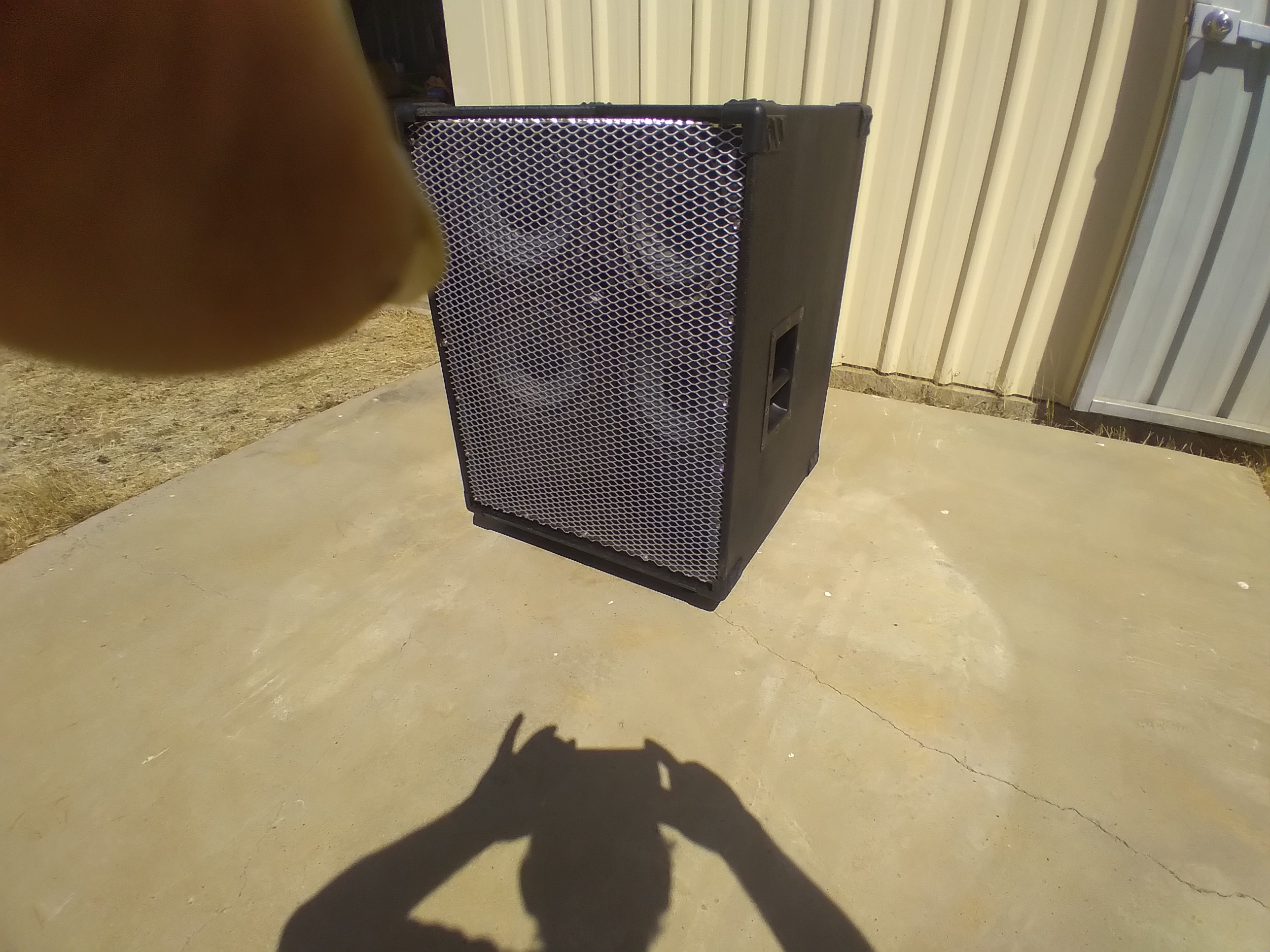

And finished, with grille:
^Excuse the finger, it was very sunny and I was struggling to see the phone screen.
Thanks for looking...
