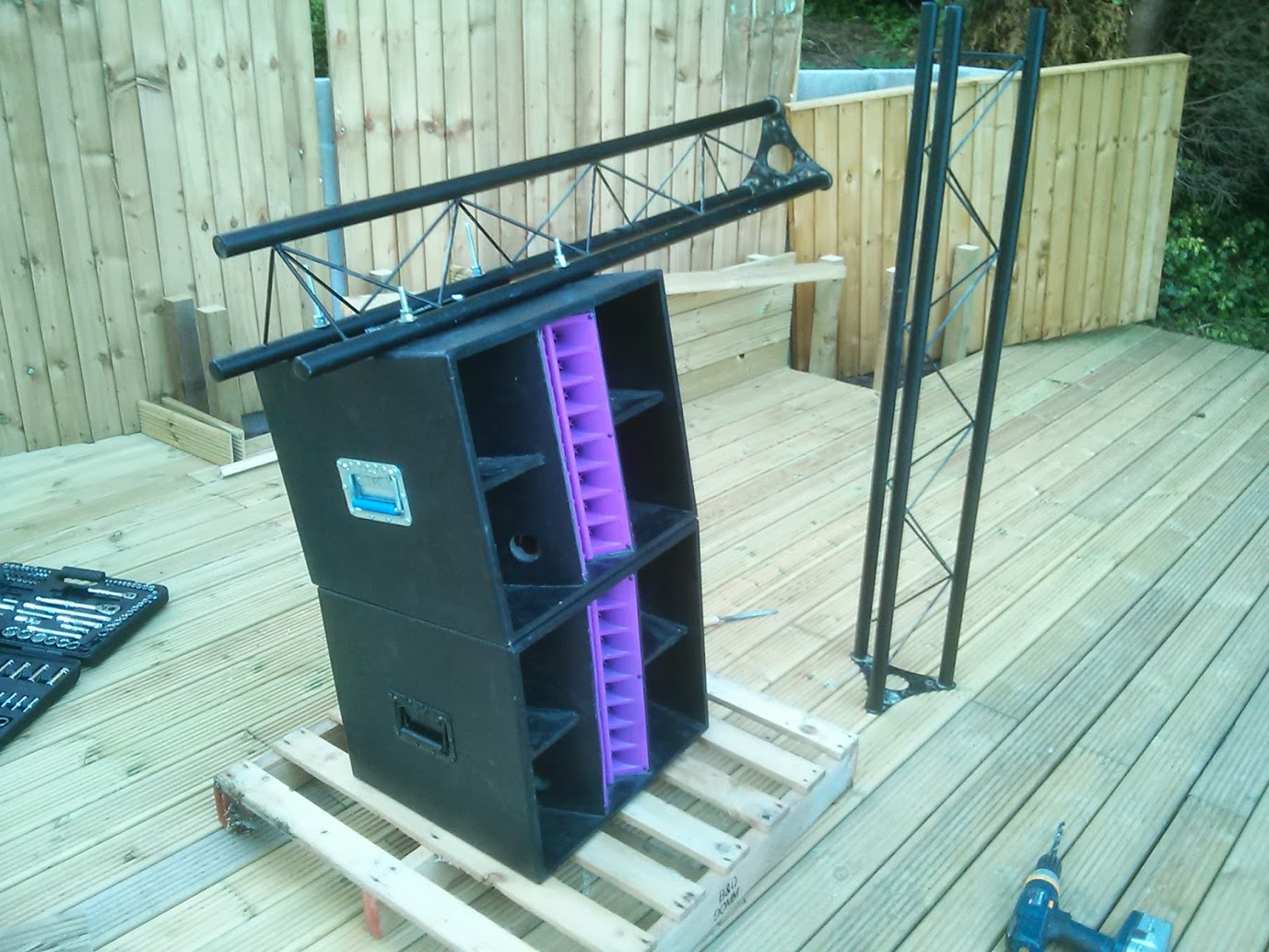

I 'flew' my DR200s by putting steel threaded bars through the cabs, essentially stacking them on the steel plates with a welded nut. I doubled with a locking nut underneath when I used them.

That's the right way to do it. Have the weight supported by steel, not by wood.
