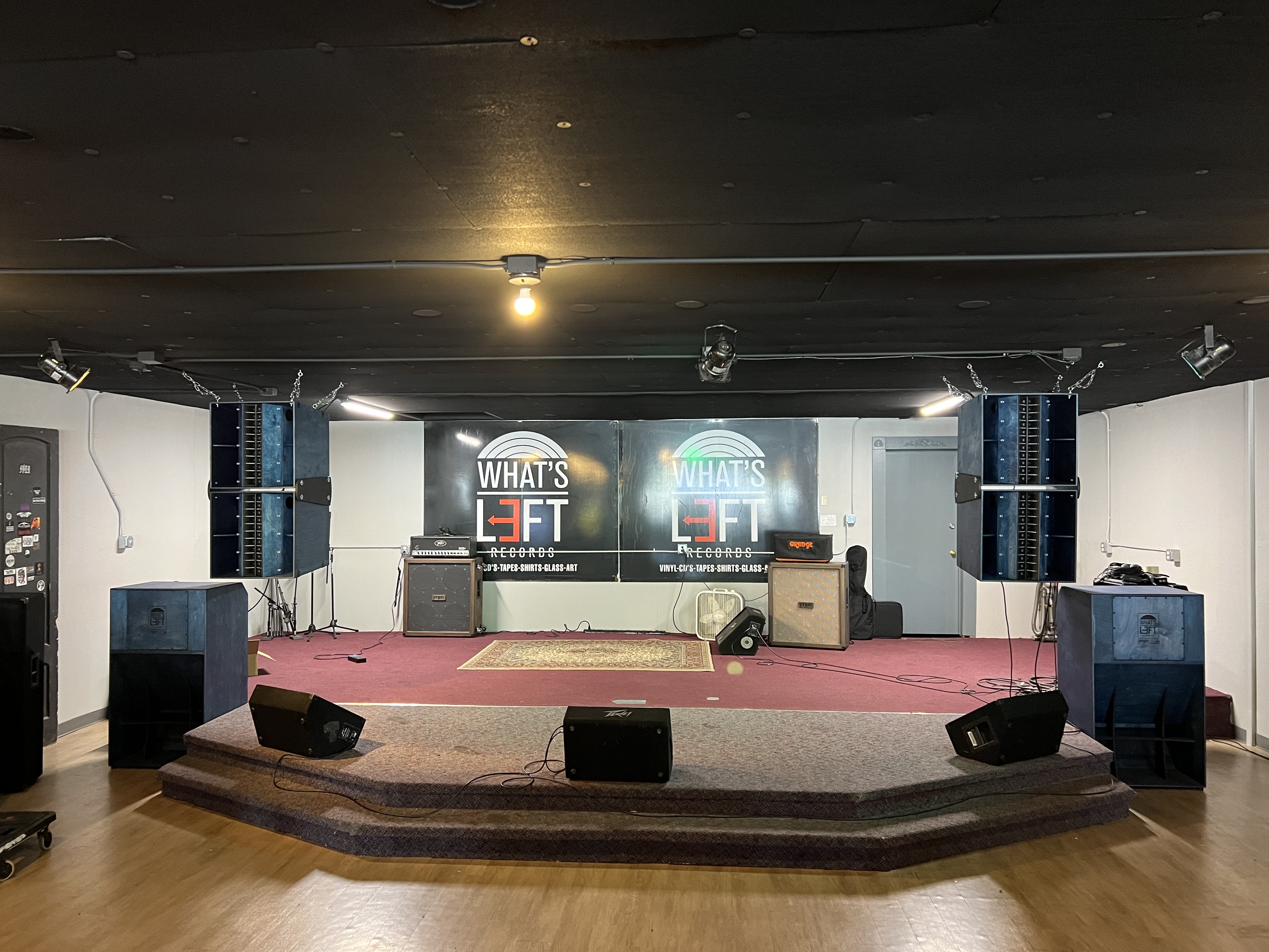

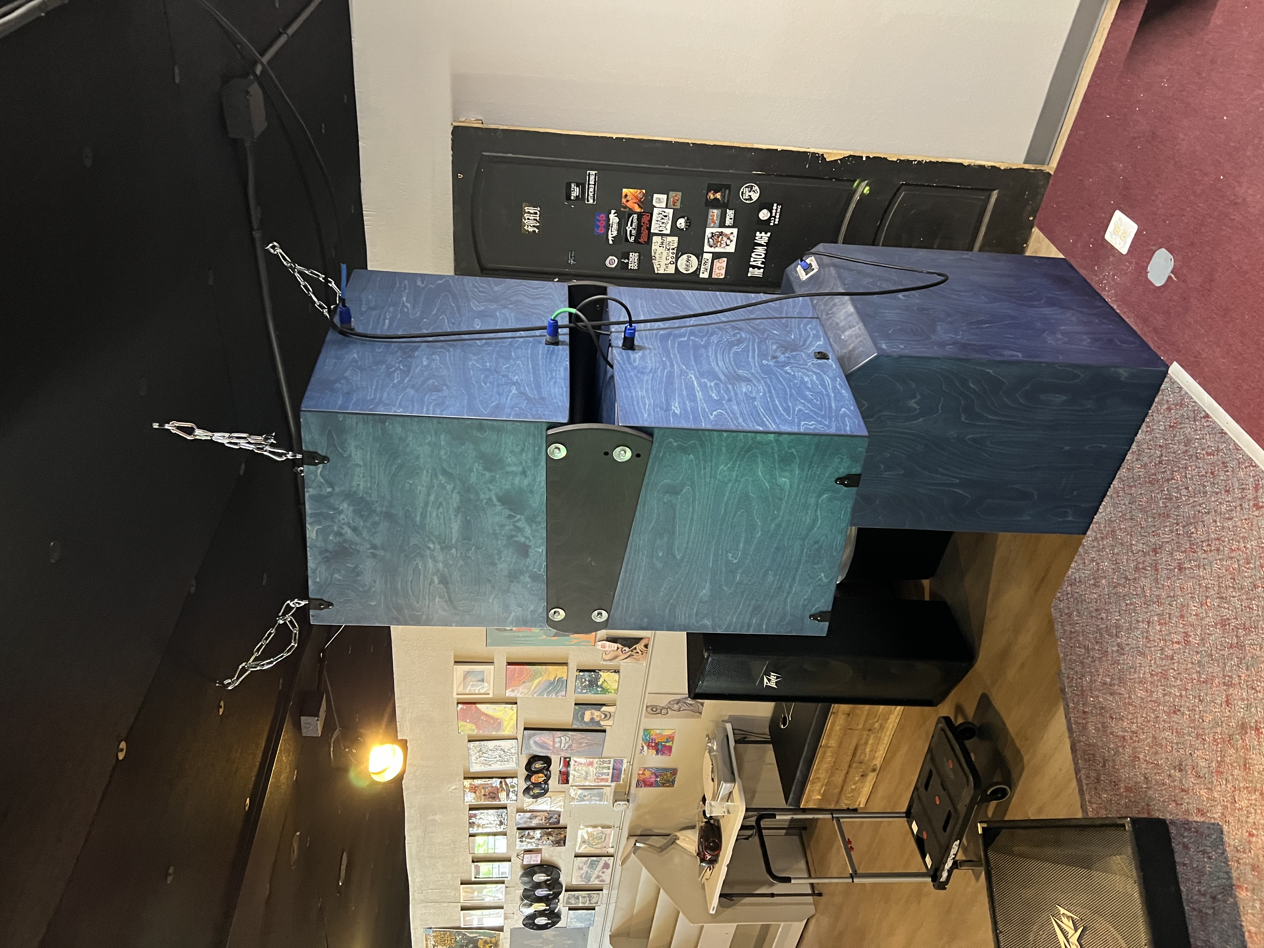

Greetings! First time posting, but I got a ton of answers checking out previous threads on the forum! Thanks everybody! And thanks Bill for designing some awesome speakers! I build guitar and bass speakers for a living, but when asked to build some PA cabs for my good buddies at What’s Left Records here in Colorado Springs, I figured going with some BFM cabs would be the way to go with everything I’ve heard about them. We weren’t disappointed! These are a perfect match for a record store that has super loud shows as well! Hi fidelity enough for playing records and sound amazing with live music! I know our sub placement isn’t best, but it’s what we could do with the room. Anyway, cheers and I hope y’all like our style on these amazing BFMs!

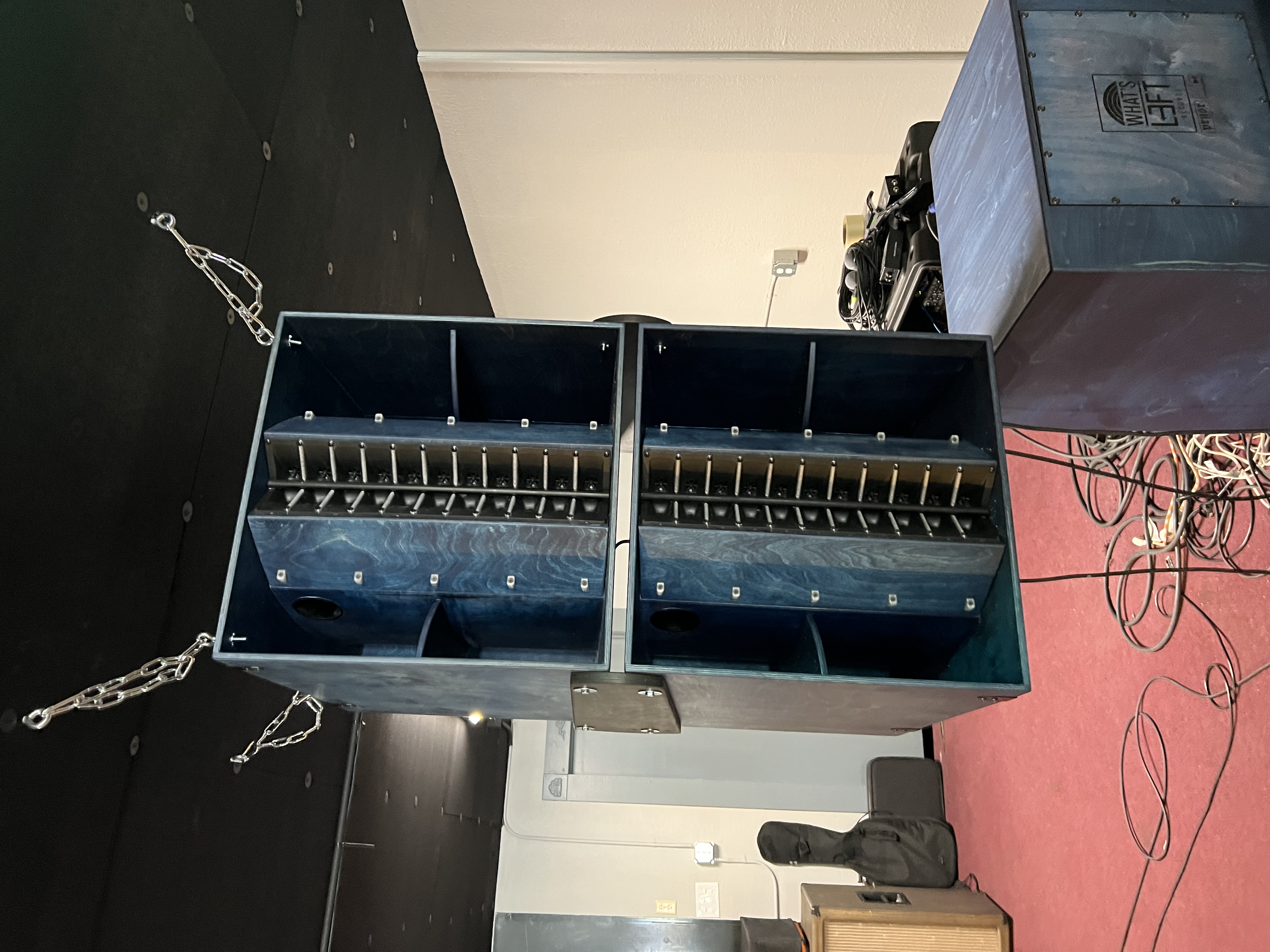

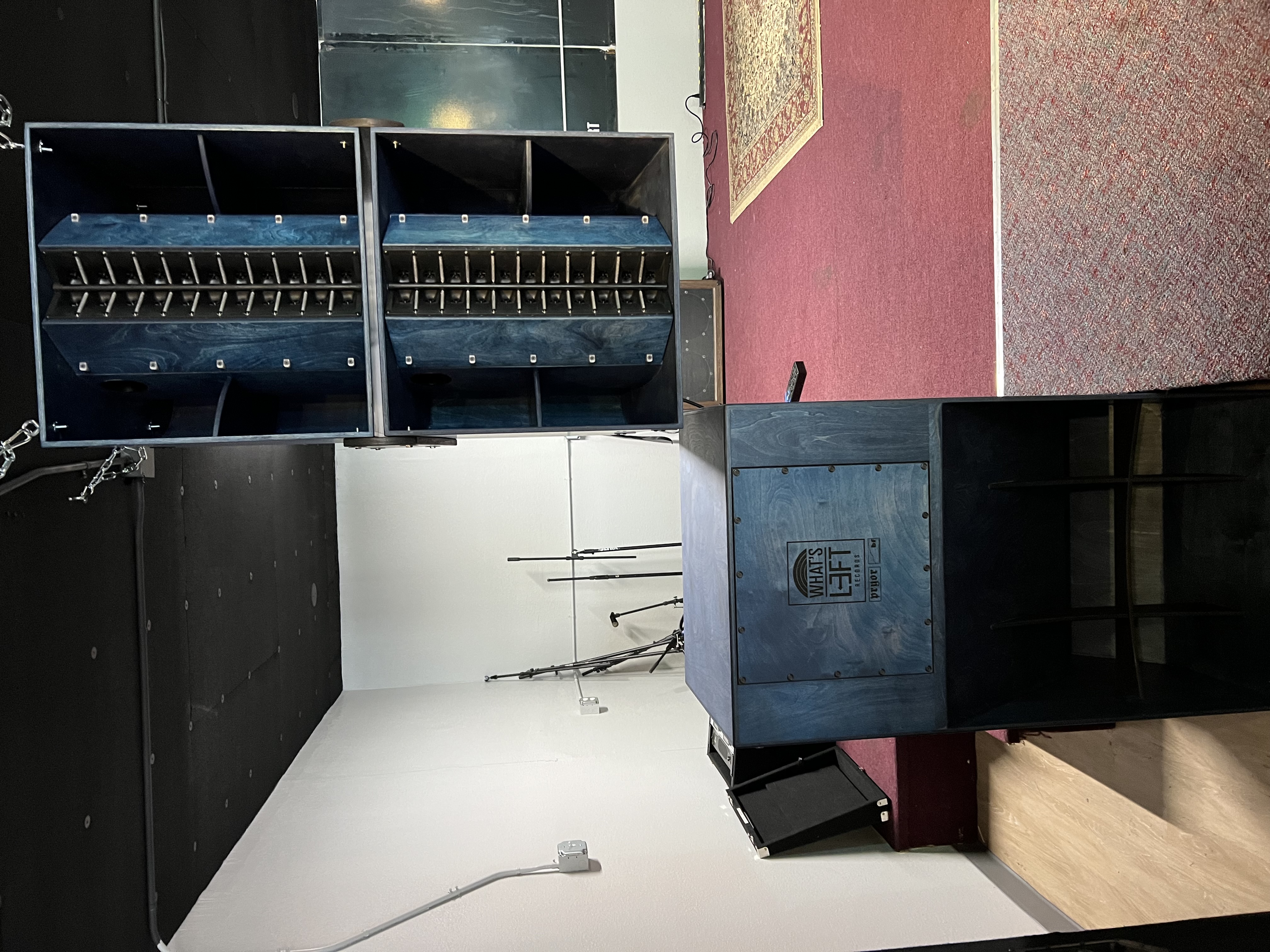

I'm totally cringing about the flying of the cabs.
It is not the way to do it.
Unfortunately, that overshadows what otherwise looks like an excellent build to me...

Agreed.Grant Bunter wrote: ↑Mon Oct 02, 2023 1:45 am I'm totally cringing about the flying of the cabs.
Re: 4 DR280 and 2 titan48 for a record store/venue!!!

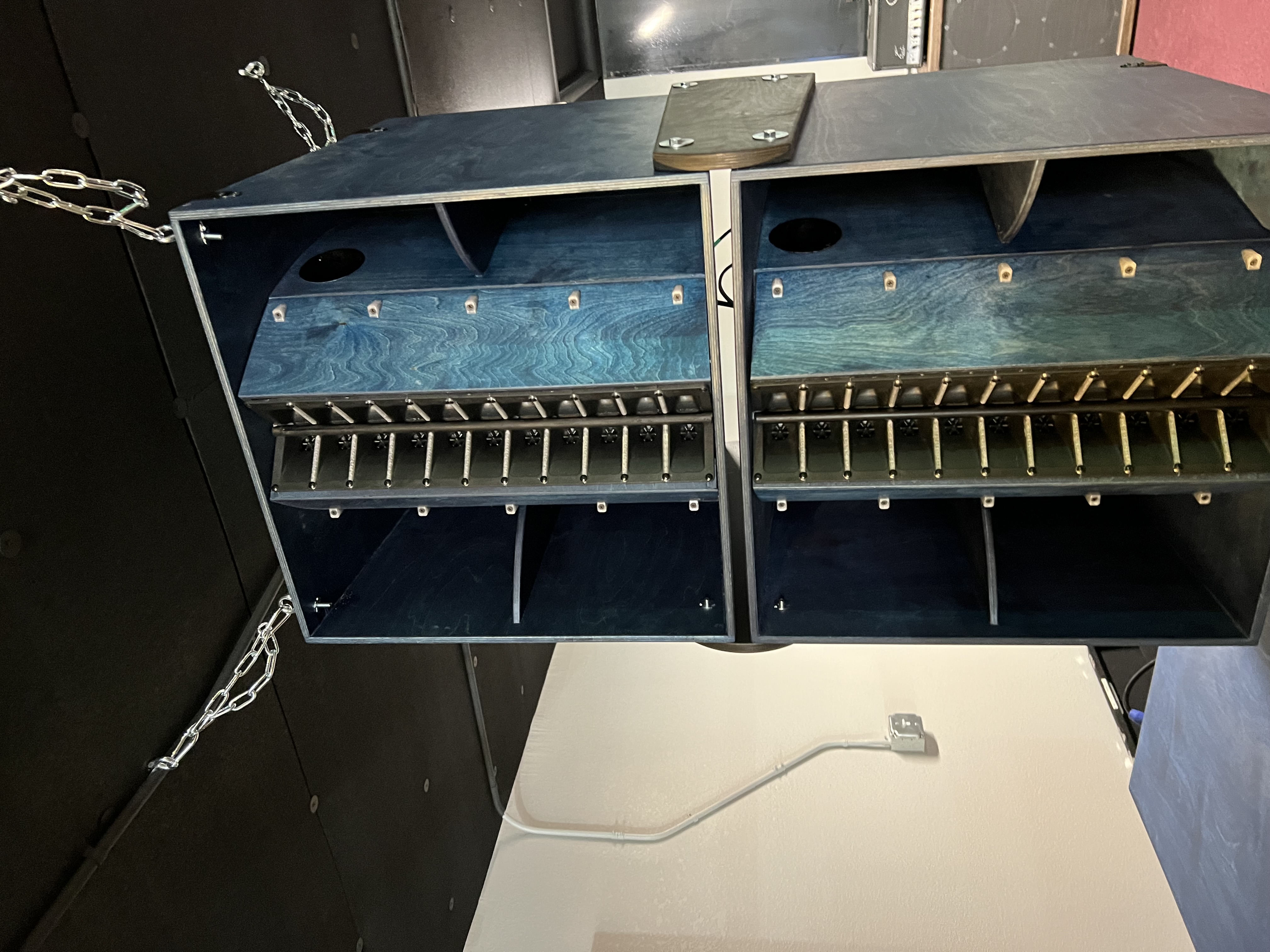

I'm glad I wasn't the first or only one to think so. At those chain angles, each chain is supporting nearly the full weight of the cabs, not 1/4.Grant Bunter wrote: ↑Mon Oct 02, 2023 1:45 am I'm totally cringing about the flying of the cabs.
Was this install designed by an engineer?
https://en.wikipedia.org/wiki/American_death_triangle
- Posts: 29004
The only engineer that matters in this case is me. The DRs aren't designed to handle the weight of being hung. To safely hang them requires an external rigging that puts the load on the rigging, not the cabs.

Just stack them on the subs, won't lose much height in the process.

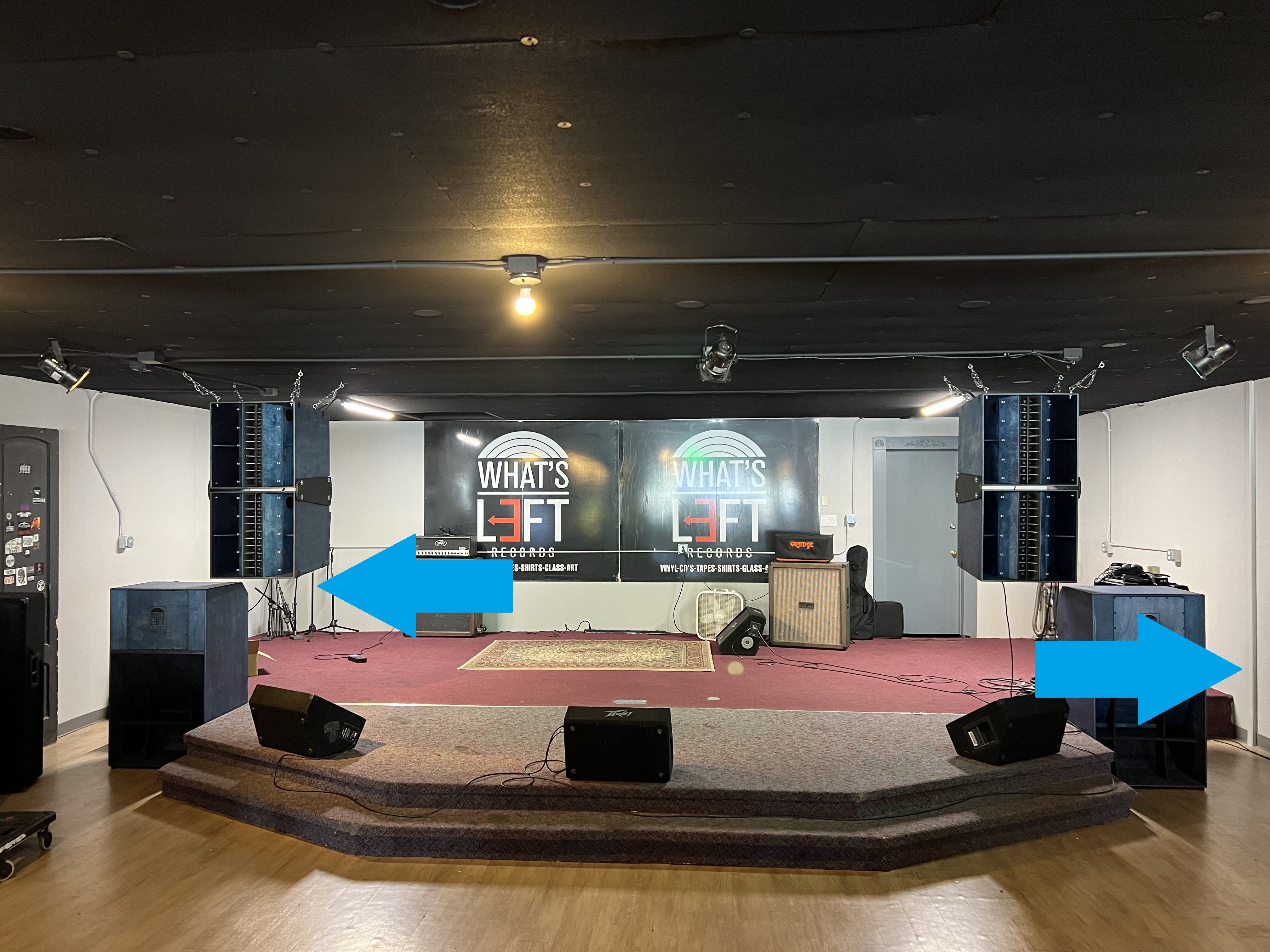

Blasphemy. The sub placement as it stands is poor. They should be spread wider, and pushed back further, making them tight to the side walls and as close as possible to the rear wall. The only time mains should be stacked above subs is when there are no boundaries, which means outdoors.
Absolutely, but OP already states they are compromising on sub positioning.Bill Fitzmaurice wrote: ↑Tue Oct 03, 2023 6:55 amBlasphemy. The sub placement as it stands is poor. They should be spread wider, and pushed back further, making them tight to the side walls and as close as possible to the rear wall. The only time mains should be stacked above subs is when there are no boundaries, which means outdoors.
Given only two options, I'd like see a PA deployed safely but wrong, rather than unsafely AND wrong.

I'm sorry the thread has been mostly critical up to this point. However, it's not without reason. It's a good thing that they're low enough that no one can walk under them. Personally, if it were me, I would have squares of angle iron welded up that the bottom speaker can sit on and register into, and run 4 pieces of all-thread straight up to the ceiling into some steel 1x1 that bridges the gap between the ceilings joists. That way, the design and integrity of the speaker cab isn't responsible for any hanging load whatsoever. The cabs will be supported from below, as they were designed to be used. Plus, the angle iron, all-thread, and 1x1 can be painted to blend in more with the rest of the install. That said, ultimately, if the cabs end up falling or otherwise injuring someone due to the installation method (any installation method), the companies insurance will likely not assume liability unless the installation method has been signed off by an appropriate civil engineer. Not a huge big deal, but a possible medical and legal nightmare if there's ever an issue.
If the bass response is even enough throughout the room and the customer/venue is happy enough with the sub's arranged as is, great! However, it does appear there are placement options available that may provide an increase in performance. Again, without seeing the entire layout of the room, it's difficult to say... but, from what I can see, there are two placement options I would recommend you/the venue try out and see if there are improvements.
Option 1, both subs together, v-plated would be best but would eat up a lot of stage floor space, so vertically stacked if there's enough vertical space to save stage floorspace, side by side if need be... aimed and firing into the back corner where the mic stands are in the photos. Option 2, both subs stacked vertically and wall loaded at an angle on the wall to the right or if there's room on the wall, side-by-side as shown below.
If the room is essentially twice as long as the width we can see, you may find that one sub in the corner mentioned and another kitty-corner in the back of the room may provide the best response throughout the room.
Since it's a permanent install, I think it's worth taking the time to test as many placement options as possible in order to identify the best possible response in the room. When it's good, it's really good. Like, knock your socks off, good.

Wow! Looks clean! The only room for improvement is safely flying those things. Everything looks great! I will share with my friends in CS so they can maybe come check out your space. Bravo.

Thank you Seth for all this great advice! We will be implementing everything suggested that we can as soon as we can. I don't want anyone getting hurt or the speakers themselves getting damaged.Seth wrote: ↑Tue Oct 03, 2023 6:57 pm Hey Prior, welcome to the forum and thank you for sharing your success.
Option 1, both subs together, v-plated would be best but would eat up a lot of stage floor space, so vertically stacked if there's enough vertical space to save stage floorspace, side by side if need be... aimed and firing into the back corner where the mic stands are in the photos.IMG_2929.jpeg

I have to say that I opened the thread with a great deal of embarrassment so the helpful tips are most appreciated. I did think about the fact that the cabs are designed in such a way that hanging them just from the top board of the top cab isn't going to work on its own, so we added a bunch of screws from the side boards along with the metal brackets transferring a lot of the load to the sides to compensate. It seems to have worked out fine so far, but we will be thinking about different ways of how to beef that aspect up more for sure. First of all we will fix the "death triangle" rigging and go from there with some angle iron on the ceiling from joist to joist and hang the chains as vertical as possible. Again, this is our first PA build and install so please forgive our ignorance on the rigging.
We will definitely try some other placements on the subs to get the best results. I will also be doing sound down there as well so I'll have a lot of time to mess with them.

I'll put my hand up being the first to bring up the rigging. I will never apologise for doing so. No one ever needs to go out either as a player or a musician and be injured as a result.Pryor wrote: ↑Wed Oct 04, 2023 11:59 am I did think about the fact that the cabs are designed in such a way that hanging them just from the top board of the top cab isn't going to work on its own, so we added a bunch of screws from the side boards along with the metal brackets transferring a lot of the load to the sides to compensate. It seems to have worked out fine so far, but we will be thinking about different ways of how to beef that aspect up more for sure. First of all we will fix the "death triangle" rigging and go from there with some angle iron on the ceiling from joist to joist and hang the chains as vertical as possible. Again, this is our first PA build and install so please forgive our ignorance on the rigging.
There's been far to much of it around the world over time.
I see you get that, and that's great.
I suggest you get the shop owner to engage an engineer (structural) so it can be signed off.
The engineer will look at the rafters and see if the cabs and the flying load can be managed. They will tell you if angle iron is ok. They may also say that the load needs to be on slings and shackles rather than chain.
Yes it costs money, but signed off rigging is on their head, and no one elses.
Just to make sure it is totally clear to you, no metal should be in the cabs at all for any part of the rigging.
Bill says, in effect, that DR series cabs if flown, must be wholly enclosed in a flown frame that supports the cabs in total.
In other words, the frame is flown on the chains or slings, and the cabs sit in that frame.

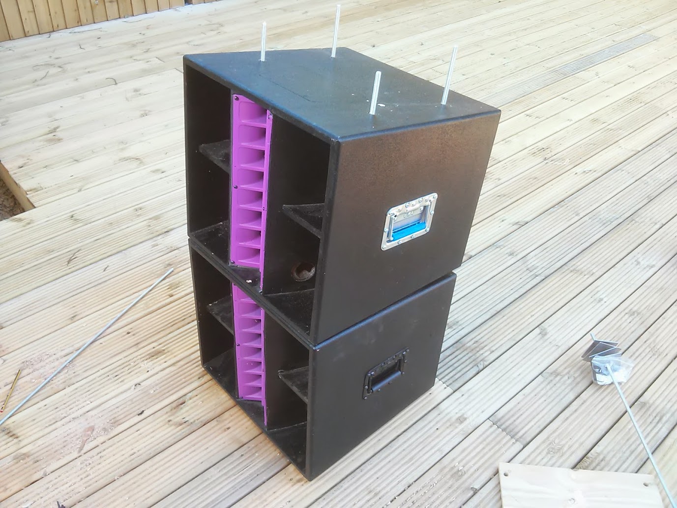

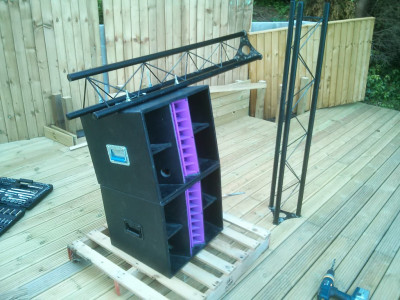

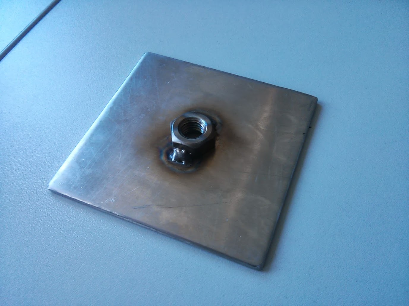

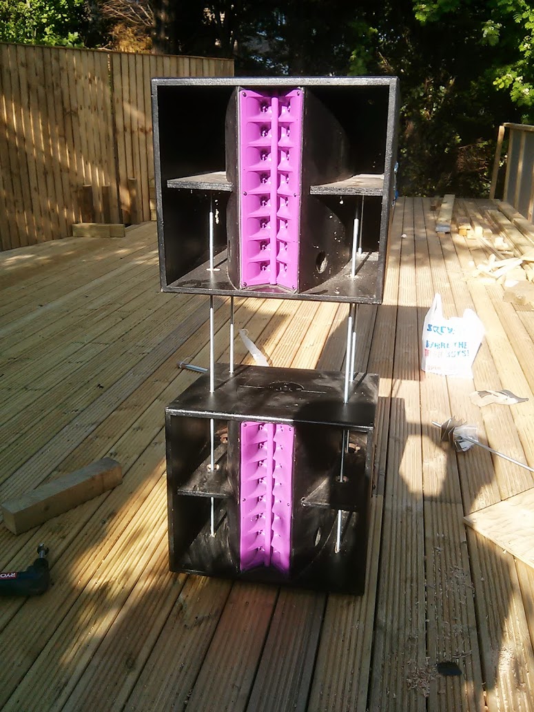

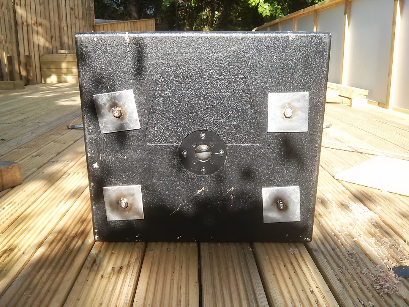

I 'flew' my DR200s by putting steel threaded bars through the cabs, essentially stacking them on the steel plates with a welded nut. I doubled with a locking nut underneath when I used them.
- Posts: 29004
That's the right way to do it. Have the weight supported by steel, not by wood.
