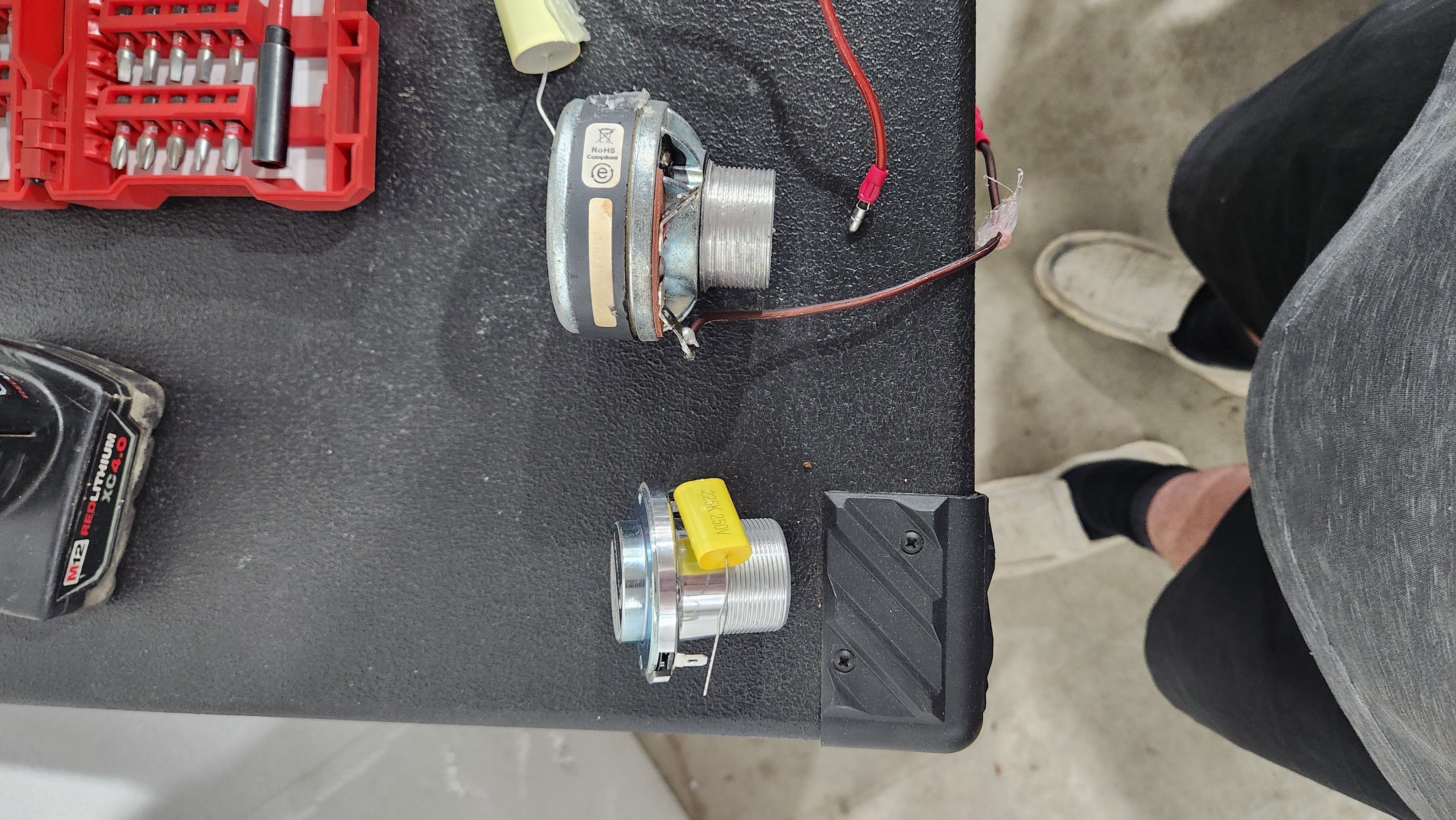

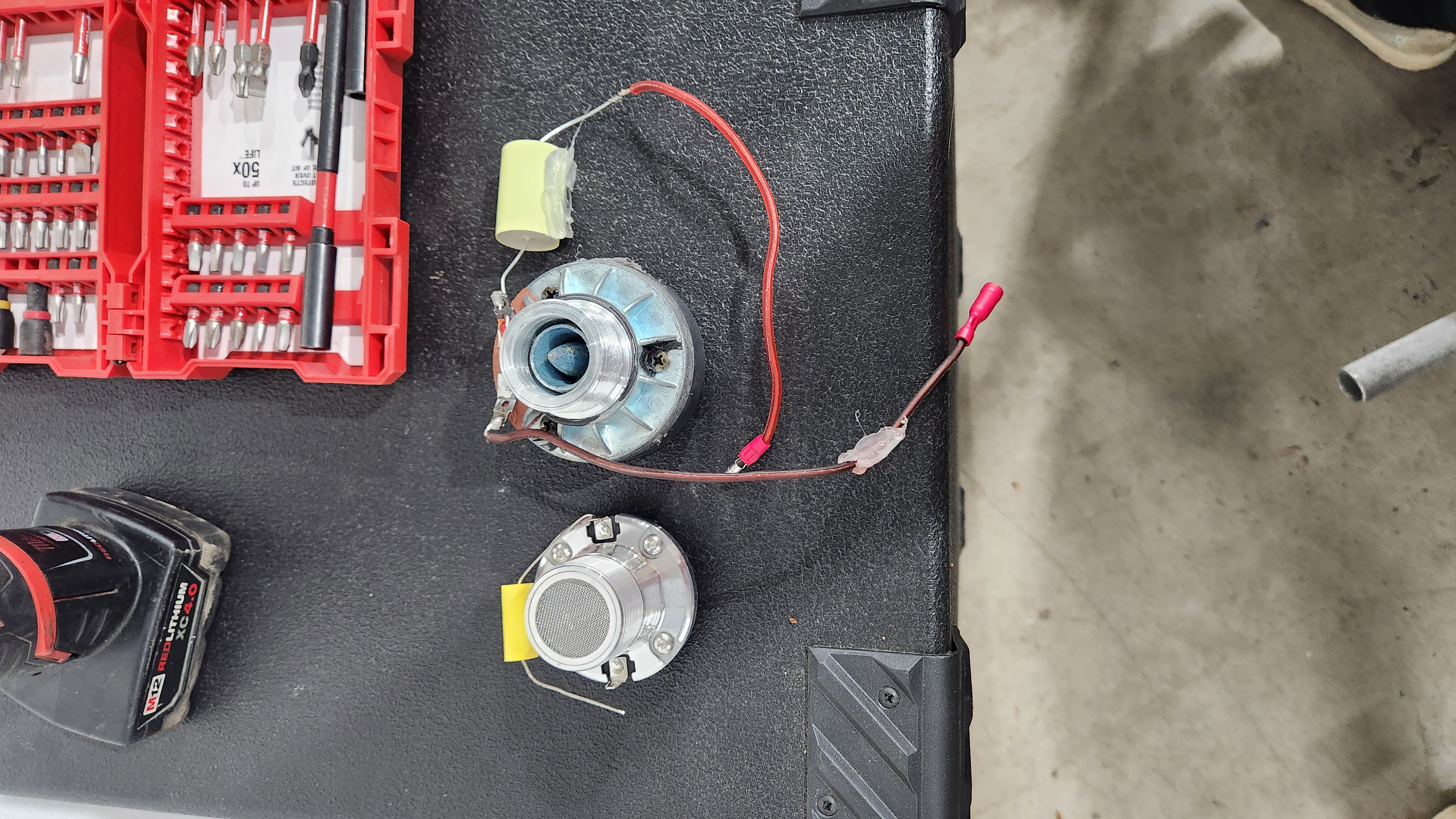

New tweeter came in today, it's much smaller than the original and might be a waste of money if I am really pushing it with more than 40 watts...
But anyway I got it swapped out, it didn't have a protection cap but a resistor in series. I added the 10uf cap in series with that and got it screwed in to the horn.
I am totally unsure about the resistor or the cap if anyonr has anything to add I'm all ears.
The "clipping"is gone but the "tune" is off, mostly levels and the tweeter might be out of phase, I'll have to perform the Seth tuning regimen again to get it back to the correct output.
So success I think.
And as I was reading yalls replies I remembered I forgot to measure the resistance of the APT coil.
2.30 ohms is the response, I think Seth wins some sort of award for that extra bit of homework.
