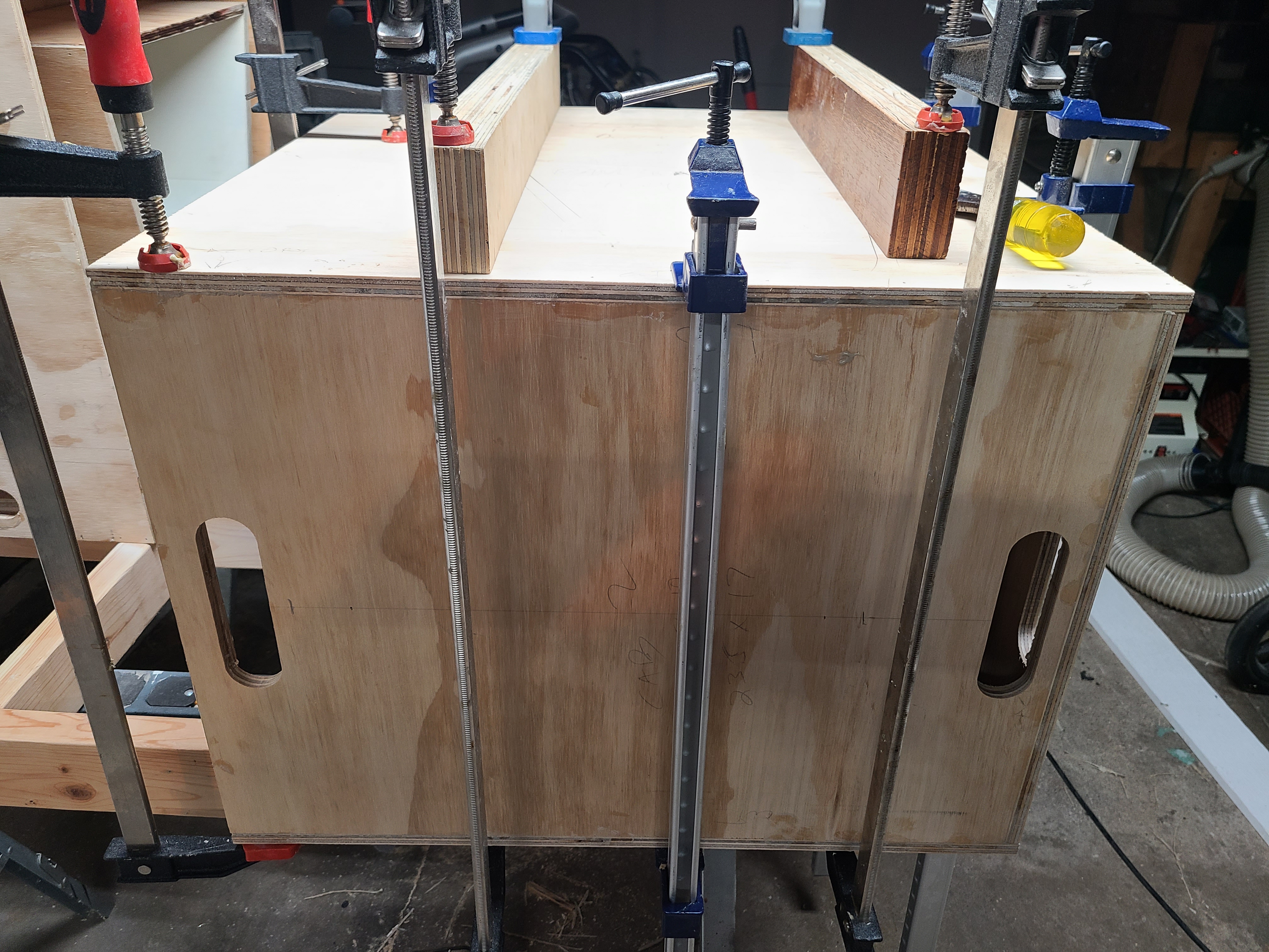

I glued the second side on cab 2 the other night, forgot to post pictures.
side finally on
side finally on
scraped the PL after 2 hours
