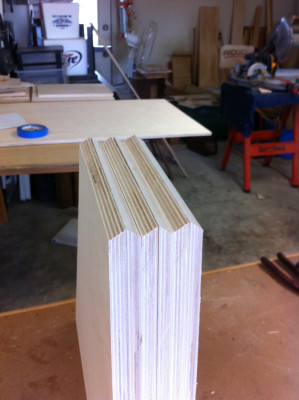

Thin veneer is on cabinet grade ply. All you have to do is look at the edge of the ply. The thin veneer is very obvious. Baltic birch will nine equal plies in a half inch.
This is 6 pieces all together, but you can see the 9 plies on each panel....click on the pic to make it bigger.

Alright, thanks a lot for the picture! It clarifies everything. Tomorrow, we will go pick up the wood, I hope it is going to be good. Else I will have to wait 2 - 3 months for it to get back in stock.
UPDATE:
Forwaded the picture to my cousin, he says all the ply he orders looks like that, no thin veneer on the outsides.
