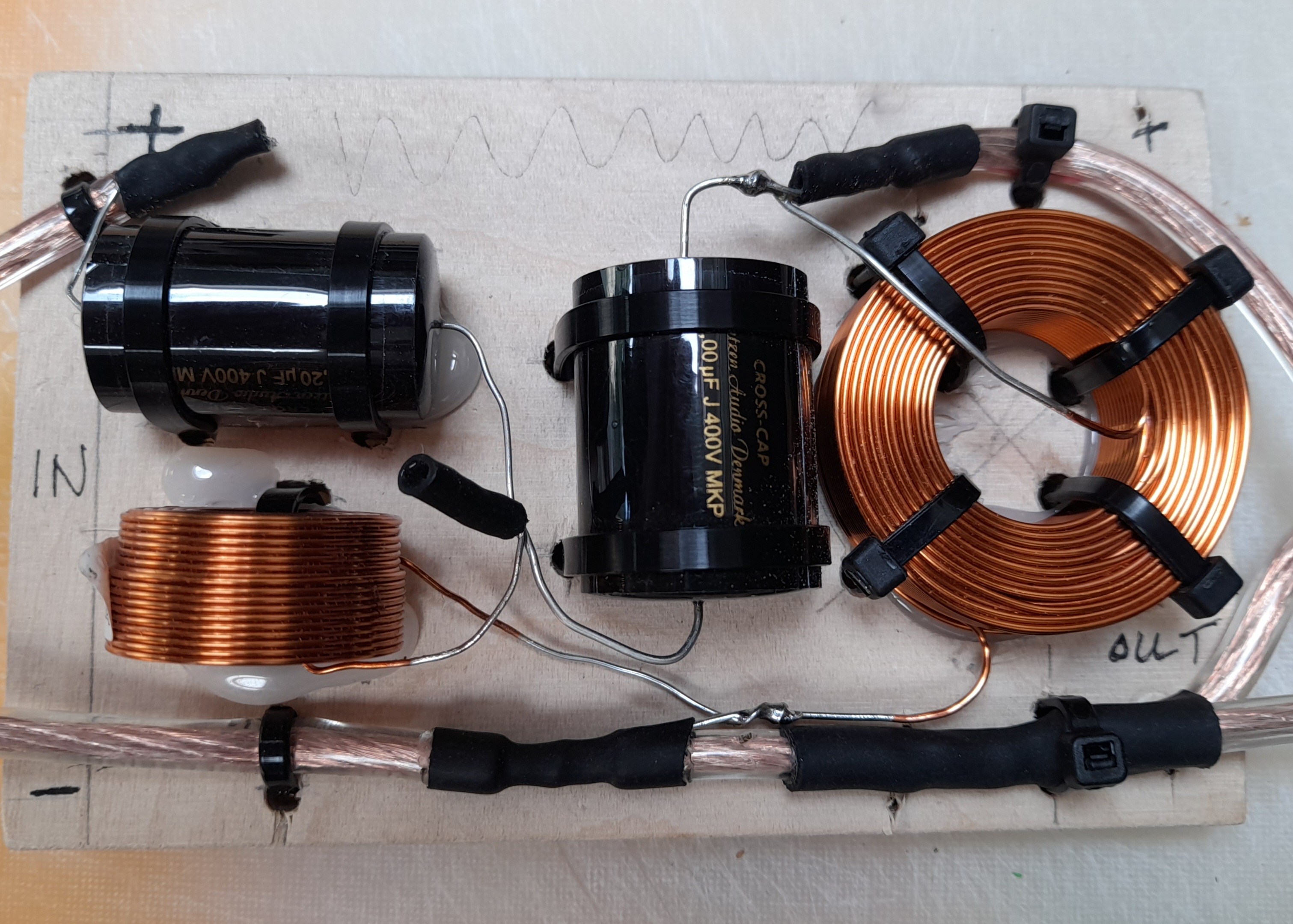

These are my crossover boards
I've rechecked the drawings and connections. I believe all is OK, but feel free to point out any errors.

Can you tell me the values on the capacitors and coils in your high pass filter (second photo above)?

#39 Post by Verb »
Posts: 3054
Re: Simplexx 1x12 questions
#40 Post by Seth »
Perfect. Looks all good to me.
The hiss is likely from the amps or possibly a dirty/corroded connection. Have you tried any contact cleaner in your jacks?
