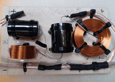

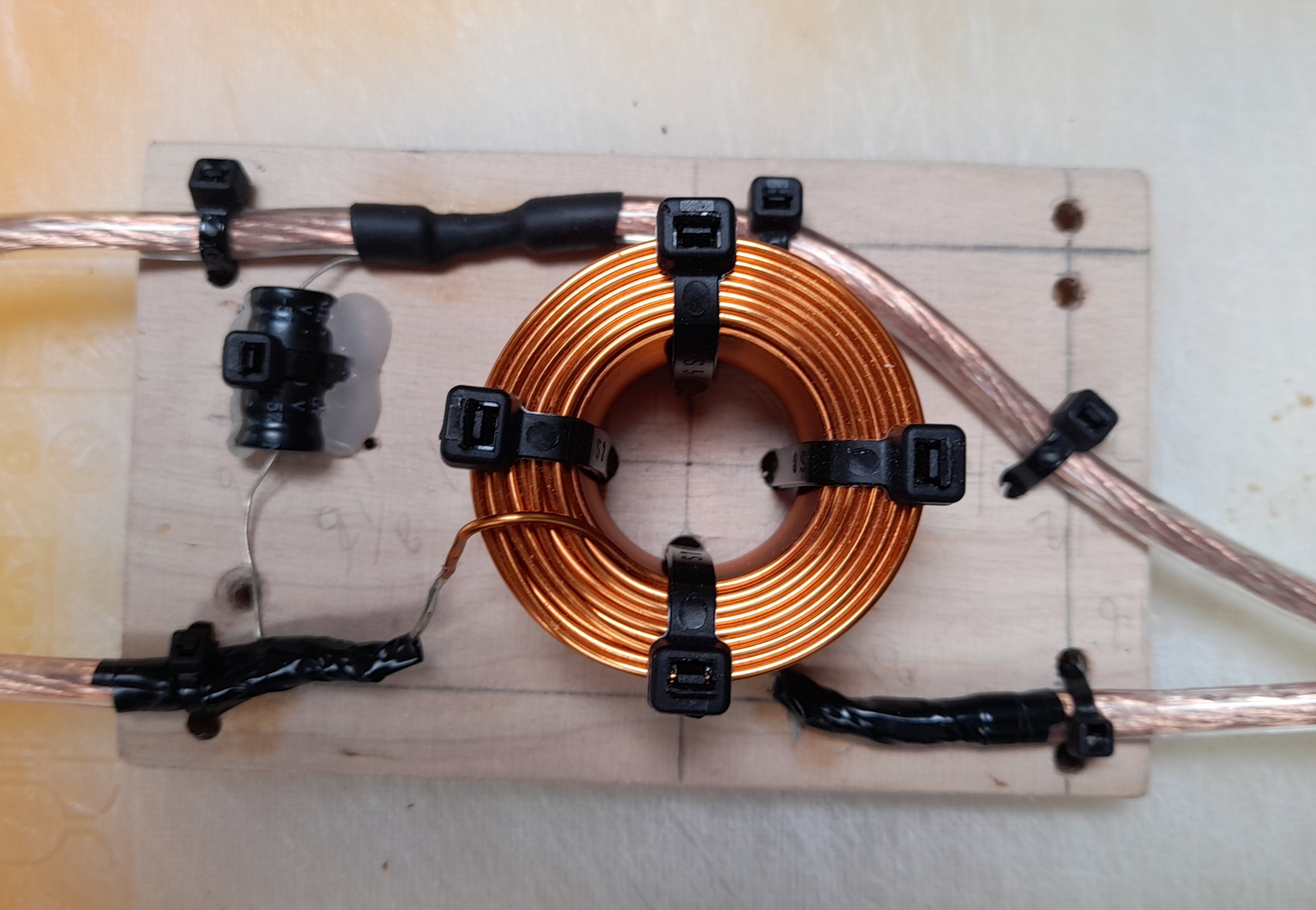

These are my crossover boards
I've rechecked the drawings and connections. I believe all is OK, but feel free to point out any errors.
I've searched online and it appears hiss is quite common when using tweeters, I've never had a cab with one before.

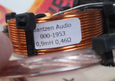

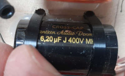

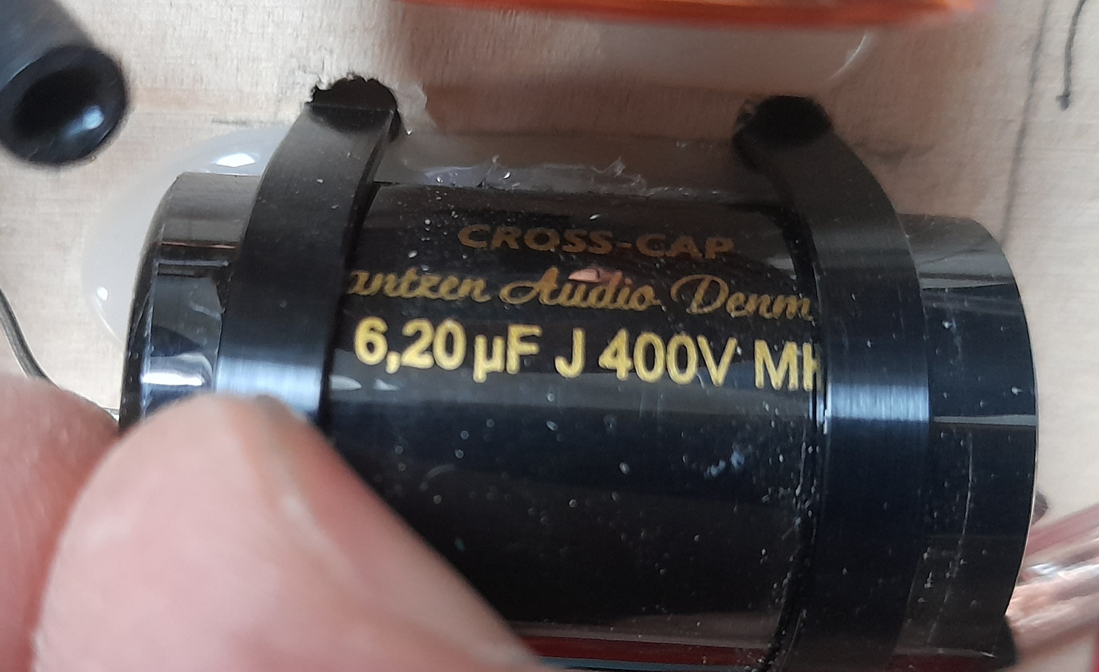

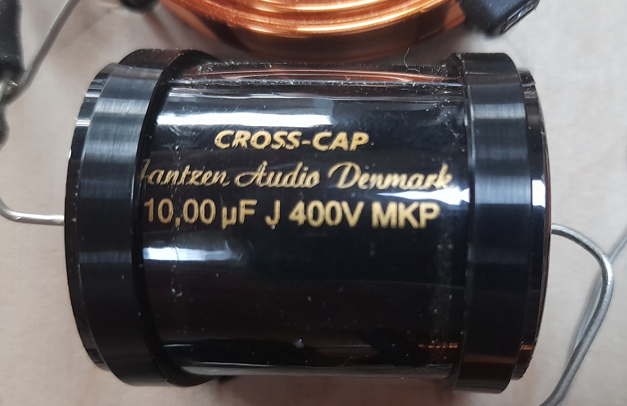

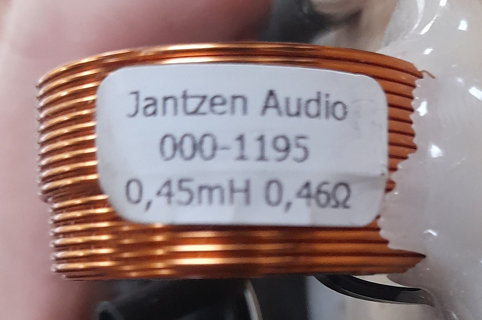

Can you tell me the values on the capacitors and coils in your high pass filter (second photo above)?
Re: Simplexx 1x12 questions
Perfect. Looks all good to me.

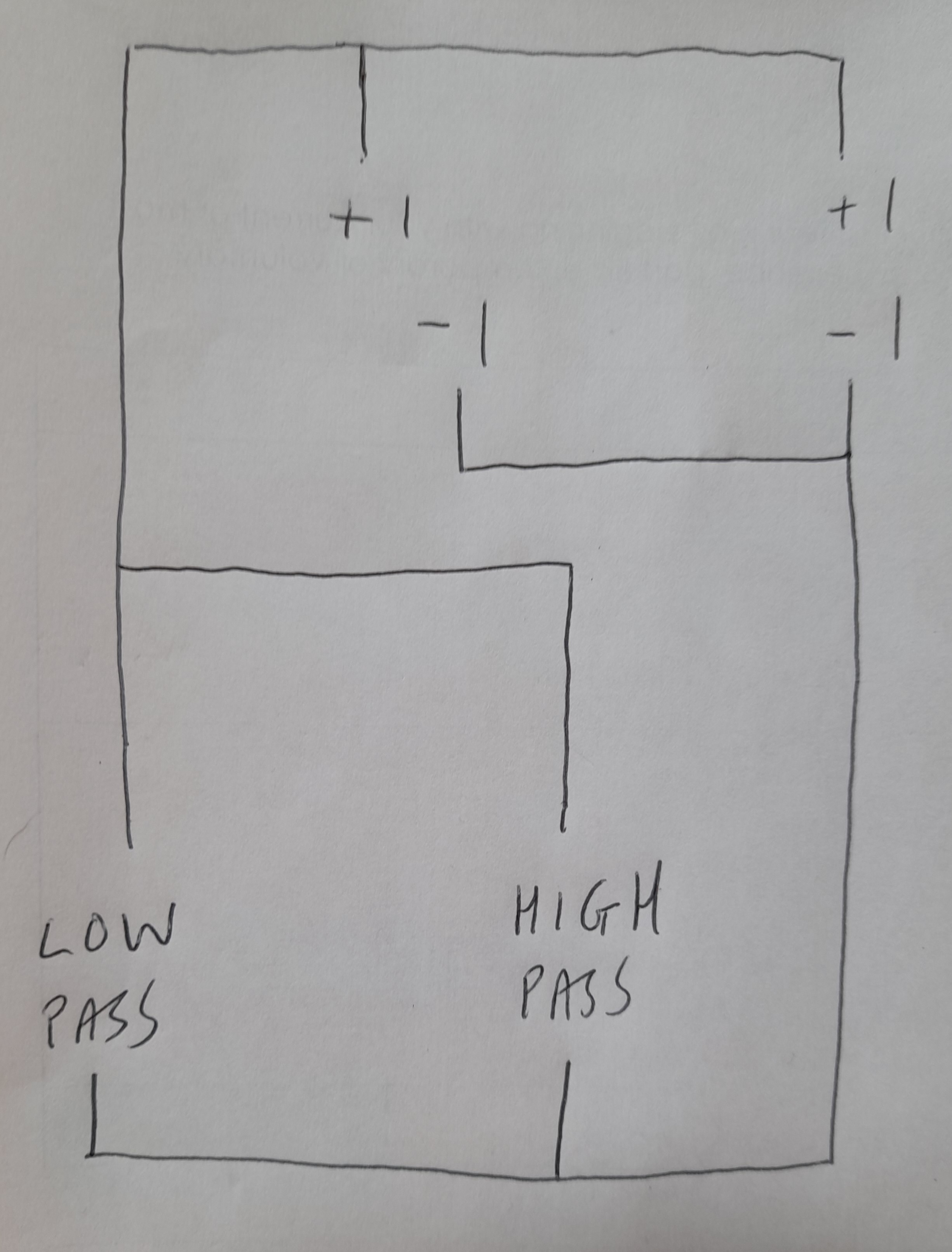

Due to the small size of the connection tabs on the speakon connectors, I didn't attach jumper wires from one jack to the other. I connected one wire to each tab and then split from this wire to the crossovers, I have attached a diagram showing how the connections are made. I believe this is electrically the same, but wanted to check before I connect the crossover to the new woofer.

I don't know what that diagram is showing, but it's not what the wiring should look like. I suspect the crossover is incorrectly wired.
Sorry for my poor diagram.
The +1 and -1 are the connections on the speakon sockets and the wires go to the crossover inputs.
