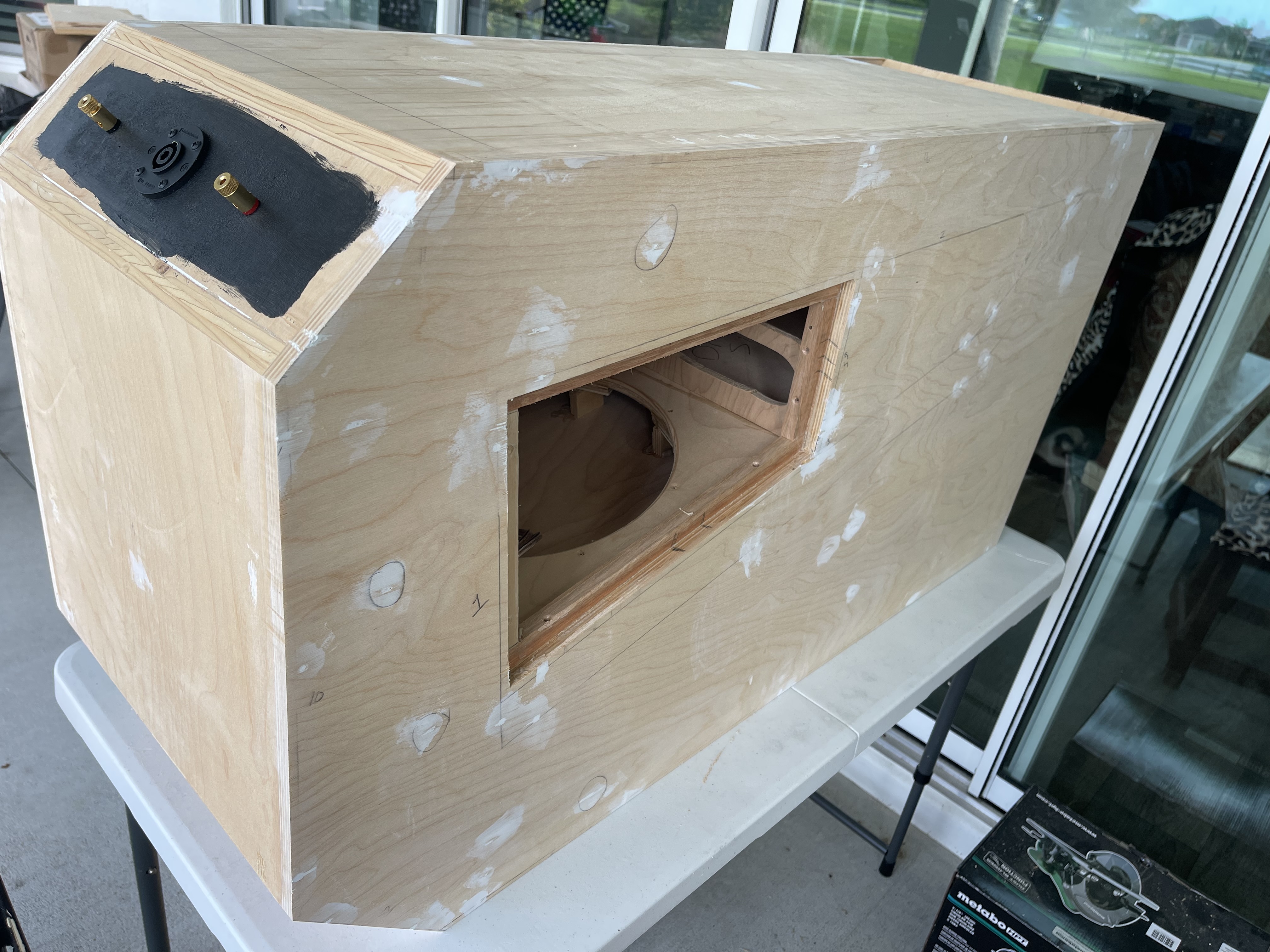

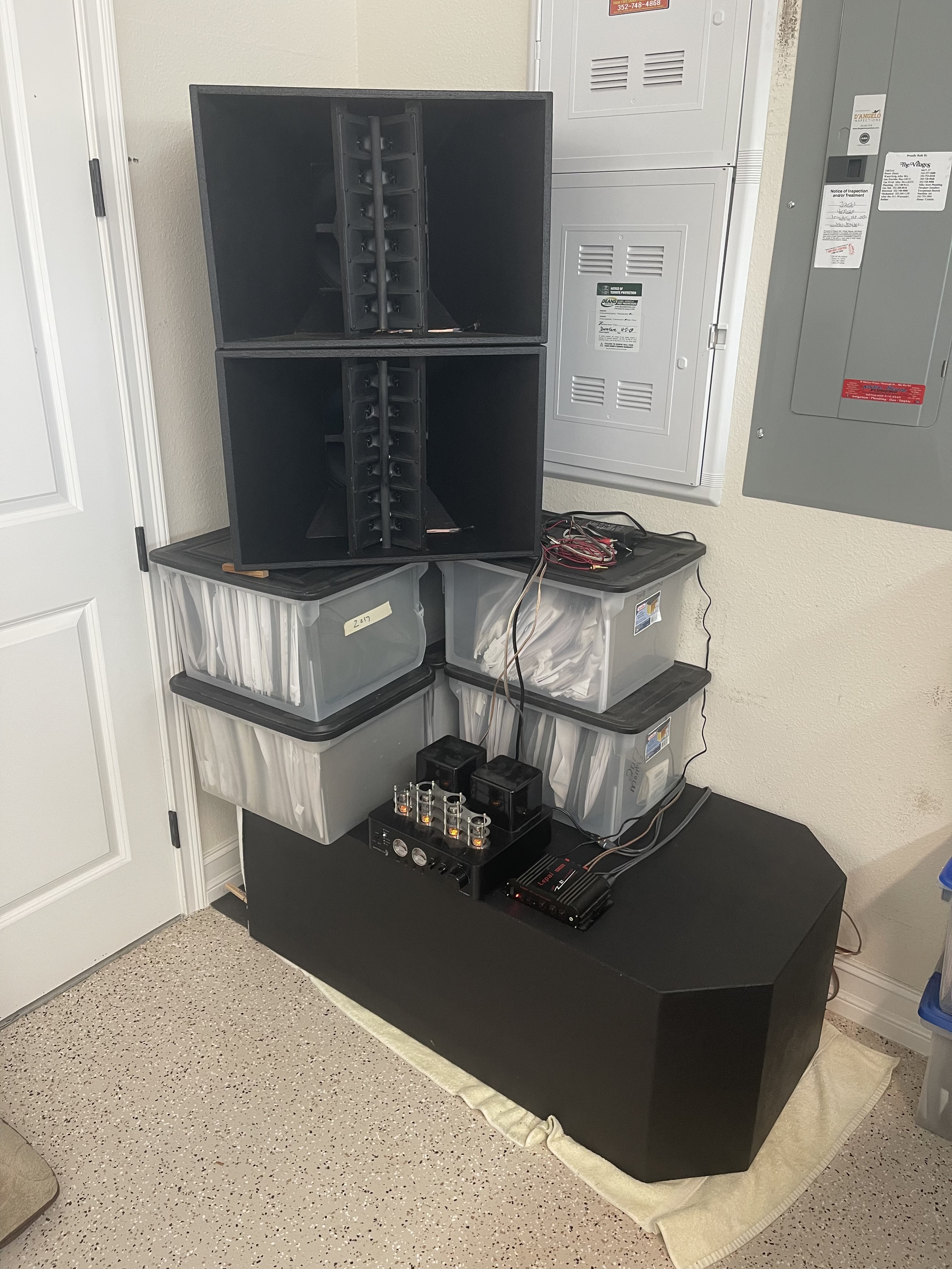

All done it’s current resting place :)
I have the most redneck grill ever lol

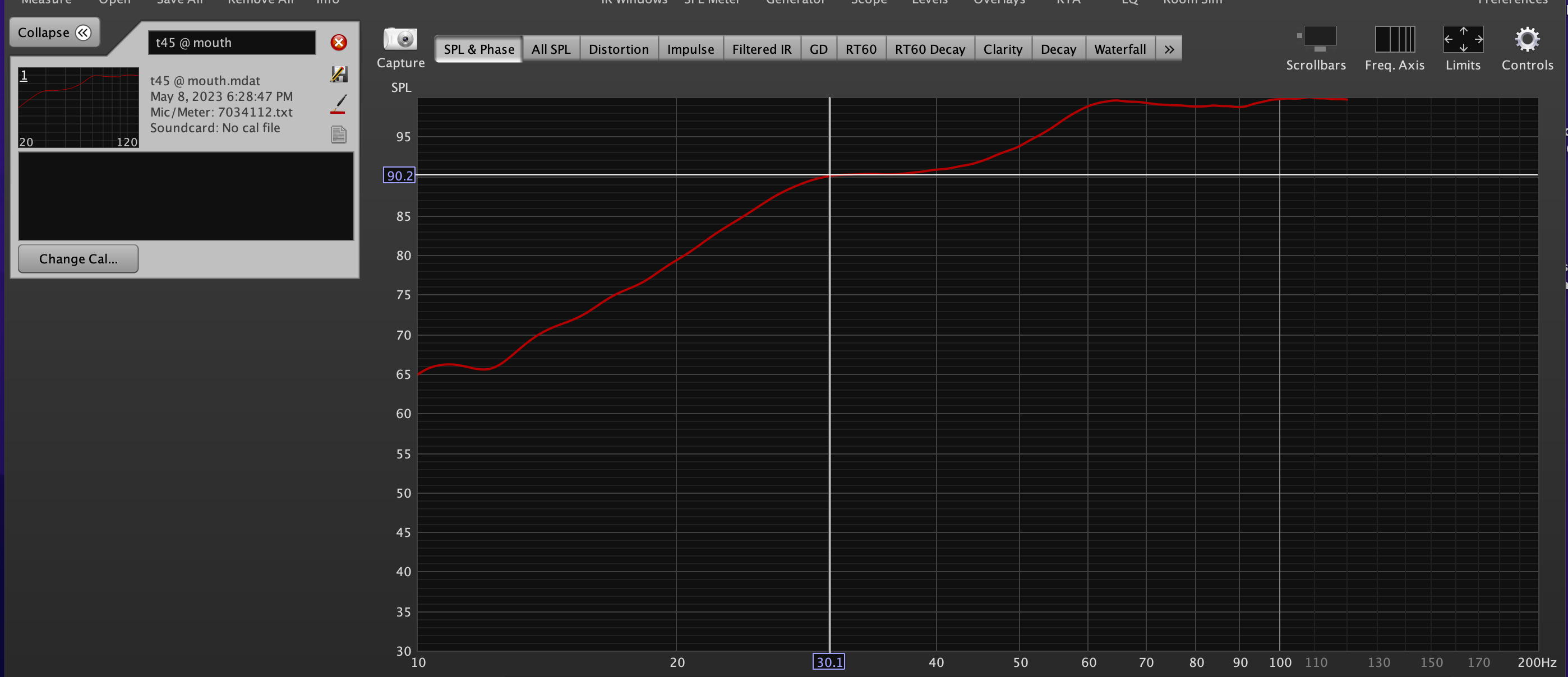

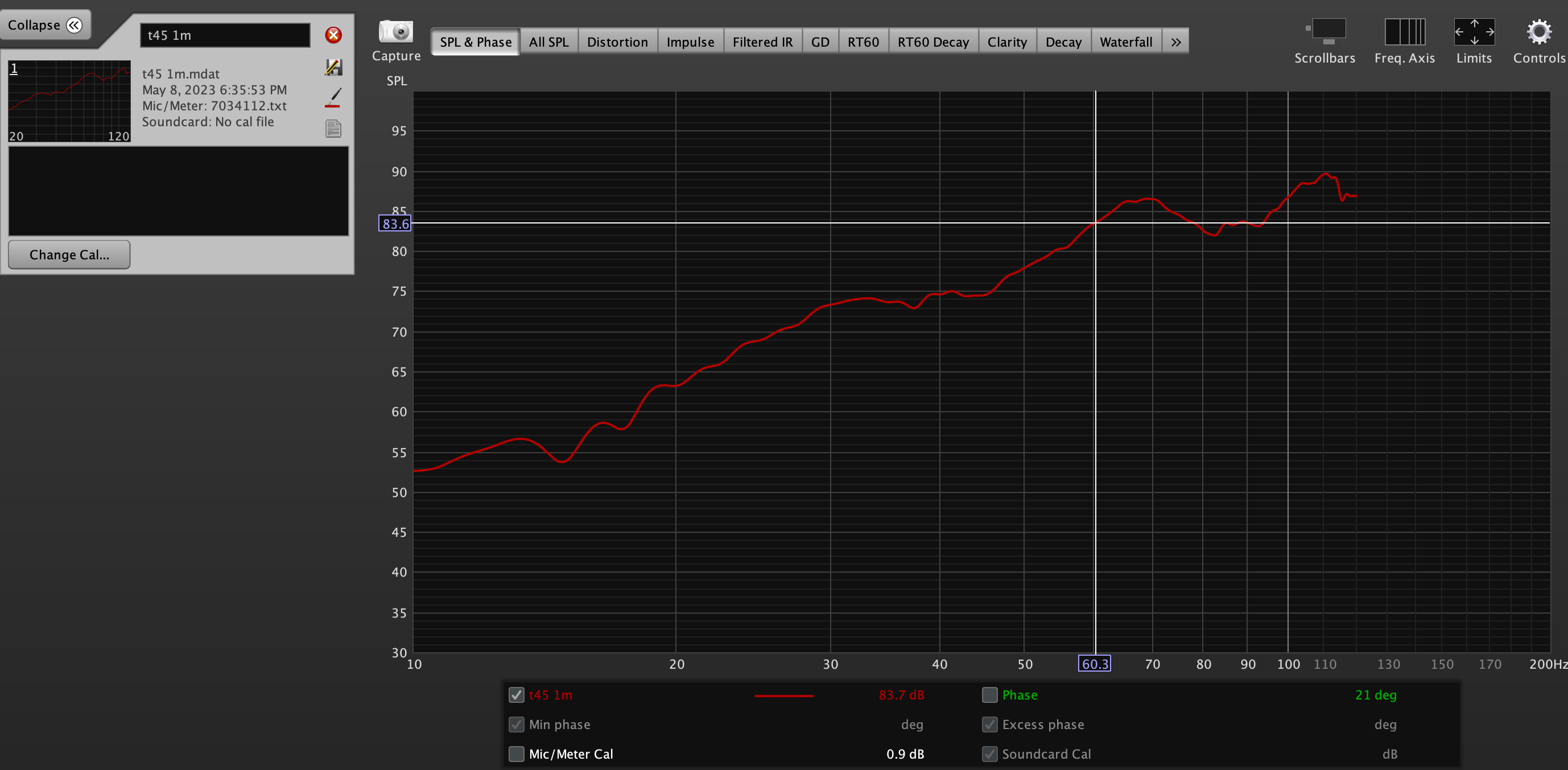

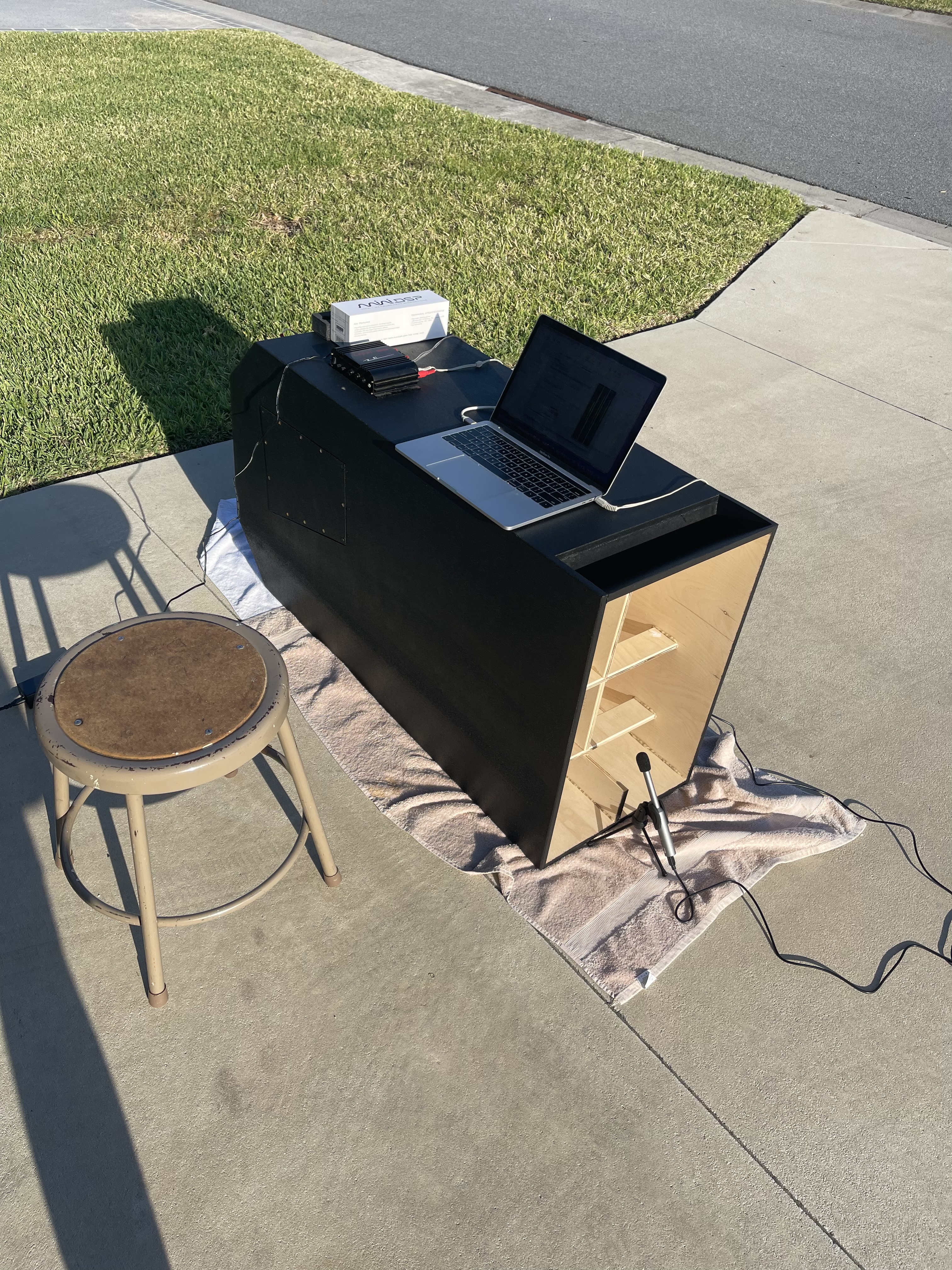

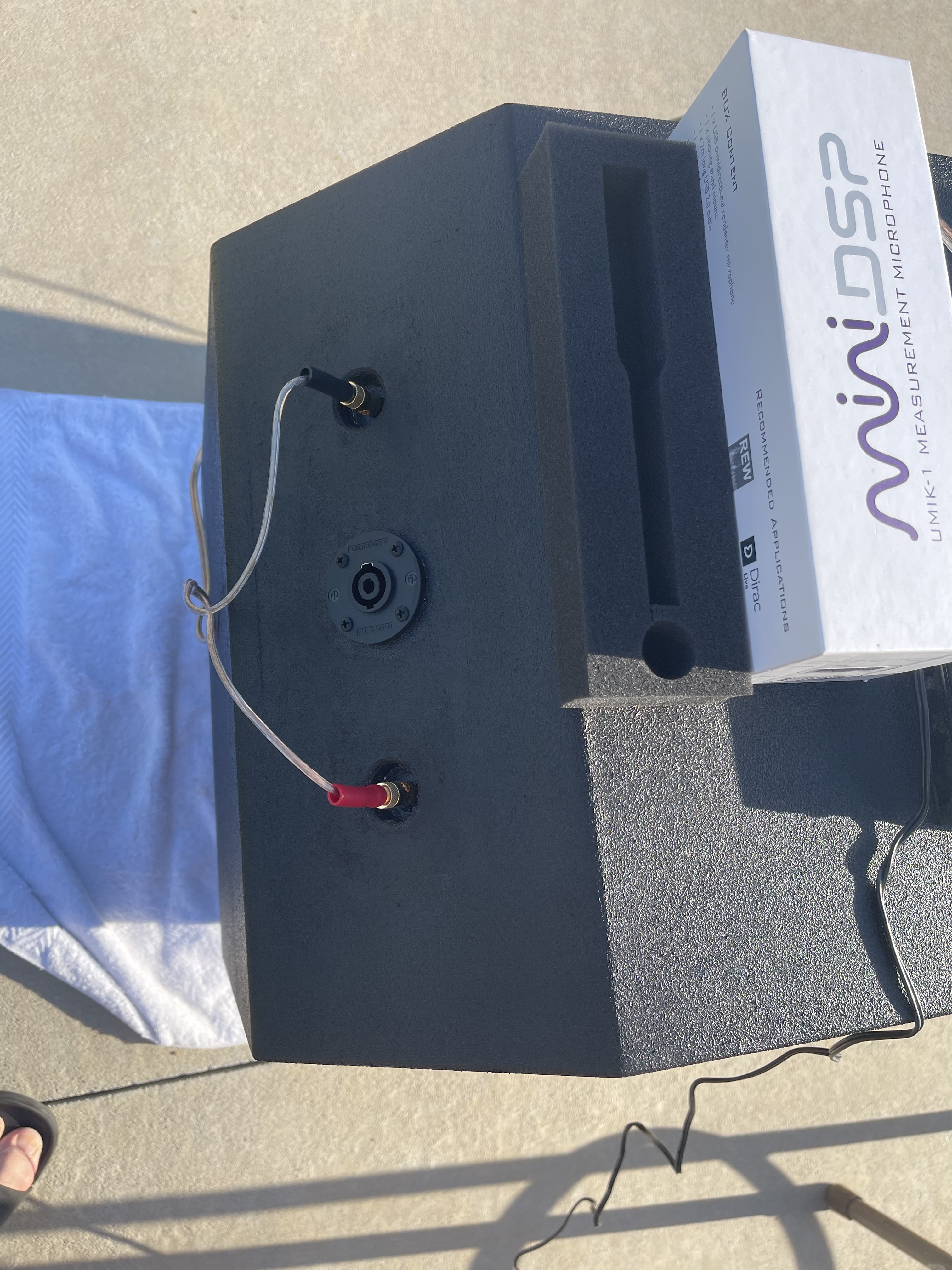

Testage!!!
Fastskiguy
Posts: 176
Re: OmniTop 12 build
#78 Post by Fastskiguy »
Charts! With the mic right in the mouth and again at 1m away. I'm not very far away from the garage so I'm thinking there are some reflections in there. But with the mic right at the mouth it's looking like the published charts so I'm pretty psyched :)

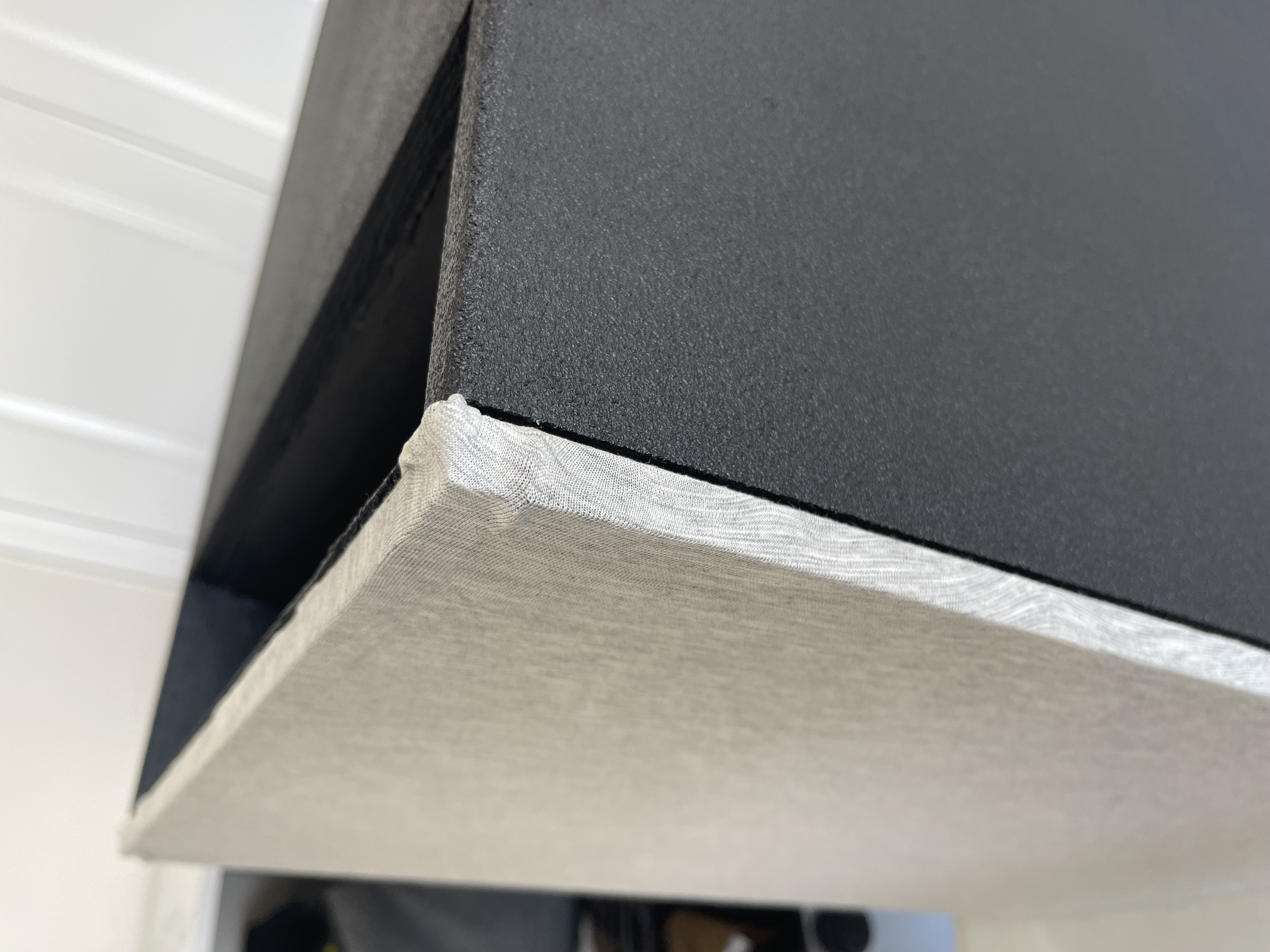

Fastskiguy wrote: Mon May 08, 2023 8:04 pm I came up a bit short on the bottom edge and glued on a thin strip of plywood. Hit it with the router and Duratex and it turned out ok. Just wanted to throw in a little something….it is a build thread after all.
Joe
It's amazing sometimes, how easy and effective it is to make oopsies disappear, like they were never there in the first place. Well done :thumbsup:
Fastskiguy
Posts: 176
#81 Post by Fastskiguy »
I tell you what, that duratex is just amazing stuff. Easy to work with, easy to clean, looks pretty good, covers up a multitude of defects, dries fast, 1 little pail goes a long way, the little rollers are cheap, dries hard as a rock. I've heard from more than one old timer in the woodshop that it's not about making the perfect thing, it's about perfectly fixing the blunders that inevitably come along during any build of anything.

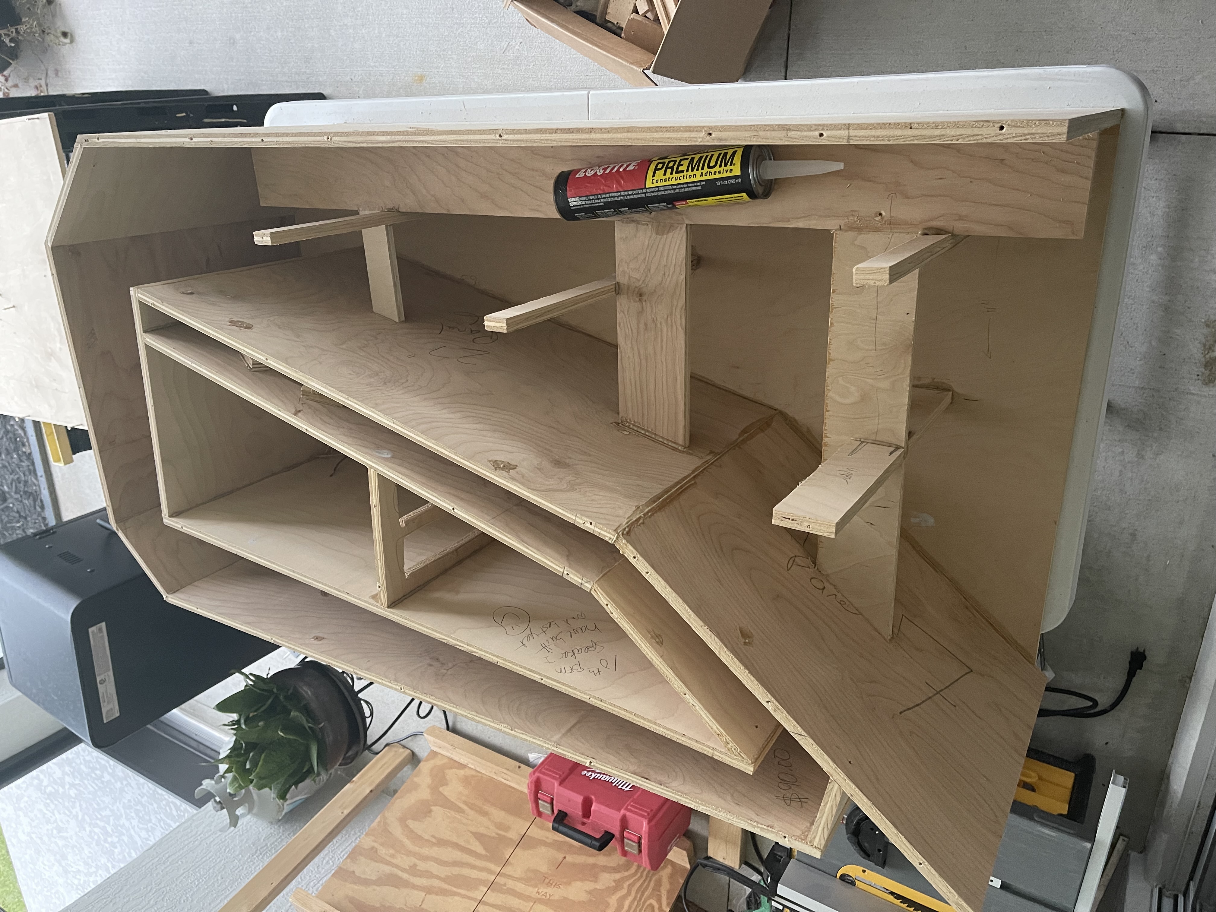

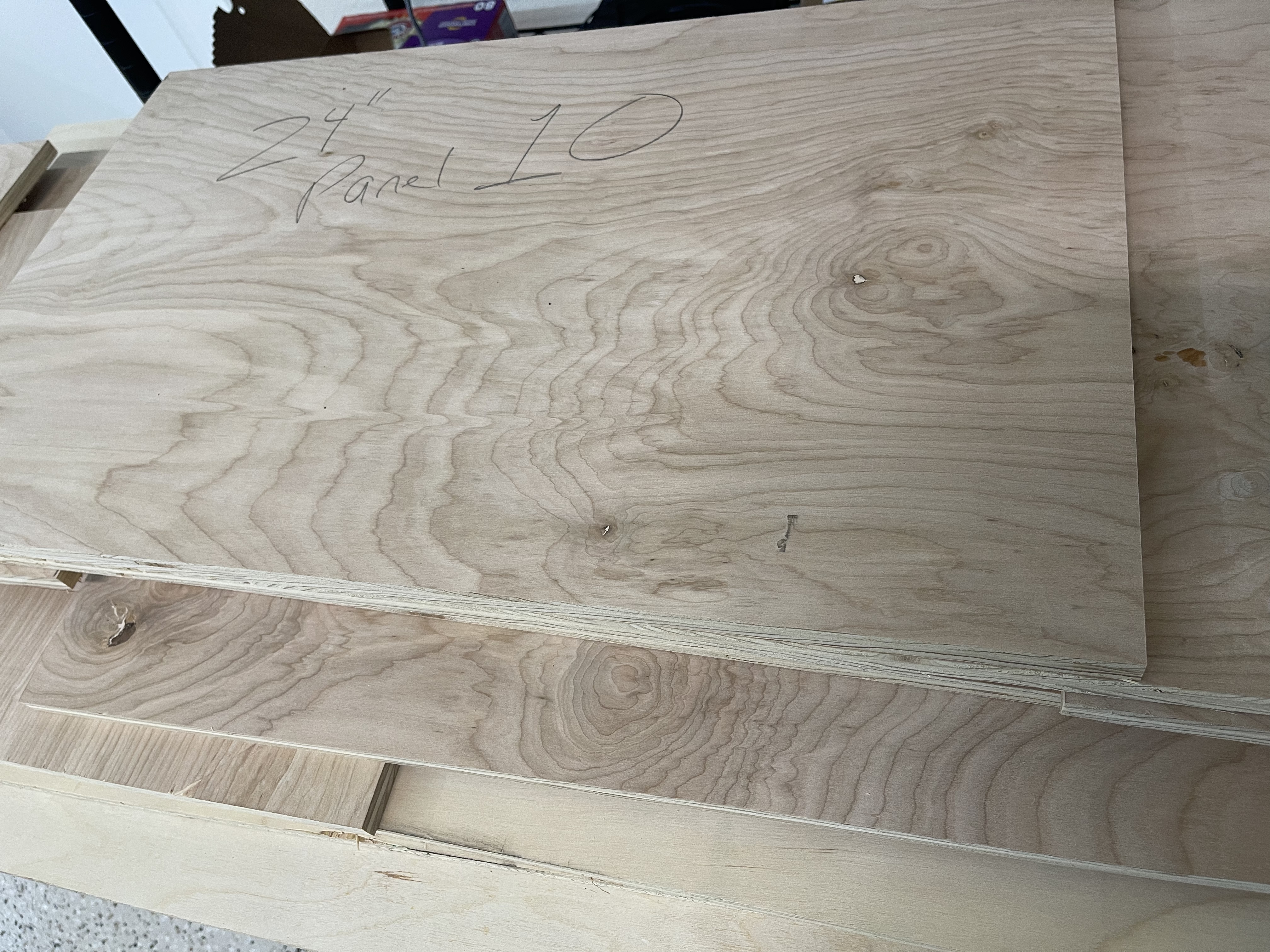

Mwahahaha!
Posts: 3066
#83 Post by Seth »
I've had four 30" wide T39's and four DR200's in my storage unit for a couple years that look just like that. One of these days, maybe I'll get around to assembling them! One thing's for certain... they definitely take up less space in a pile like that! LOL
Loving your progress!

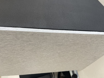

Finally!!!!!
