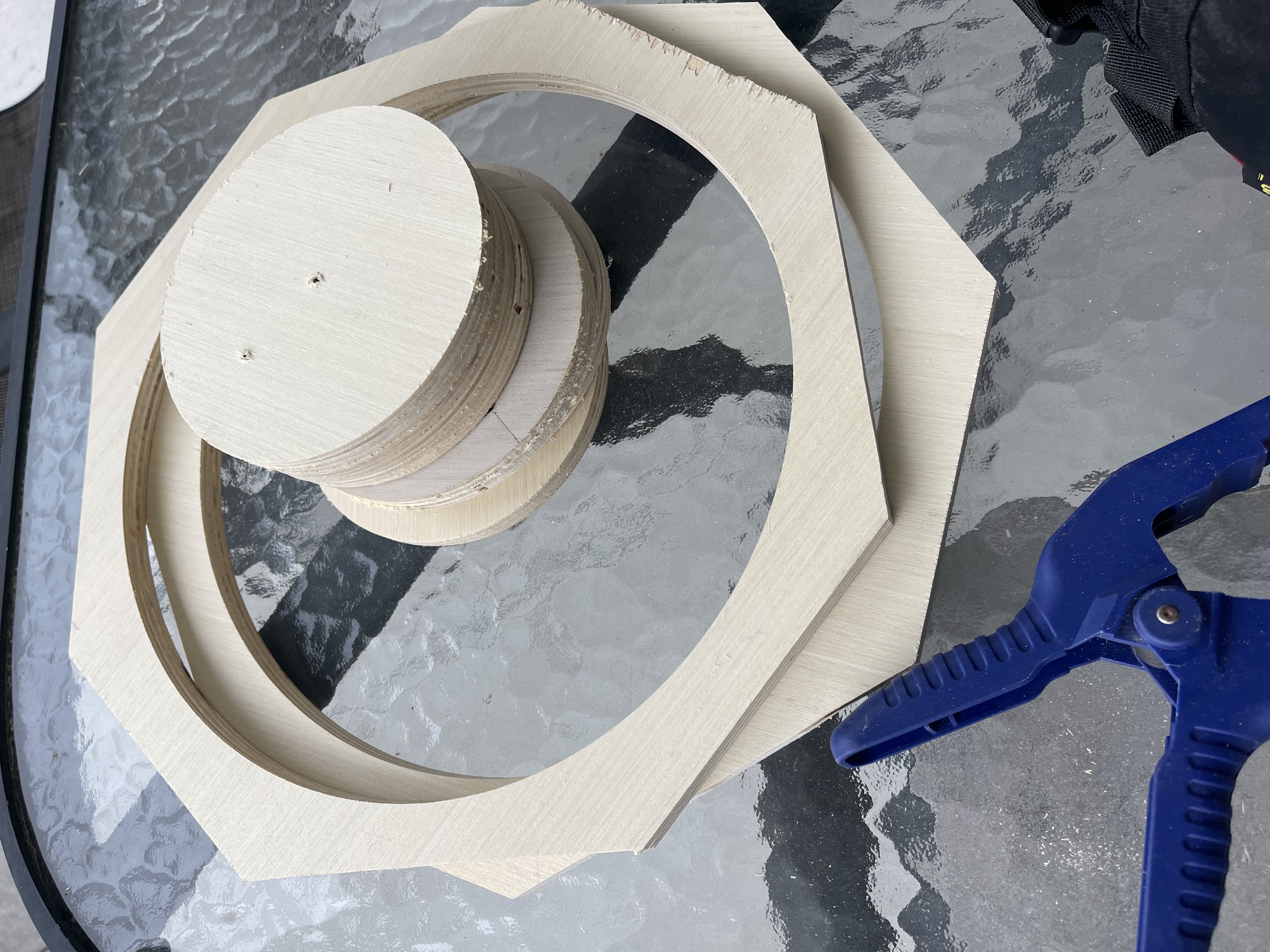

Spent some time making a couple of router jigs for circles. These worked pretty well.

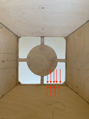

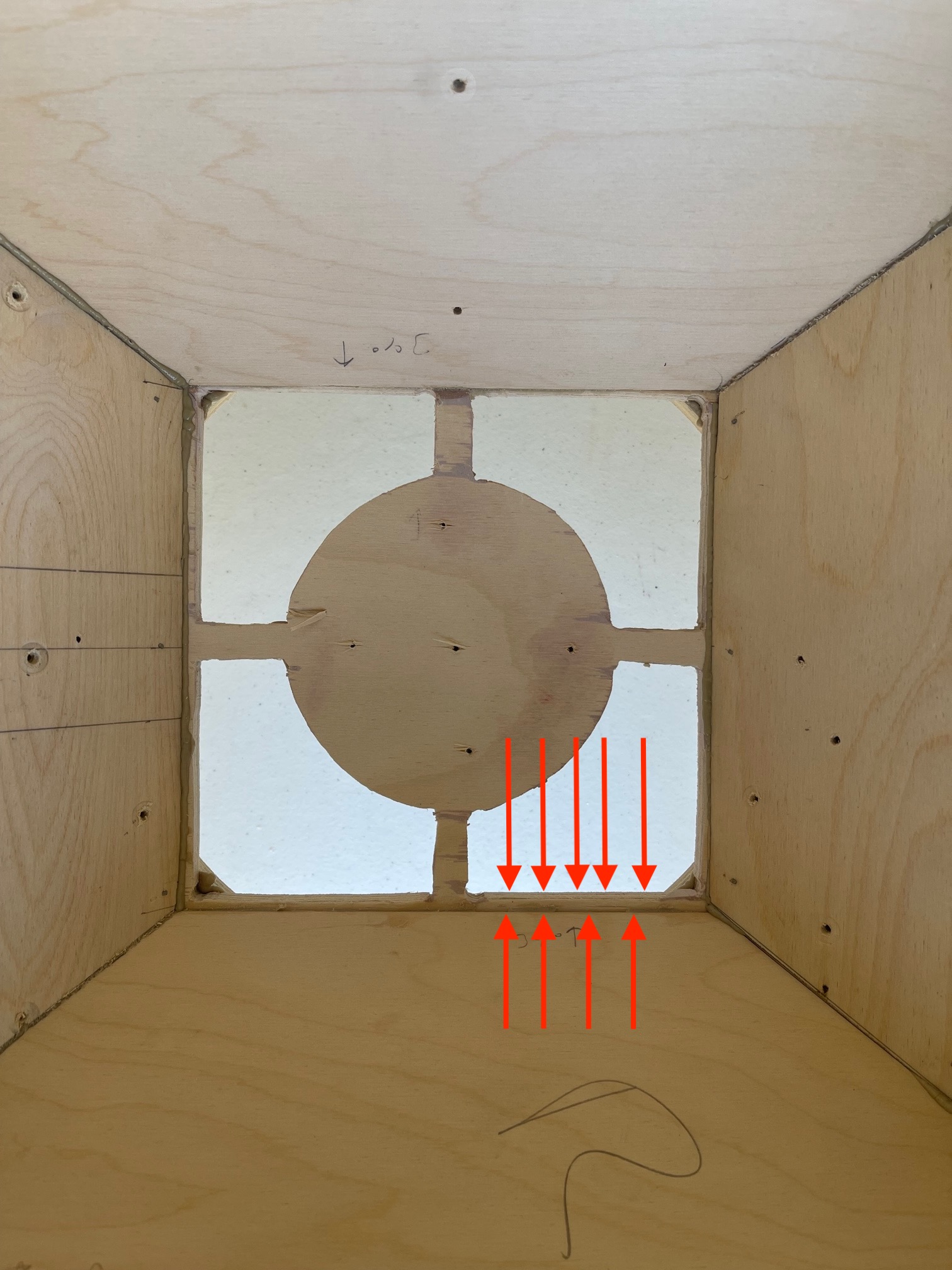

Making faster progressed than planned and...for the most part...it's going well. But the baffle....oh boy, I'm looking forward to taking another crack at this someday on speaker #2. I have a question about the little lip that is shown in the arrows below...should I take a rasp or file or something and trim back the baffle until it is flush with the horn panels and throat reflectors or is that lip OK? Thanks guys :)
Joe
Posts: 29125
Re: OmniTop 12 build
That lip is far too small to have any effect. Anything less than a quarter wavelength in dimension is invisible to sound waves. A quarter wavelength at 2kHz is 1.9 inches.
