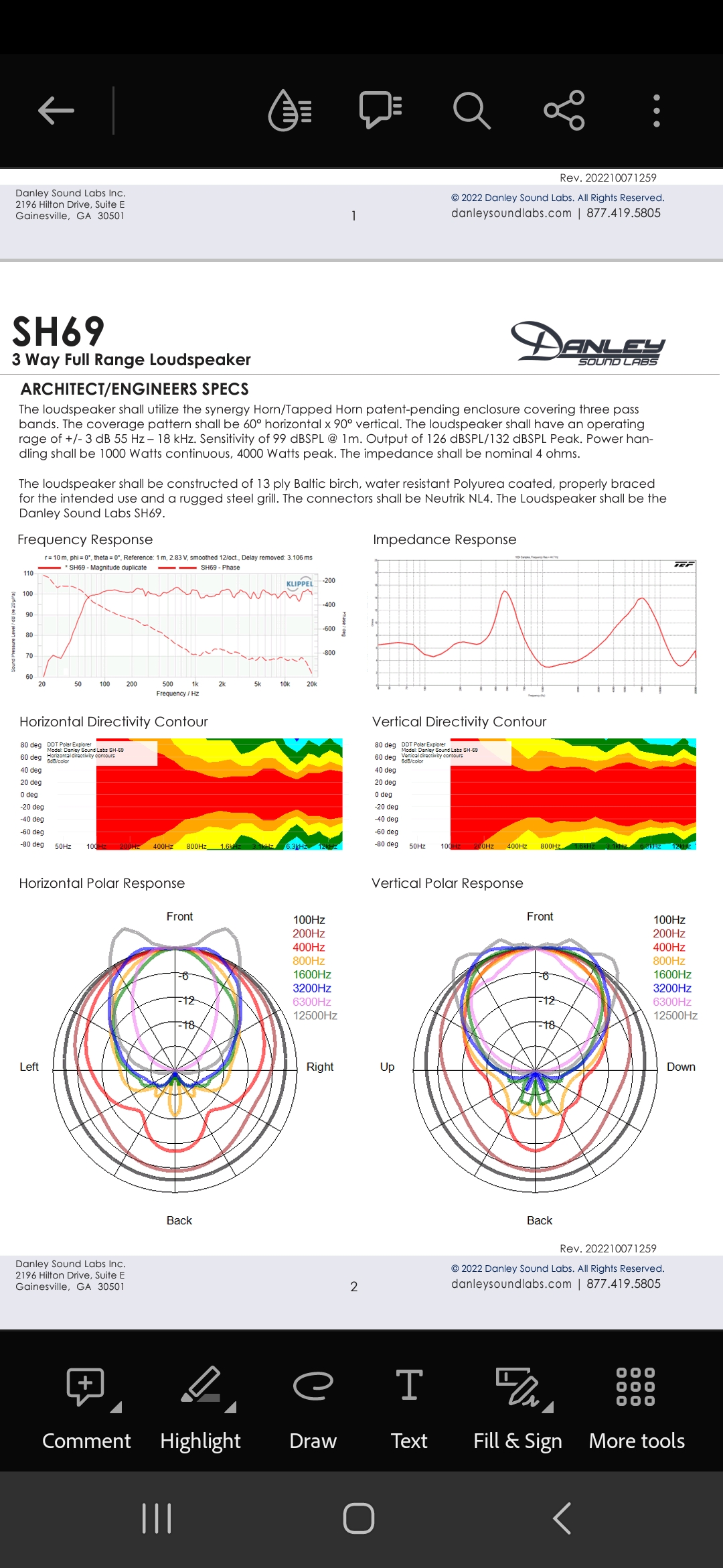

Re: Tuba 60 Outdoor Wall Loading
Cool.
So that's the design brief.
What you need to see if you can find now is if the design brief has been met (by measurements) post construction.
It's a bit odd. I would have thought 90 horizontal x 60 vertical would suit most needs better, rather than the 60 x 90 in the design brief.
Your sweet spot and coverage would be much wider and greater if it was.
Pointless firing so much energy at the floor and ceiling...

Interesting points. The silly thing is that we listened to about 7 other models of Danley at a dealership, comparing them to RCF and our BFM Jack 10s. We simply loved everything we heard from Danley, but the SH69 weren't one of them. Then I just ended up buying these used because they were a great "deal".Grant Bunter wrote: ↑Thu May 04, 2023 8:56 pm Cool.
I think they can run just fine mounted the other direction.I do like the idea of keeping energy off of the walls, just like the ceiling. So maybe the intent is for them to be used outdoors where a crowd of people is absorbing and diffusing the floor bounce and the sky is handling the rest
In all seriousness though, do you think we should actually stand them on end for this outdoor show? "super-stereo"
Wow. I'm realizing I'm not even sure which direction is which with these things. I always assumed when the were laying down.. horizontally.. that was the wider coverage. Now I'm second guessing that.
Way down the bottom of this page:
https://www.danleysoundlabs.com/products/sh69/
there is a mounting bracket.
The pic, with the bracket on the cab, suggests the longest measurement is horizontal to the floor. For me, that's the 60 degrees...
Yeah. Fair point. The bracket is explicitly stated to mount vertically or horizontally though, so I'm still unsure of that being a definitive answer. I will ask Ivan.
