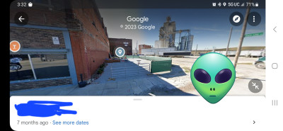

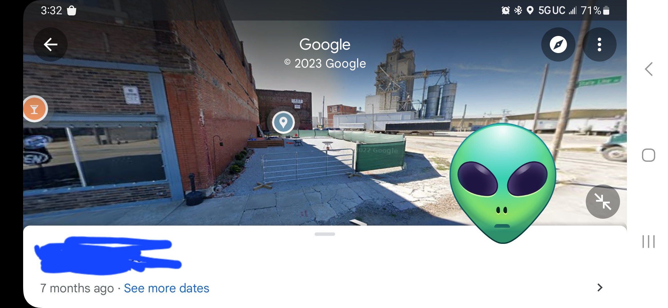

I'm considering trying to get extra output from using that brick wall to the left in the image.
Otherwise the plan would be 4 15" LAB loaded T60s horizontally across the ground facing the photographer of this image. At least 12' from the left wall. About right where the Google Map icon is, mouths in plane with the green fencing (that would be temporary peeled back).
I think using the wall could get us more output, but I'm always a little confused by how to place them.
Thanks in advance for any input.

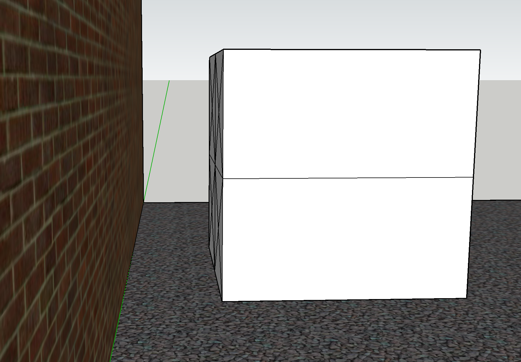

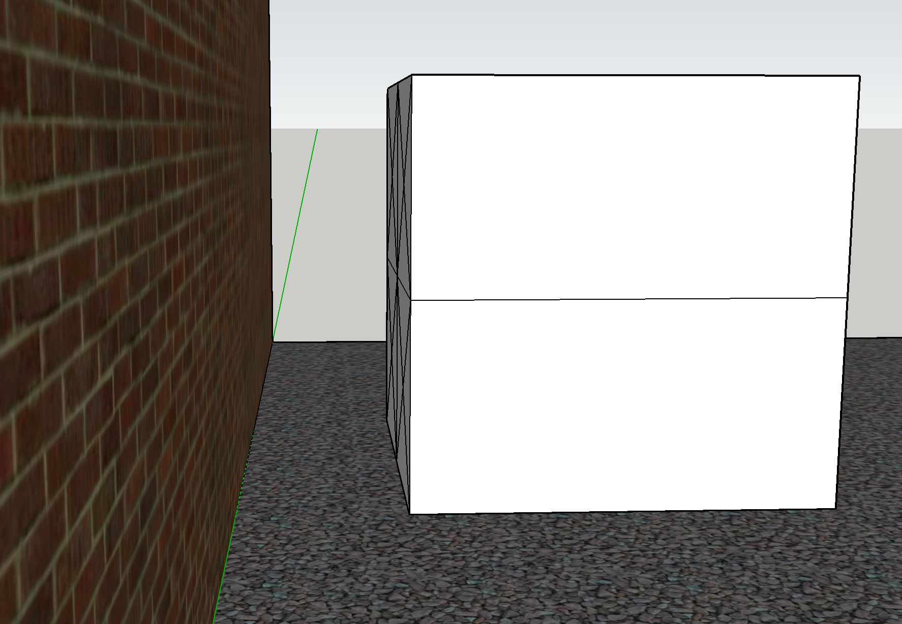

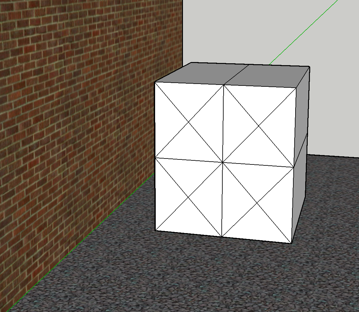

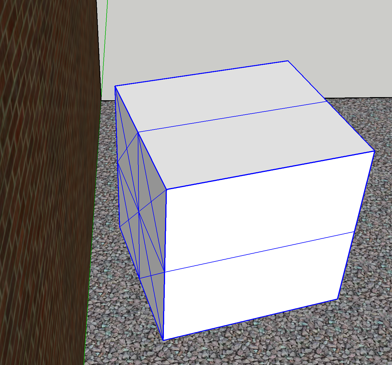

Which of these would be best? I do not really understand the concept, so your description left a lot of room for imagination with my ignorance involved.
Quick sketch. X signifies mouth of T60.
A:
B:
C:
4 T60's
2 Danley Sound Labs SH69
Ashley Protea
QSC PLX2
Crown CDi
Posts: 29146
Re: Tuba 60 Outdoor Wall Loading
#4 Post by Bill Fitzmaurice »
Aiming at the wall may work slightly better. The main thing is having them close enough to the wall.

Fastskiguy wrote: Sun Apr 30, 2023 5:15 pm The second and 4th pictures look the same to me....is that ideal?
Joe
Yes, they are the same. The 4th image is the "attachments" window. I may be using the forum incorrectly. I was just trying to upload the first 3 images in-line.

One interesting thing about this wall loading is that our audience is so used to be right up on the subwoofers and only the depth of the woofers being between them and the DJ. Placing them near the wall will be quite a change.
What do you think the estimated gain will be? Compared to using the 2 x 2 stack about ~ 12' from that wall facing the crowd as normal?
4 T60's
Ashley Protea
QSC PLX2
Crown CDi
Posts: 29146
#8 Post by Bill Fitzmaurice »
You may gain as much as 6dB. That's the equivalent of doubling the cab count to eight. There's absolutely zero benefit in aiming them at the crowd. The output pattern is 360 degrees below where the summed mouths are less than a wavelength in dimension. A wavelength at 100Hz is 11.25 feet.

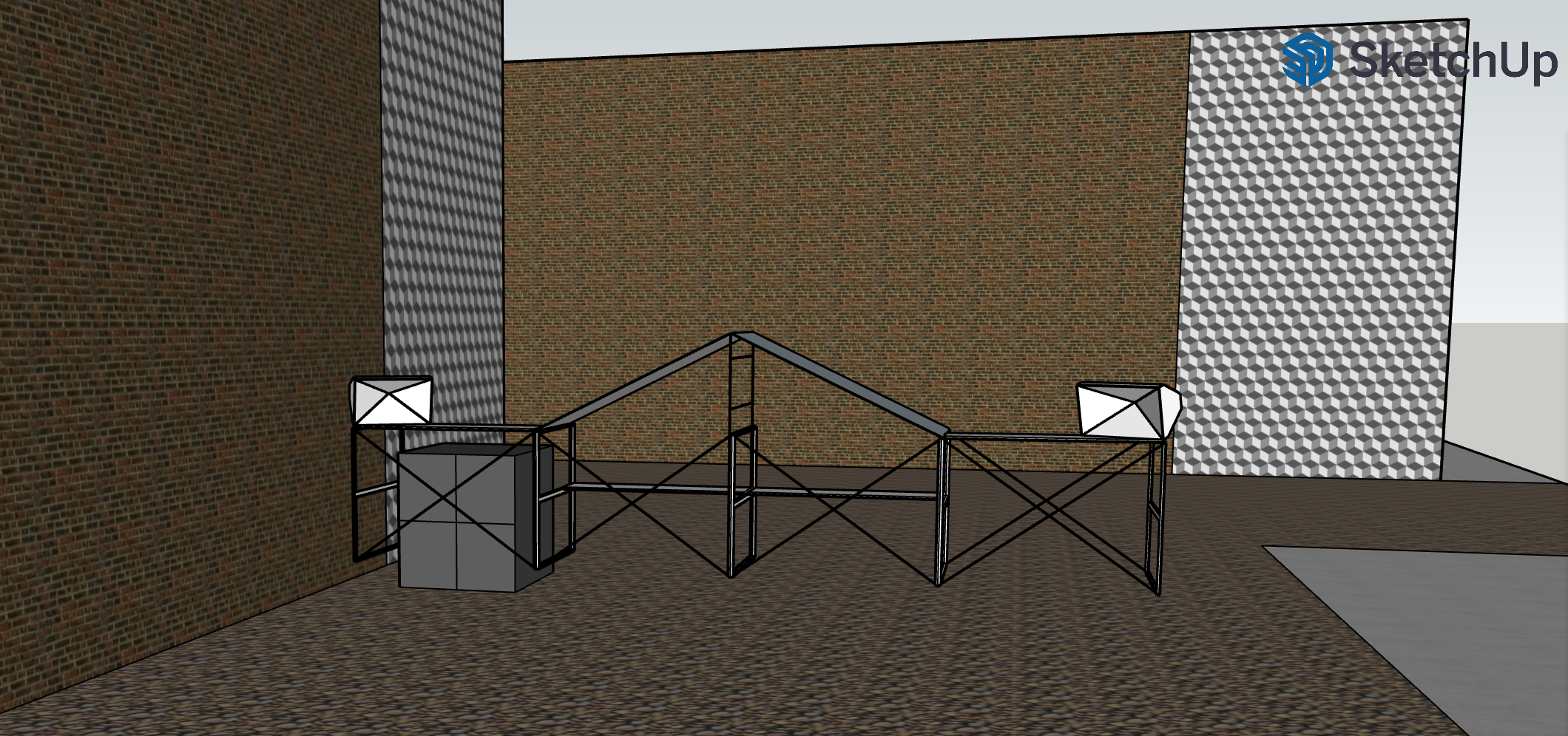

What do you think of this layout?
Won't it feel weird with so much level on the left side?
Tops are Danley Sh69 for anyone wondering.

It would feel weird if you could tell where the subs are, but you can't. They're not directionally locatable. For that to happen there has to be a significant phase difference as the wave arrives at each of your ears. There isn't, the wavelengths are too long.

5meohd wrote: Wed May 03, 2023 8:07 pm Screen Shot 2023-05-03 at 8.06.20 PM.png
Can you tell us if the areas with what looks like mesh in your rendering is actually mesh, or solid wall with dressing?
To get boundary loading you need a solid wall, not part solid wall(s) with openings in spots, is why I'm asking.
There's no dimensional figures, so hard to know, but your Danley tops look to be too low...
