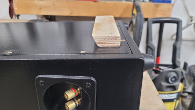

Thanks! That is 3/4" Pine, edge glued strips, usually sold as a shelf haha.
I used stain, just a little black in the mix, nothing special but i got the advice from a local colour shop :)
I used a sponge to smear it out, i think four times, letting it dry up between.
I should have used hot water on the wood before using the stain, it was my first time doing this and if you dont put hot water on the wood before you stain it, you get these small fibers to rise up and get sharp and difficult to remove, mainly where i used the router with the 45° angle on all the holes in the baffle.
Yeah if i would do another TLAH i would not backmount the drivers again :lol: soo much time and work, but yeah i also think it looks really nice!

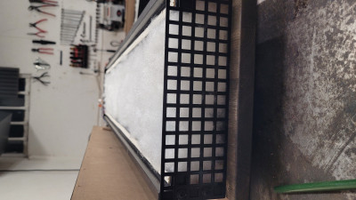

Filled up the cabs a bit more with pillow stuffing, completely filled but not compact at all, half a pillow for 2 cabs.
