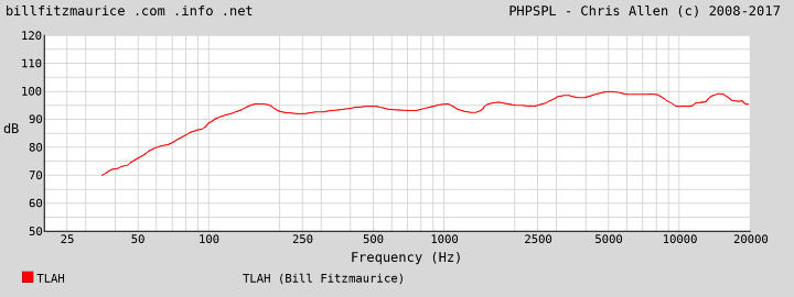

Re: TLAH sound
For contextual reference, presumably built and measured by Bill...
80Hz is 10ish dB down from mean sensitivity.
- Posts: 29105
Re: TLAH sound
That's mine.

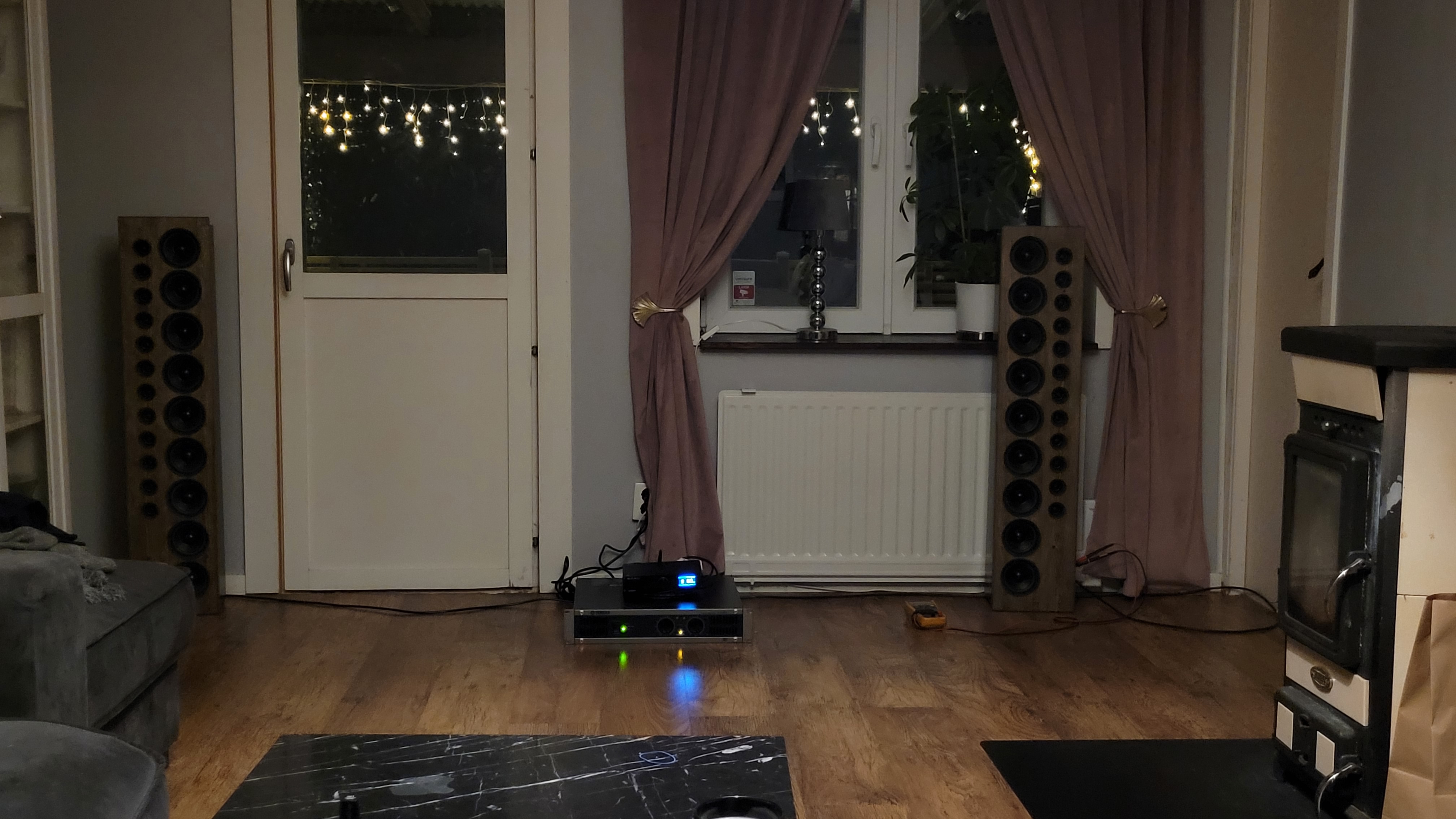

Re: TLAH sound
I placed the speakers in my small livingroom thats 20m², far from optimal placement, but thought okay, lets give it a try.
Using SMSL DO200 DAC to a Yamaha P2500S spare poweramp. (YS Processing was off when i did the measurements) no eq or anything, same voltage level in all the frequencies.
So i started playing sine waves at 1.5v (my ears did not like any stronger) and sitting at the same place, around 4m away from the speakers, used my hand hold spl meter, not a correct way but its something atleast.
I noticed that the peaks and valleys where about the same amplitude but just moved slightly in the SPL range when i moved position. So i did only one positioning.
My hand written chart shows deep (15dB) valleys and peaks, thats from the room, nothing strange. The peaks and valleys change place and spl as i move the meter, pretty obvious.
I took 10hz steps from 60-400hz where i thought the problem was, then 50hz steps to 1k and then 1k steps and so on..
Wherever i listened the 300hz range was way more sensitive, the rest of the "measured" peaks/valleys was not as noticable as the 270hz valley and the 300hz peak. Pretty much the only spot i would like to change, and thats easy with an eq, but not sure if i could do something to it with the filters?
Nothing will be done yet before i could do a real measurement in a correct way.
However, when i was finished with the sine waves and i played music and started to write down the chart. I had a hard time writing because i was amazed how good the speakers sounded. ALOT warmer and better sounding with even more bass.
Did i judge it way to soon before drivers even got the first hour brake in? Did something else change, or it it only my ears that tricked me? I dont know but with just a little bit of eq i could solve this.

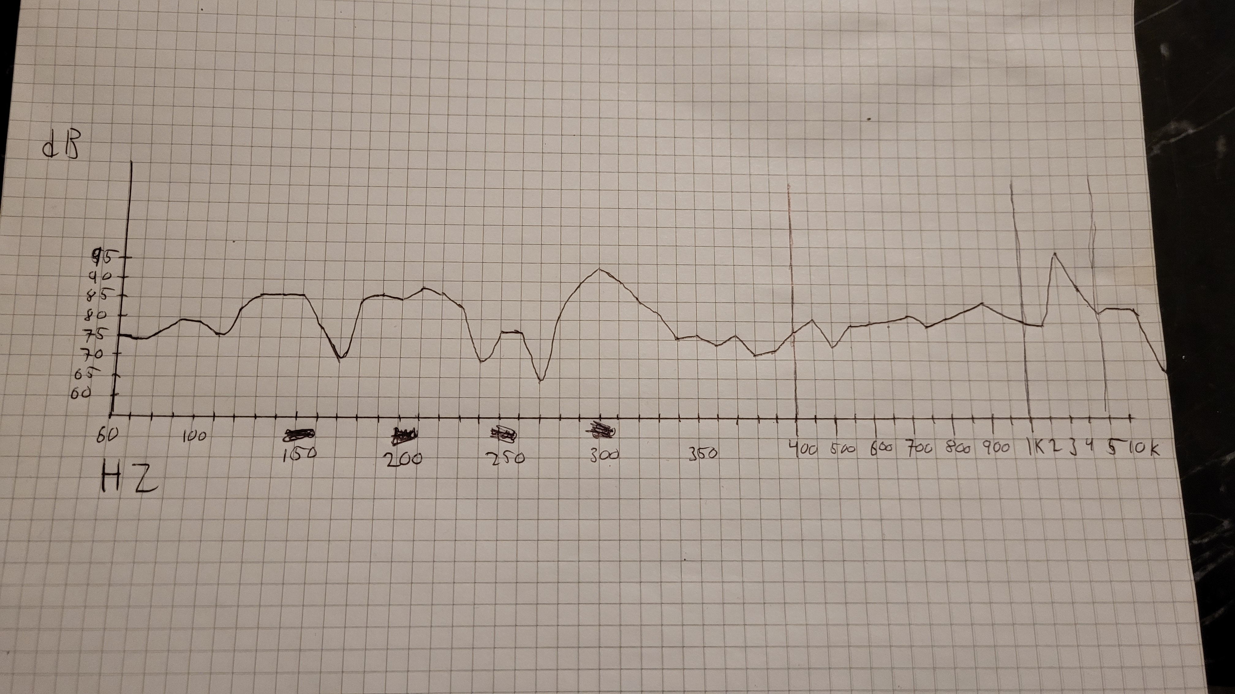

Well here is the result
The 3k peak should be at 94dB not 97... sorry

- Posts: 29105
Re: TLAH sound
Before break in the suspension and spider are stiff, so Fs is higher than after they break in. The peaks and valleys are room sourced. My chart doesn't have them because I measured mine outdoors. Mic/listening position makes a world of difference as well: http://ethanwiner.com/believe.html

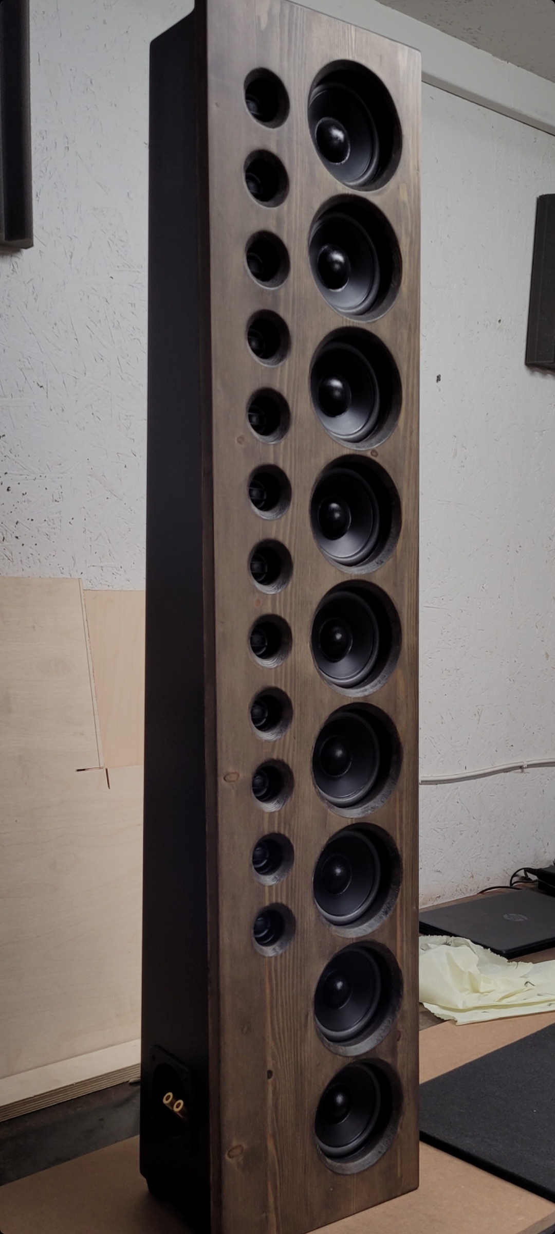

Keryn O'Shea
- Posts: 648
Re: TLAH sound
Which species of timber is that Linus, and is it a stained finish? The colour is so nice.. also backmounting drivers to me looks much cleaner, more work but worth it.
Imagine how amazing the sound is going to be with a proper bottom end... you could drag in one of your T60s
