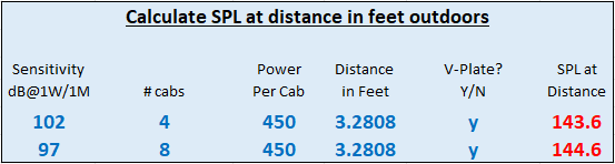

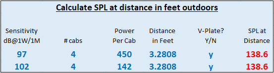

So I'm assuming the 24" cab, at 40hz has 97db of sensitivity, if I'm reading the graph right. Plus 26db for the 100w and the 2x doubling to 400w, or 123db total with the last 50w being fairly negligable.
the 36" hitting 122db with the first 100w and 125db at 200.
Screenshot (204).png (10.61 KiB) Viewed 2918 times
8 24"s would be 1db louder than 4x36"s
Screenshot (205).png (10.44 KiB) Viewed 2918 times
I will play with Grants numbers some as well
Grant's figures and methodology is solid too. It's good to have a couple different perspectives, a couple different ways to approach a thought process, so I'm glad he took the time to share his. One may speak to you or relate better to the way your mind works more than the other. They're essentially the same thing, though. Use whichever :thumbsup:

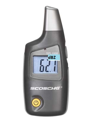

So, now you have the tools to compare any cab that has a 1w/1M sensitivity trace. With an inexpensive dB meter or even a free cell phone app (close enough for this simple stuff. Make sure it's dBC and not dBA, some apps offer the choice of either), you can also measure what you're currently using and get an idea what you may gain with a Tuba or Titan. Play a 40Hz sinewave through your system with the speaker disconnected, measure with a digital multimeter, and adjust the volume until the amplifier output voltage reads as close to 2.83v as possible. Plug the speaker in and use the dB meter, laying on the ground at 39" from your sub (use just one sub), and measure the output. Add 3 dB to whatever the reading is (dBC is down 3dB from dBZ at 40Hz) and that's your subs 40Hz sensitivity (assuming they're 8Ω drivers. If they're 4Ω drivers, set the voltage to 2.0v). Now turn up the volume until the meter reads 99. That will be how loud to expect a single 36" T48 to be on 2.83v. I'm gonna take a wild guess and say you're probably gonna get somewhere around 85dB with what you have now. Could be wrong though. It's been known to happen from time to time. :)
Here's the different decibel scales/weightings...
A meter that reads dBZ would be ideal for audio work. However, for some reason unknown to me, they're rare and expensive. A meter that reads in dBC is close enough for amateur level stuff.

I can see that being the case for laboratory grade equipment. But, it seems like it would be fairly simple and inexpensive to electronically calibrate a dBZ curve (no curve) into a unit, like they already do with dBA and dBC meters. Even if it didn't go all the way down to 10Hz. Maybe I should call China and have some made. It would be the only one available without a sticker shock for the whole of the audio community.

Still it would be nice to have a handy little standalone handheld unit that measures in dBZ. The one I have (same one I posted a link to) reads in dBC and is fine for what I use it for, mostly level matching subs and tops. So, it doesn't really matter what it reads in. Still though...
I'd buy one
