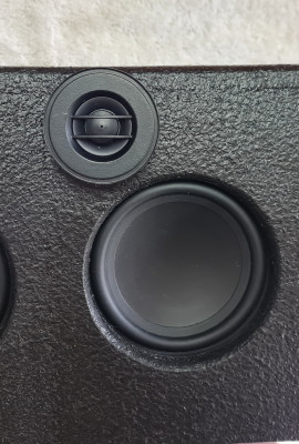

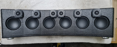

There's not quite, but just enough room for this arrangement, once l grind the frames partially or off completely. Am l asking for trouble this way?

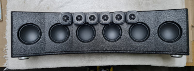

Only just misses the driver frame, and poking out the top..

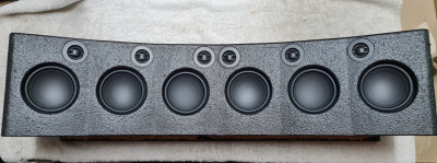

Heaps of room.. :?

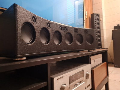

I don't know how the baffle didn't break between the middle two, just need to make the filters, and away we go, cheers
Posts: 3128
Re: Curvearray questions
#20 Post by Seth »
That came out really nice. Great job Keryn :thumbsup:

Agreed! Excellent craftsmanship. They look right at home.

Looks good!

Looks good. What's the verdict on how it sounds?

Like others said you did an excellent job on adding those to the existing cabinet.
I had to look twice just to see if it was a photoshopped layout.

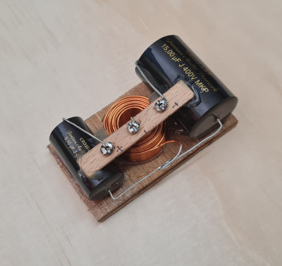

Cheers for the high praise! The filter components showed up today, l hope to have time this weekend to build, fit & fire them up. I ordered the coils all in 24awg, but they all look different wire sizes.. wth?

The top two are 21 gauge, and the bottom one is 18 gauge (I looked up the part numbers).

Tom Smit wrote: Thu Oct 27, 2022 9:56 pm The top two are 21 gauge, and the bottom one is 18 gauge (I looked up the part numbers).
Roger, who knows what went on there, thanks Tom.

Sounds great man! I feel the Jaycar filter components must've been average, anything I've refitted with Jantzen has always been noticeably better SQ. Also one thing l noticed mucking around with this cab is the adhesive has bulged a little under the paint, which is annoying. I think it was a "Soudal" branded one a house builder suggested.
