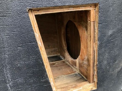

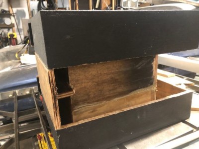

First thing was to split the box in half, almost. I did have one brace on the opening, so I made sure the table saw blade missed it by offsetting the fence so I just missed the brace. So one half box was 4" wide, the other 4.5" wide. Since my table saw blade will only raise about 4", I cut all 4 sides of the box, then used a big handsaw to complete the cut. The handsaw is skinnier than the table saw blade, so after the box was split apart. I used a straight edge and a Japanese finish hand saw to cut the inside edges to match the outside edges that were cut with the table saw. Then I planed the edges with some 80 grit sandpaper glued to a 3/4" of melamine to get the edges flat.
Next step was to fill the old 6" diam. half hole, where the W6 was mounted. What I did not want to do is try to cut the 7.1" diam. hole for the DCS-205-4 inside the box. I traces the opening of the 6" diam. semicircle onto a piece of plywood. Then cut it out, then placed it in the box, so I could trace the new speaker opening. I then cut out panel 2, out of the 5.5" strip, and held it in place where it would go. Then traced a 7.1" diameter compass to scribe panel #2 and the semi-circle plug. I then cut out the new opening on the plug, and panel 2 (which became panels 2A and 2B). Once I had the plug scribed. I cut out the new speaker opening. Then I duplicated this piece for the top side of the box. I then glued this piece into the box halves. So, this was a win in the fact, that I could cut the opening in the pieces and not have to try to cut out the opening inside the box.

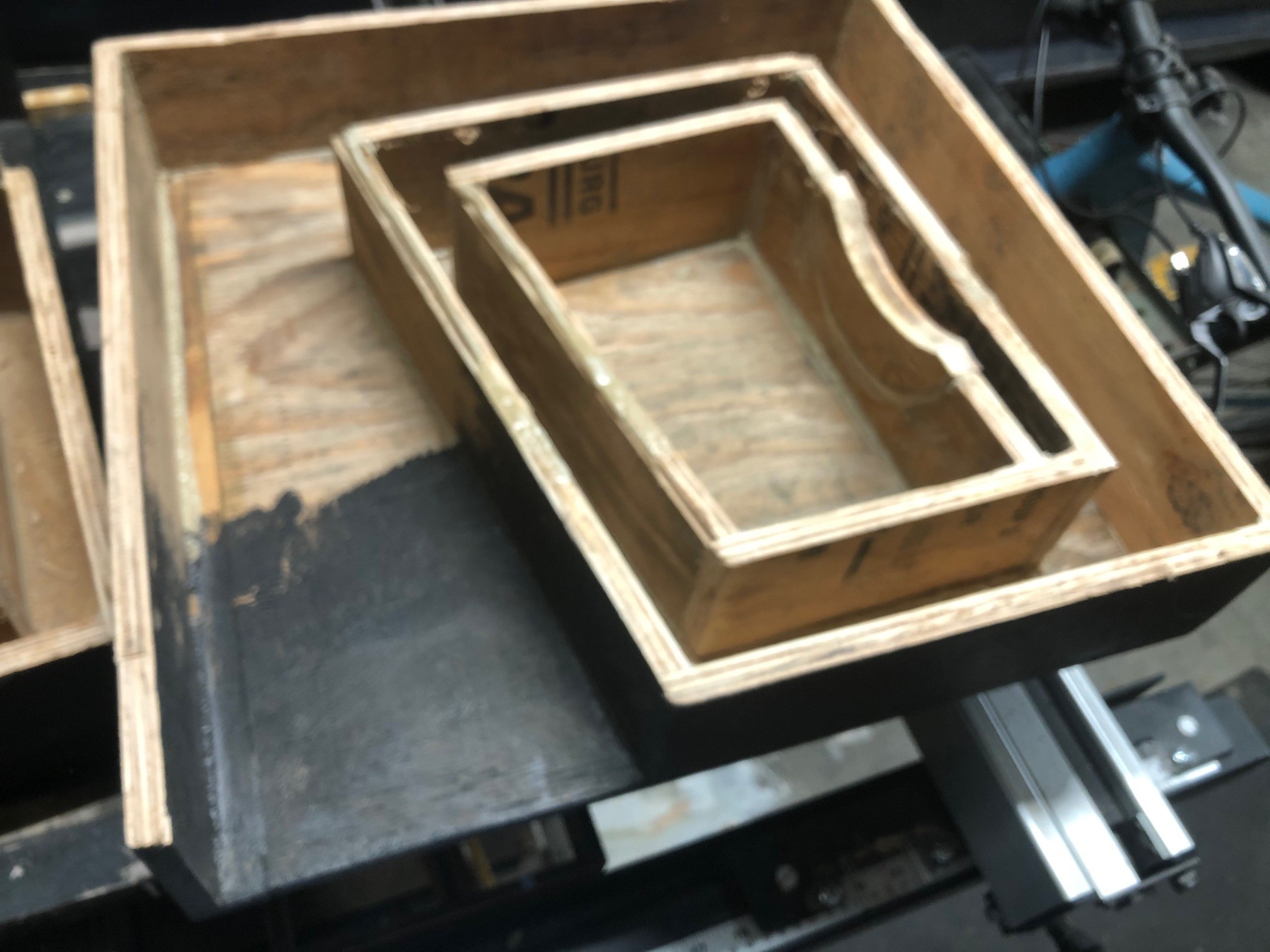

So decisions have to be made. I could widen this box two ways.
1. I extend the 5.5" width pieces on one side, starting from panels 2A, 2B, 3... to section 12. Then the braces. Just like you build the box in the plans. Then when those dry, I just glue the other 4" half of the box onto the top.
2. Or I extend just the 5.5" wide sections 2A, 2B, 3, 4, and 5. Then glue the 4" half of the box to that, then continue panels 6, through 12 and all the braces.
Well I did option #2, just because when I glued in 2A, 2B, 3, and 4; I could already see that I was going to have some alignment issues with some warpage. By the time I completed all of the 5.5" sections these were not going to mate perfectly with the 4" half box. The most import panels are the panels 5 and 6 pieces and joints. If these are not air tight, you will not know it since you can't see them from the outside of the box or inside of the speaker chamber.
I glued 2A, 2B, 3, and 4 then the top 4" half of the box. Then let them dry. Then touched up the joints with more PL3. There were some gaps. Then I glued panel 5. I used a ton ofPL3.
Remember my panel 2- the 5.5" wide expansion piece is now two pieces (2A and 2B) since the speaker 7" diam. cut out goes all the way through. So Panel 2 is now really in four pieces. The two half moon slivers, then the two 5.5" wide expansion pieces. I could see that these were not completely lined up perfect inside the chamber. More on that later.
So, panels 6 through 12 are just glued in the same order as the plans and the corresponding brace is added. Care was needed to try to get the 5.5" expansion piece lined up as best as possible.

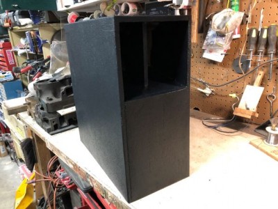

So all the panels are glued and braces in. I made another brace to match the existing large exposed brace on panel 12/7.

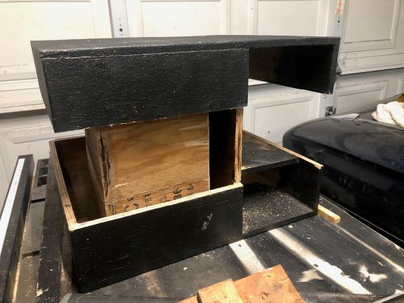

Now here is the problem, with Panel 2 now four separate pieces glued together, but not at the same time there is some misalignment, but not horrible.
I was able to use my Japanese flush cut saw to smooth it out until it was all one plane with no steps. The hole is approximately what I need 7.1" diam. I used my sanding board to smooth the dried PL3 so it would take a gasket well.

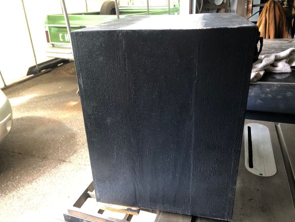

Now, on to the refinish. I filled in all gaps with PL3 on the outside and sanded it down. The plywood is pretty rough, it was when I built it originally. The ExoHyde covers pretty well.
With one touch up coat, it wasn't too bad. I wasn't worried too much about cosmetics, since this will find home in my trunk.
With two coats completed.

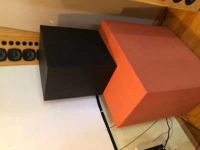

The speaker was not broken in at all, and the caulk wasn't fully cured, but I set the T18 on top of my TT and let her rip at 1/4 power.

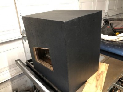

This sounded great. I am really impressed that this 13.5" T18 has almost the output of my TT using the same driver. The finish is acceptable. Up close you can tell there is a 5.5" strip going around the box, but the ExoHyde hides it pretty well. A few more coats of the ExoHyde and you would probably never see that the box was grafted together.
