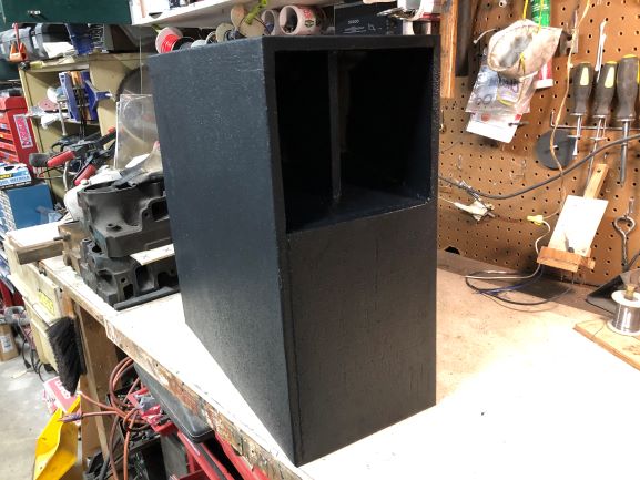

I built a T18 a year ago powered by a Tang W6 6.5" sub. I got the sub on clearance for cheap. I did a search on the forum and it appears it will work in a T18, but the output will be diminished due to the lower Vas, which is less than the required Vas per the plans. The rest of the specs are good. The box was built as narrow as possible, so 8.5"
The box finished out well, I used the ExoHyde coating which is super easy to apply and is tough. I like this product. It is almost a gel out of the can. No drips, no smell, dries in minutes for recoat. Super easy cleanup with water, if you are quick, it will even wash off your hands.

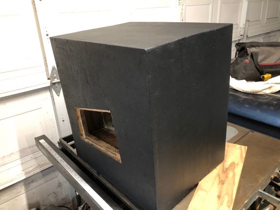

First thing was to split the box in half, almost. I did have one brace on the opening, so I made sure the table saw blade missed it by offsetting the fence so I just missed the brace. So one half box was 4" wide, the other 4.5" wide. Since my table saw blade will only raise about 4", I cut all 4 sides of the box, then used a big handsaw to complete the cut. The handsaw is skinnier than the table saw blade, so after the box was split apart. I used a straight edge and a Japanese finish hand saw to cut the inside edges to match the outside edges that were cut with the table saw. Then I planed the edges with some 80 grit sandpaper glued to a 3/4" of melamine to get the edges flat.
Next step was to fill the old 6" diam. half hole, where the W6 was mounted. What I did not want to do is try to cut the 7.1" diam. hole for the DCS-205-4 inside the box. I traces the opening of the 6" diam. semicircle onto a piece of plywood. Then cut it out, then placed it in the box, so I could trace the new speaker opening. I then cut out panel 2, out of the 5.5" strip, and held it in place where it would go. Then traced a 7.1" diameter compass to scribe panel #2 and the semi-circle plug. I then cut out the new opening on the plug, and panel 2 (which became panels 2A and 2B). Once I had the plug scribed. I cut out the new speaker opening. Then I duplicated this piece for the top side of the box. I then glued this piece into the box halves. So, this was a win in the fact, that I could cut the opening in the pieces and not have to try to cut out the opening inside the box.
