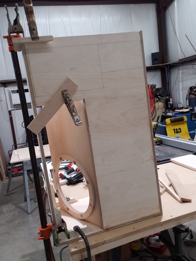

I got the woofer baffle glued in with the top and middle brace.

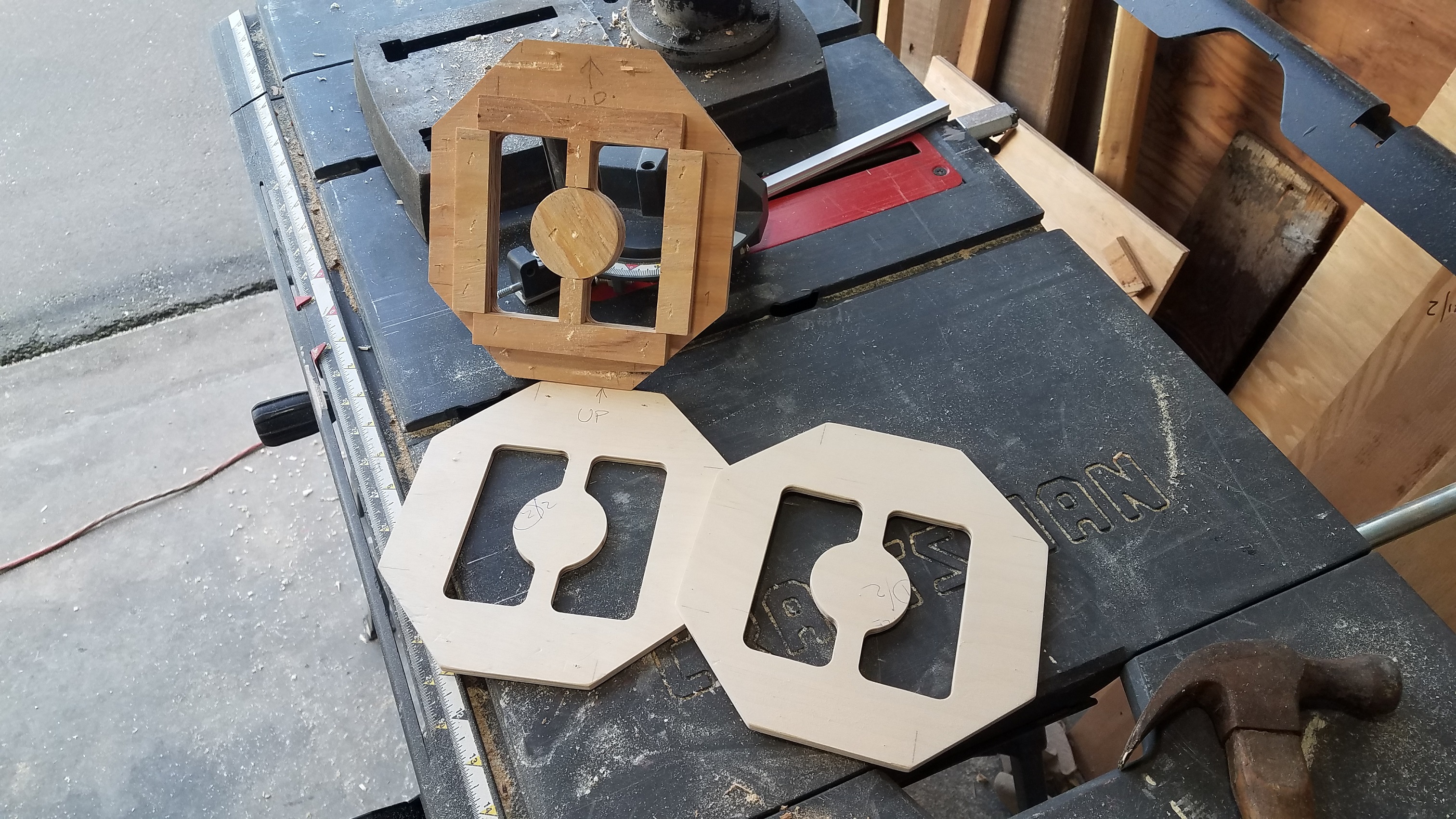

In a different build than I mentioned earlier, I made some baffle templates by drawing out the measurements on a piece of scrap that I intended to be my template, tacked down strips of cutoff material along the lines, then ran the router around the inner perimeter and cut out the template, which I used to cut all my actual parts identical.
If you place your tweeter face down on some scrap and tack some strips down creating a solid perimeter around the tweeter, you should be able to use that perimeter as your guide for your pattern bit to cut out a perfect size template. Remove the strips, laminate another layer of ply if you need to build thickness in your template, and use the hole you just cut out as the guide to duplicate the hole in the second layer, and on to a third if you need to.
Not sure that makes sense. Let me know if I need to elaborate.
Here's the baffle template I made, before and after routing. Shows how simple it is to just tack some sticks on.
If the corner radius of your tweeter doesn't match the resultant corner radius the pattern bit provides in the template, I suppose you could either sand the corners of the tweeter to match the recess or maybe daintily massage to corners of the recess a little sharper with a Dremel or chisel work. It may just be okay though.
