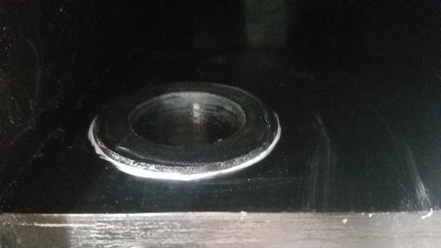

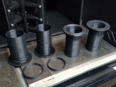

Some updates/finishing touches to the build.

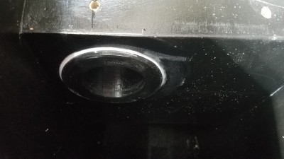

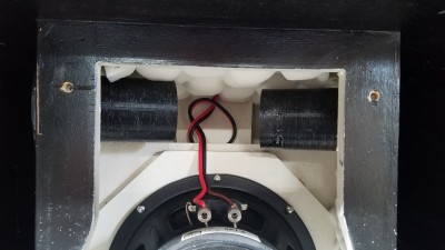

Since i have access to a 3D printer now, I printed my own 4" long 2" ID port tubes. I printed a small collar to glue on the insde. They were installed with silicone enhanced latex caulk, then the ABS collars glued on the back/inside with ABS plumbers pipe cement, also black in color, that i used on the Melded Array. Afterwards I painted the caulk black with another coat to my horn mouth.
Printed ports
Printed ports
Left port caulk
Left port caulk
Right port caulk
Right port caulk
Ports inside view
Ports inside view

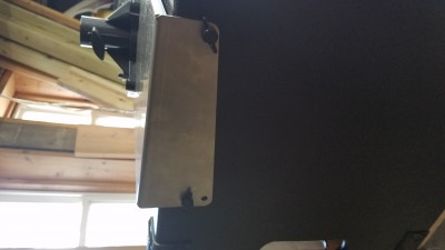

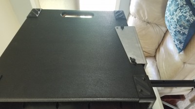

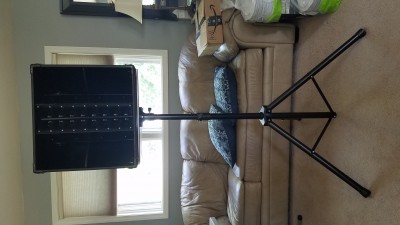

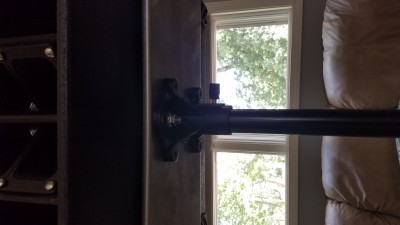

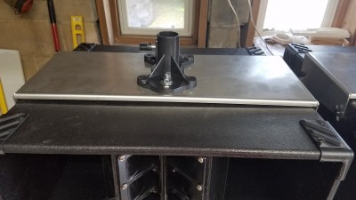

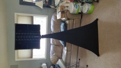

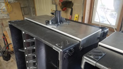

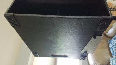

Since I have access to a fiber laser at work, and press brake, I was able to make a tripod mount bracket.
I was not finding a good hat that fit inside clearance-wise. I wanted that adjustable one, but they seem to be discontinued.
The plastic foot that came with my $60 budget tripods is a bit cheap, but i'll hold up until I find a better solution.
Left mounted
Left mounted
Mount
Mount
Right mounted
Right mounted
Tripod left
Tripod left
Tripod bottom
Tripod bottom
Tripod right
Tripod right
Tripod naked
Tripod naked
Tipod dressed
Tipod dressed
