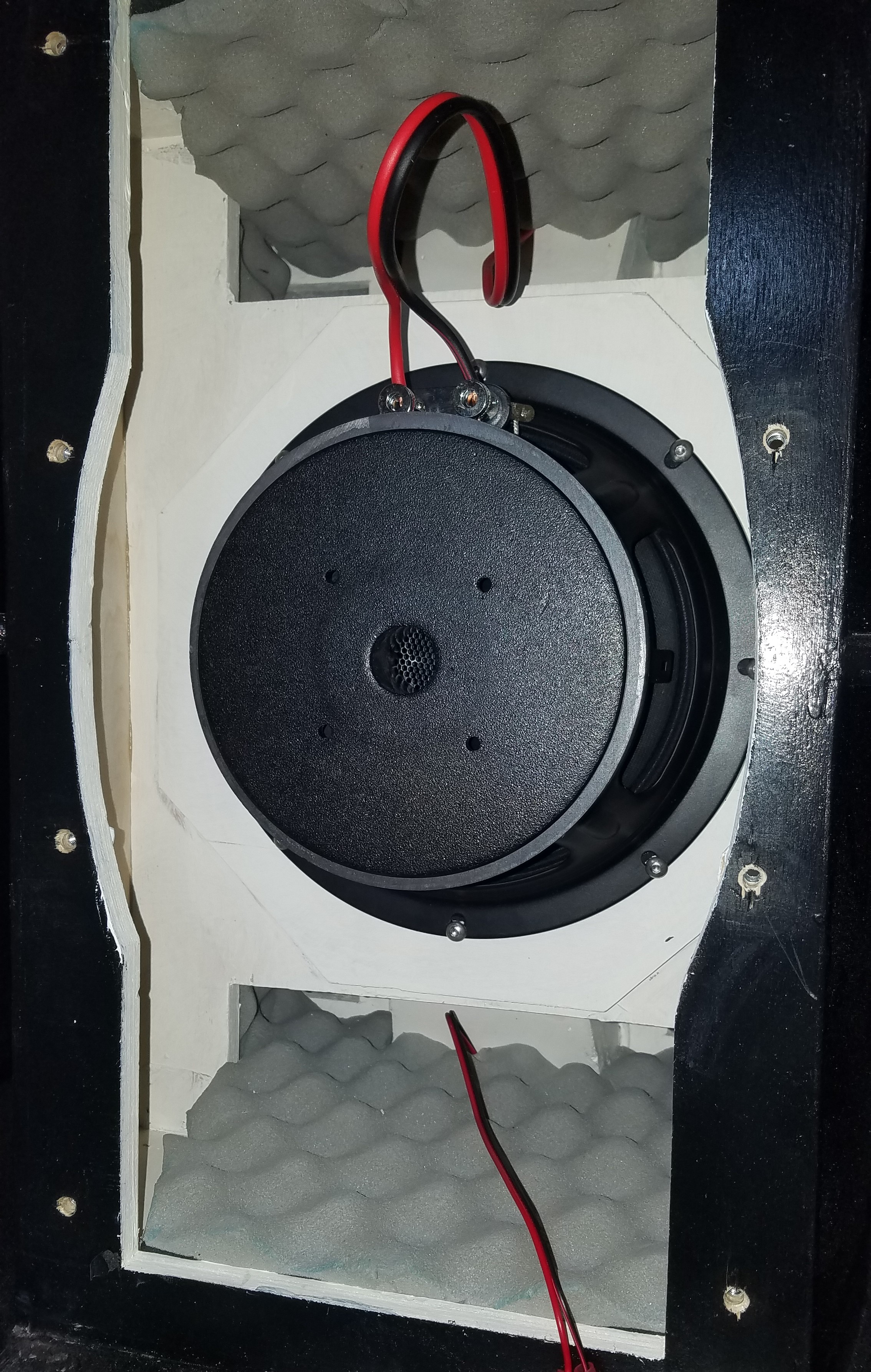

It's probably too dense and will over damp the cab.
Re: HowieZ DR200 build

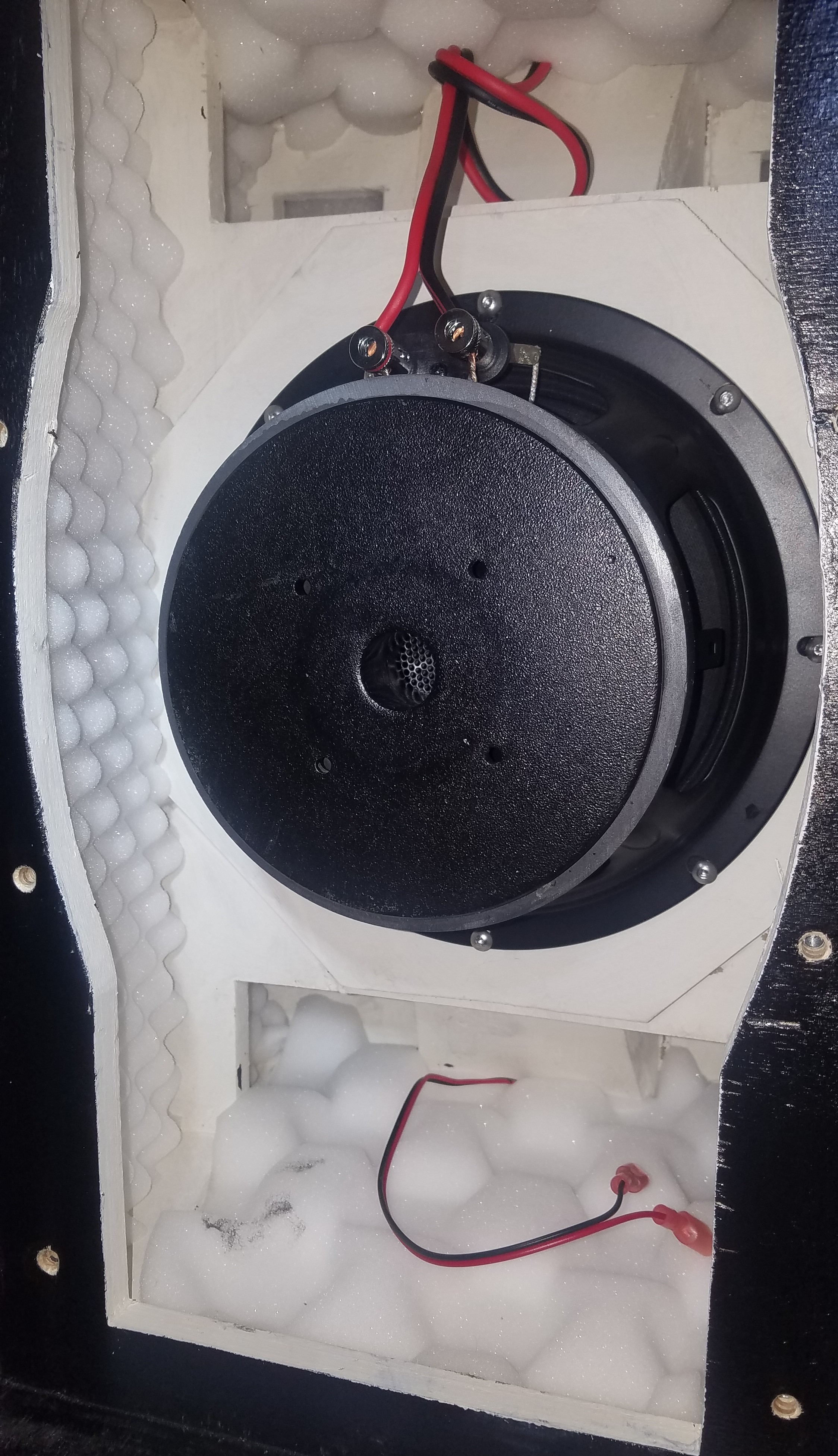

Well, this foam is too dense, but here is where I was last night before I discovered my module screws were a gasket too short to engage the T-nuts... Anyway it was looking good. listened a bit with module 'stuck' in place with my sticky foam gasket. I bought a mattress pad today to replace the pictured foam, but it's unravelling/expanding for a day.
Ok, I have new foam now, seems soft/open cell enough.
