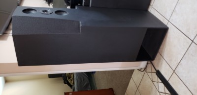

#7 Post by Strange Kevin »
If little legs are a "no go" when pointing the sub downwards,
Could we do something like the legs on the David's with a full sheet on the front and back, leaving the sides open.
I'm not sure how tall the opening would have to be, but It might be an option.

#8 Post by Bill Fitzmaurice »
If you block a section then it would have to be placed higher.
