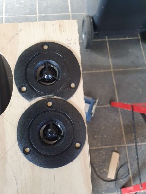

#17 Post by JensToft91 »
Ah damn. I thought the "1/2 inch voice coil" was the dome size. My tweeter is 1 inch. So pretty far from the plans, I hope it doesn't screw things up.
How would you mount the 4PF-8? I'm thinking about front-mouting then because it's easier - and want to make some grills for them anyway.
Does it make a difference?

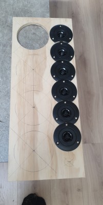

#18 Post by JensToft91 »

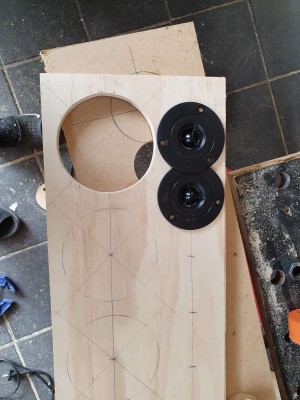

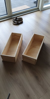

SLA is a bit simpler to build than the tubas.
Boxes dryfitted

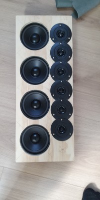

#19 Post by JensToft91 »
Drivers has arrived

I'm not sure the dome size will or won't negatively effect the sonic quality of your build. But, I would think if the frame size is still 2½" or less, you should be fine. We'll see what Bill has to say about the suitability of 1" tweeters instead of the recommended 3/8 to 1/2 inch variant. I'm curious too.
Posts: 28916
Re: A pair of SLAs... Perhaps..
1" tweeters won't have as wide dispersion as smaller units. The reason to use 1" is when they're crossed over fairly low, which you do with larger midbasses because they have narrower dispersion in their upper end than smaller midbasses. Other than with subs the reason to use a particular size driver is output capability versus dispersion, which is always a compromise.

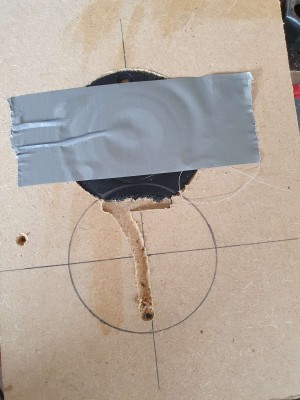

Read the instructions. Twice. And then one more time.
Then check the drivers you're buying. Then check them again.

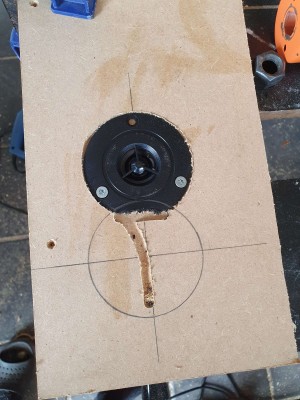

I'll probably be better at cutting them as I go along. First one is not pretty. I'll smooth it out with some acrylic filler. Wood filler, perhaps?

#24 Post by JensToft91 »
Not so pretty. But it'll work. Next challenge is to seal it properly.
#26 Post by Seth »
Good job Jens. I'm not sure my mind would have come up with that solution on its own. Very creative :thumbsup:
