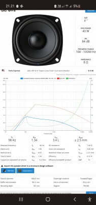

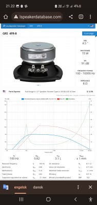

Thank you, Bill. Guess I'll take your word for it. Loudspeaker database seems to show quite the difference in sensitivity. I've attached screenshots of both.
I just don't want to save 20 euros to screw the build up.
But I won't screw it up, because you wouldn't be recommending it if it didn't work.
I'm going full budget
- Posts: 29087
Re: A pair of SLAs... Perhaps..
Their data is flawed, because modeling programs are only accurate up to about 200Hz. They also show results if mounted in a wall baffle, not enclosures of equal size. Worse, they measure one at 2.83v, one at 4.0 v. I don't know what that's all about, but it accounts for a 3dB difference.
