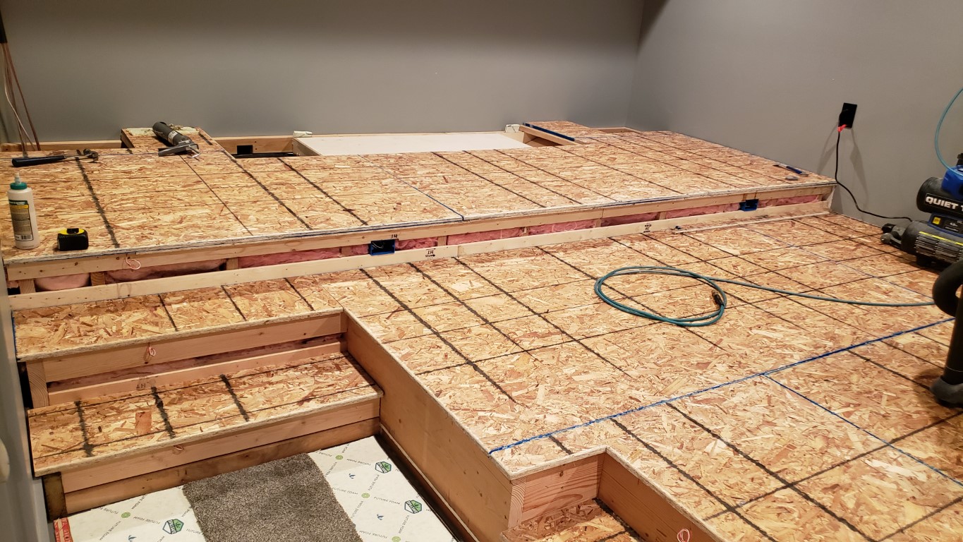

The theater rebuild is coming along. Cabinets are hung, no lacquer yet. I have the riser mostly finished. The first level is 14", second level is 21" - just enough to clear the THTLP. The first level is built with 2x6's spaced 16" oc and spanned 7.5 feet. Every joint and surface is glued with PL Premium. One layer of subfloor feels nice and solid, I really don't know why so many people insist on two and three layers of subfloor. At $76 per sheet I'm going to settle for one layer. I filled the whole thing with pink fiberglass insulation. When the THTLP really gets going there's quite a bit of tactile feel in the lower level of the riser (where the span is 7.5 feet). I guess I might not need butt kickers.
The cabinet doors are made for glass but I'm going to lacquer them black and put speaker fabric where the glass would normally go. The hole in the floor in each corner is going to be covered with basically a cloth covered frame (opposite the side wall) and a cabinet door with speaker fabric. The THTLP will get covered with a hatch door like a crawlspace. There will be a row of 4 theater rockers mounted on top of that hatch door.
