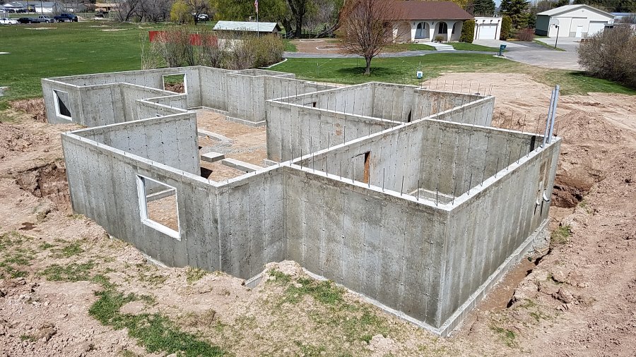

Hello all,
This will probably end up being a very long build thread but I'd like to get it started. I'm in the process of building a home and we went with a high wall in the garage which will be topped with hollow core concrete. I have two rooms - one is 22'x24' the other is 14'x24'. Those are rough dimensions so the finished room that will house the home theater will end up being right around 13'x23'. I already have two table tubas, a pair of TLAH's, and a curved SLA. I plan to add a Tuba HT (possibly two Tuba HT's). I think it would be ideal to put the Table Tubas in the front corners and Tuba HT's in the rear corners. The door to the room was placed in the center intentionally so I could place sub woofers in the corners.
Some Questions:
1- Being a 6 sided concrete box will the concrete hold the bass waves inside and cause issues with the sound? In my last house the bass traveled upstairs, outside, etc. I'm just not sure what to expect with it all boxed in.
2- I'd like to take advantage of the 9 foot ceiling and put a raised floor halfway through the room. If I put the Tuba HT's in the back corners on top of a wood floor will it cause issues with the sound? I'd most likely just glue some TGI's to the concrete with standard OSB sub floor on top and put a 6 inch step up to them.
3- Given the option to use part or all of the 22'x24' room should I be going that route instead? I've heard square (or close to square) rooms are not ideal but I could frame off whatever size I wanted. Drawback could be losing the concrete box.
Let me know what you think, I'd love some experienced advice on this build. I'll attach a picture, the garages are on the right 22x24 up front and 14x24 to the very right.
Some Questions:
Re: Under Garage Home Theater Build
I guess the answer to your "dilemma" is in the answer to the question "Is your current HT adequate enough that you though 14 x 24 would be fine?"
How high are you planing to build this platform?
It springs to mind that if the platform isn't solid enough to constitute it's own boundary, then the prime directive in the sub sticky comes into play.
ie the mouth cant be within 2 to 8 feet of a boundary without causing cancellation, in your case possible, the floor. Of course that thought becomes redundant if the presence of the corner eliminates it.
It also seems you have totally determined the best place the subs should be is in each corner.
Certainly, in terms of maximising output, yes.
What's your fall back plan if it turns out the best place for each sub is the middle of each wall?
Best sub placement is determined by measurement and experimentation.
Finally, I would think solid concrete walls will probably be the best thing to excite the room nodes/modes. Fall back plan if that's the case should be the statement just above...

He is using hollow-core precast concrete for the ceiling so essentially everything concrete.
Any air gaps would be the biggest source of noise transmission. That door and HVAC would be your biggest sources of sound transmission followed by any openings cut for wiring, plumbing, HVAC, ceiling joints, etc would all have to be meticulously filled in.
For the risers I'd stay it would have the same acoustical properties of a stage. I'd recommend joists on 8" centers if you want it vibration free, 3/4" subfloor, all glued and screwed. The glue is essential to prevent vibrations. Here is how I re-did our stage after adding some serious bass:
. It is solid now and worth the effort although at 8" centers, I couldn't peek my head down in between to run cable, was a little annoying but everything is glued shut now so no worries.
Being 6 sided concrete, interior sound absorption should be in the plans as well. Walls, ceiling, floors, the full gauntlet.
. It is solid now and worth the effort although at 8" centers, I couldn't peek my head down in between to run cable, was a little annoying but everything is glued shut now so no worries.Being 6 sided concrete, interior sound absorption should be in the plans as well. Walls, ceiling, floors, the full gauntlet.

You want a framed drywall finish, not bare concrete. Drapes over that as the finish is an option.
I think no drapes, just framed walls and ceiling covered in sheet rock. I'll probably do blown in cellulose insulation but I've had some people recommend spray foam insulation. I've seen some home theaters in basements lately where the steps in the floor were actually poured into the concrete. I'm not sure if having the people on the back couch see better is really worth all that money. Normally when we watch a movie we all fit on one couch anyway. Maybe the thing to do would be to build a platform just big enough for the couch and a step in front of it. Then it would be elevated without having to set the rear sub-woofer(s) on the wood platform.

Where concrete foundations are concerned the insulation should go on the outside, not the inside. That way the concrete acts as a thermal berm, keeping the house warmer in winter, cooler in summer. There should also be a layer of sheet urethane foam on the outside of the framing of the upper stories, to minimize heat loss through the studs.DJPhatman wrote: If the spray foam insulation is available, use it.
