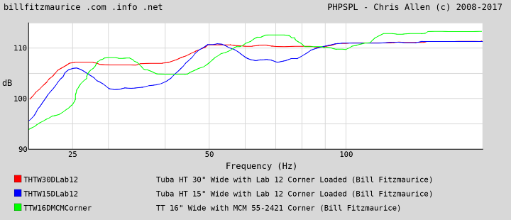

Just for reference. Min width 12" THT, Max width 12" THT, and a mid sized TT (not minimum like you've built)

I see what you mean. That it might not do what I want.
But on the other hand, a 12 inch can take more abuse than the 8 inch - right? I know the drivers act differently in a horn - and I haven't yet understood how.
My TT is pretty capable at 25 Hz - but I can* hear the ticking distortion, i linked to in a video in another post.
At 25 Hz the THT will be right at home - and then 20 Hz will maybe act as the TT does at 25 Hz, and being a 12 inch it can take more power at 20 hz, so chances of audible driver distortion is less.
Am I wrong in these assumptions?

Re: New GRS driver suitable for an ultra cheap THT?
I wasn't really making a point other than illustrating the difference. To me, it looks as though the THT should do what you want.

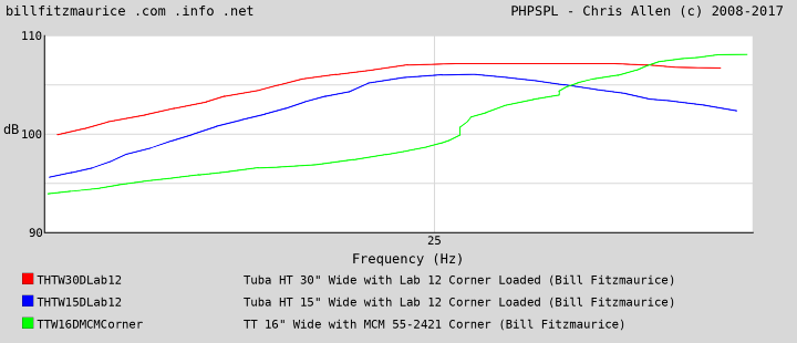

Here they are from 20-30Hz
Also keep in mind, the TT has a 4Ω driver, the two TT traces have a 6Ω driver, and the driver you're considering using is an 8Ω driver. Given 2.83 volt signal results in 2watts, 1.34watts, and 1watt.
