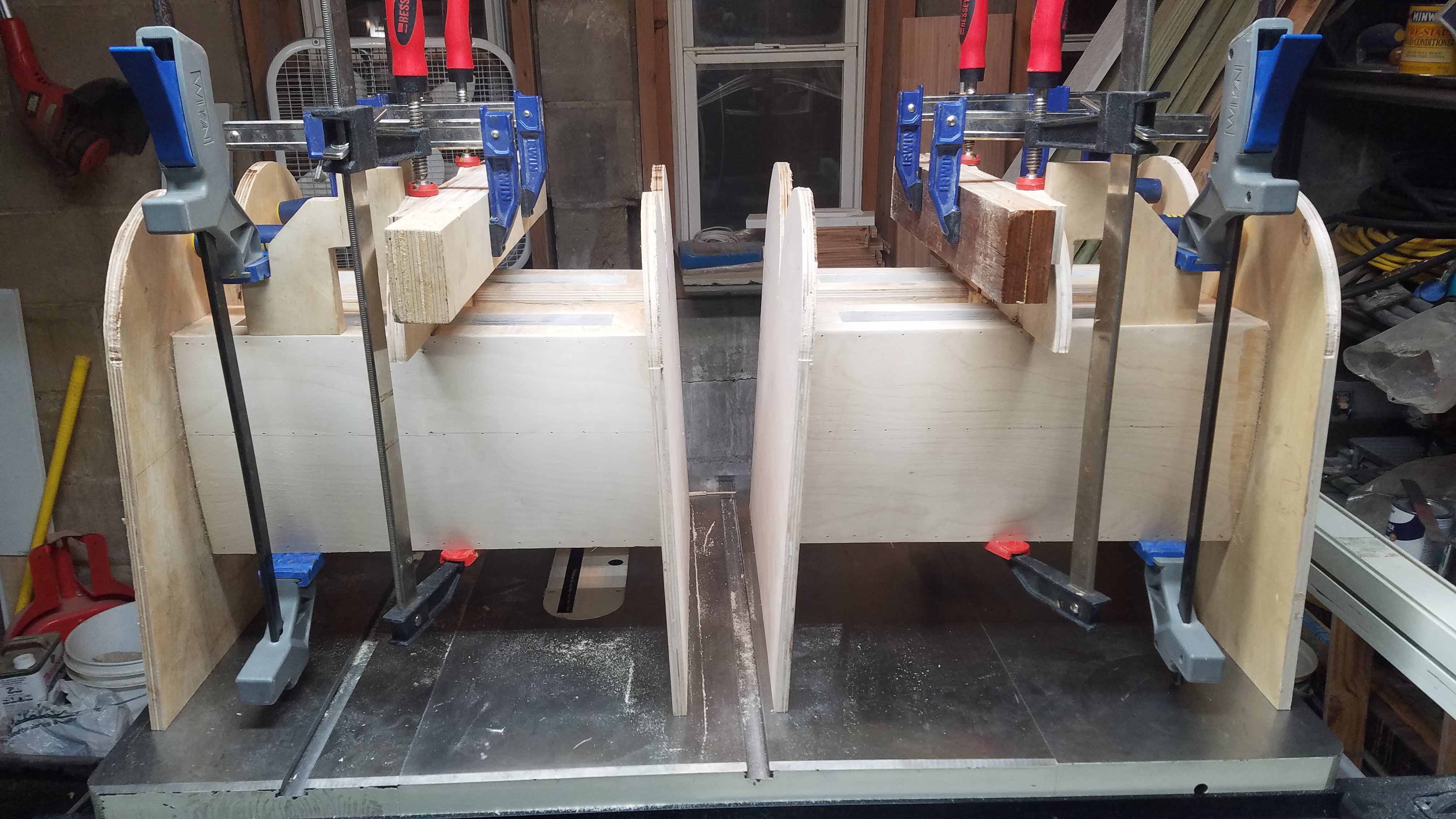

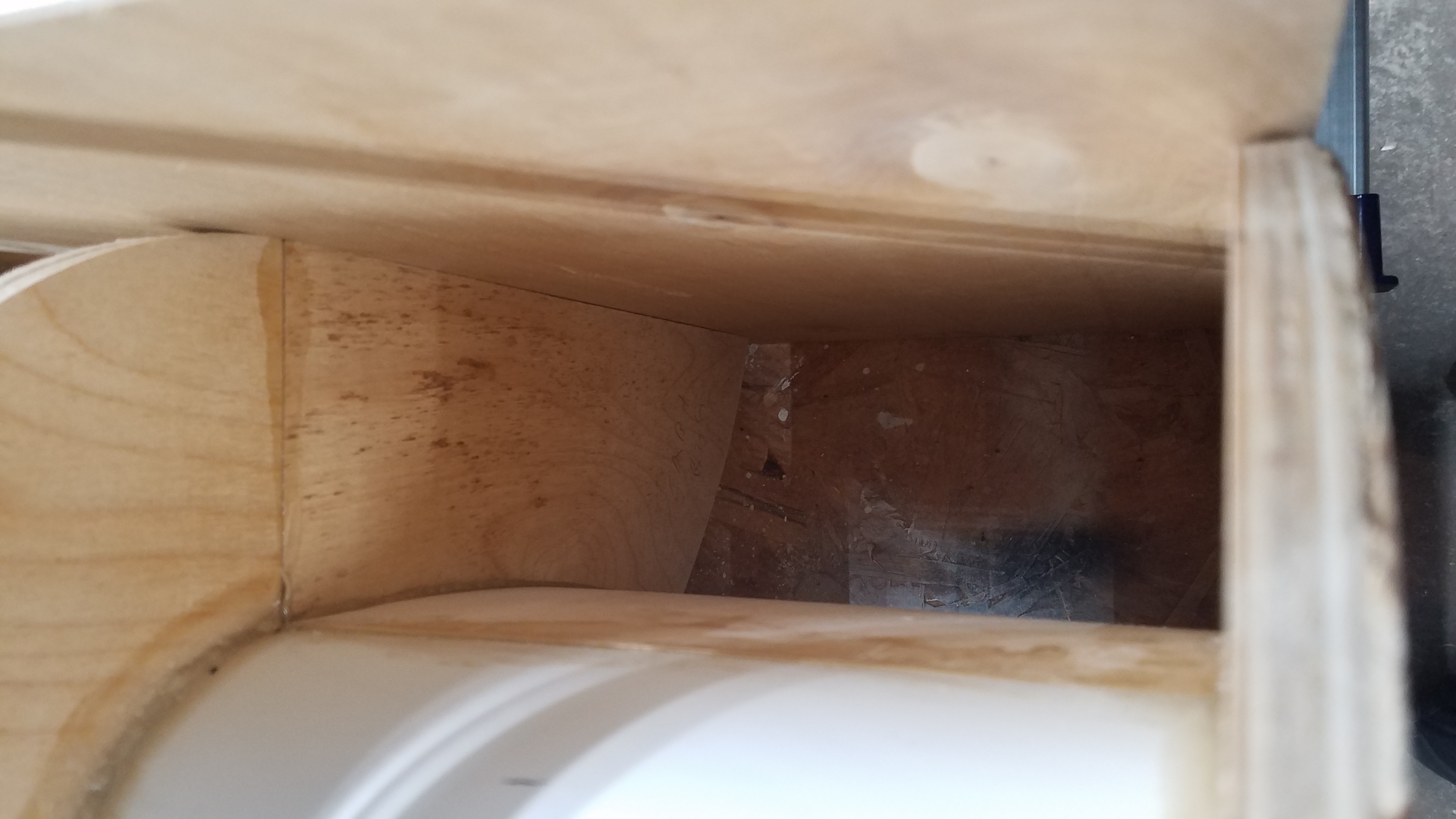

Well today I learned I should have glued the back braces on before the sheaths. I really wanted the sheaths a hair proud on each end to cut flush with my multi-tool. I sanded them up nice, then murdered the back braces on the first cab with my nail gun. I tried 3 lengths of nails. I just wanted a couple pins to hold them while I cut the reflectors and glued those in too. No dice, I had to clamp a flat across each pair to hold them flush, and then a 90 block to keep them plumb/square. Then I clamped the heck out of them every which way but loose. I musta shot 10 nails in the first pair trying to get them to stay tight. Nails coming out everywhere! I put all of 2 nails in the second pair and clamped them right away.
No way I'm getting in there in 2 hours to clean up my ooze. I'll have to suffer through that cured.

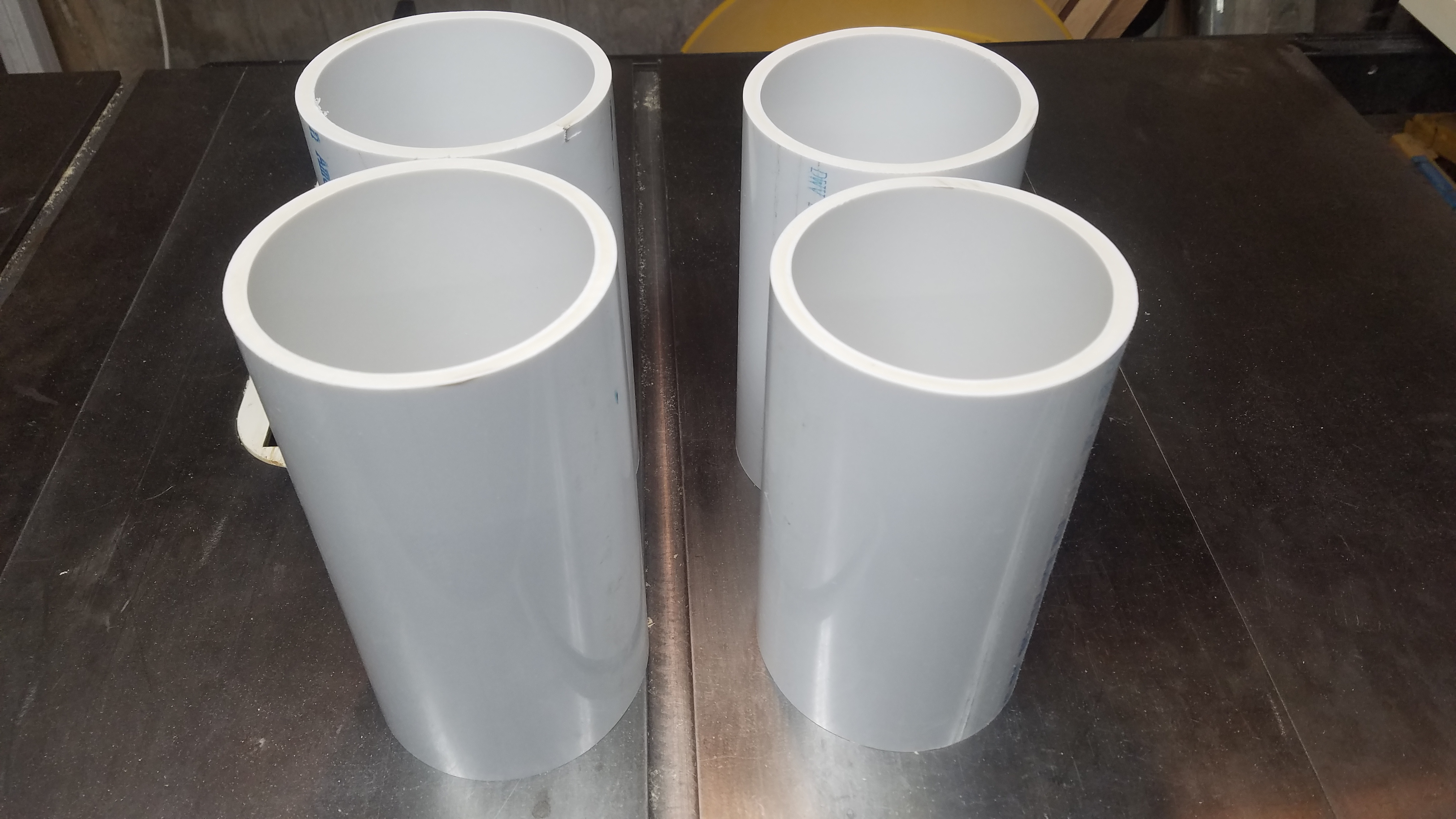

Then I started cutting the pipes to a bit oversize before I make some kinda jig to split them.

Finally back to the woodshop today. Too much going on all week. Or I was too peeved about the mess I made...

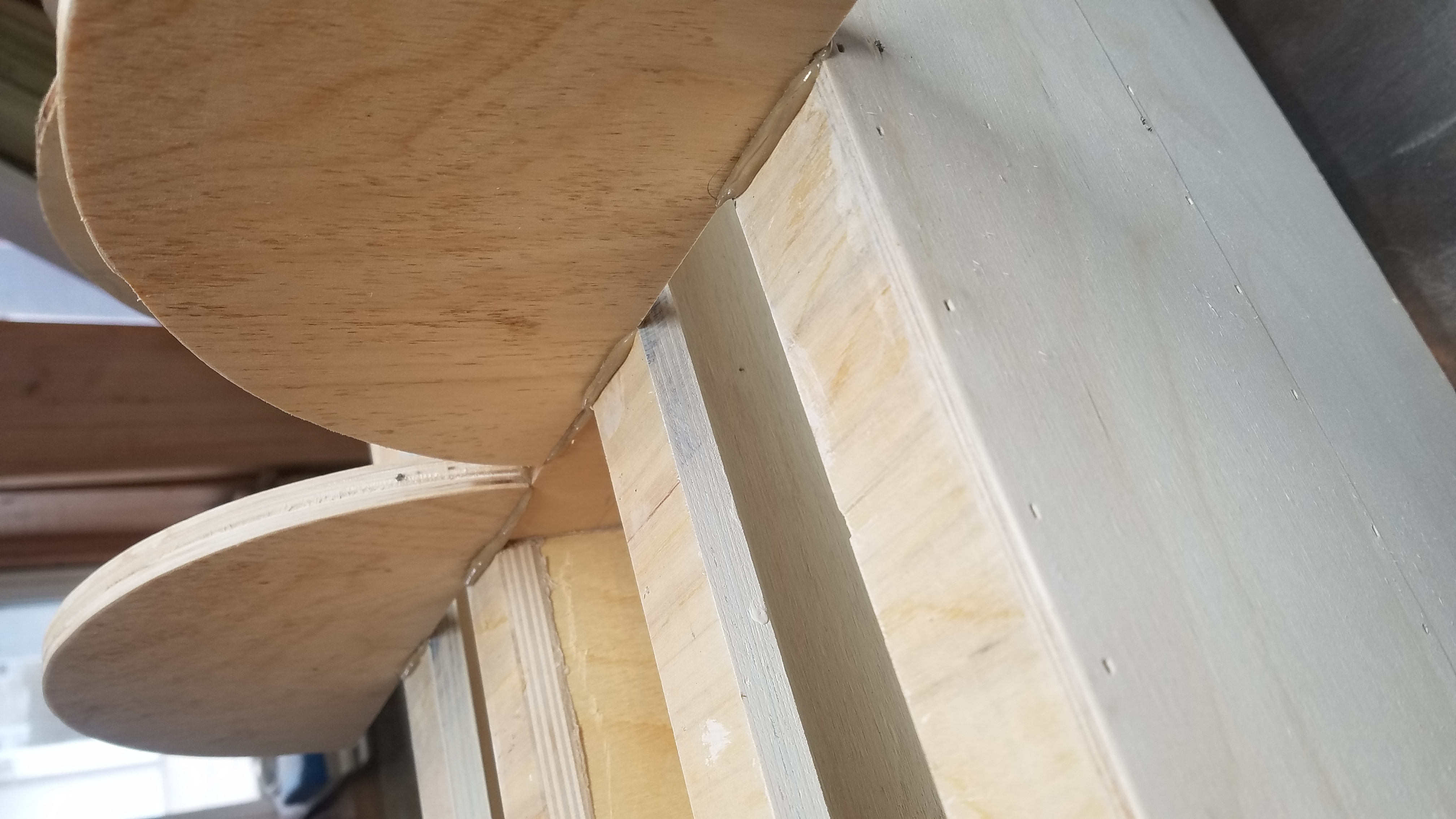

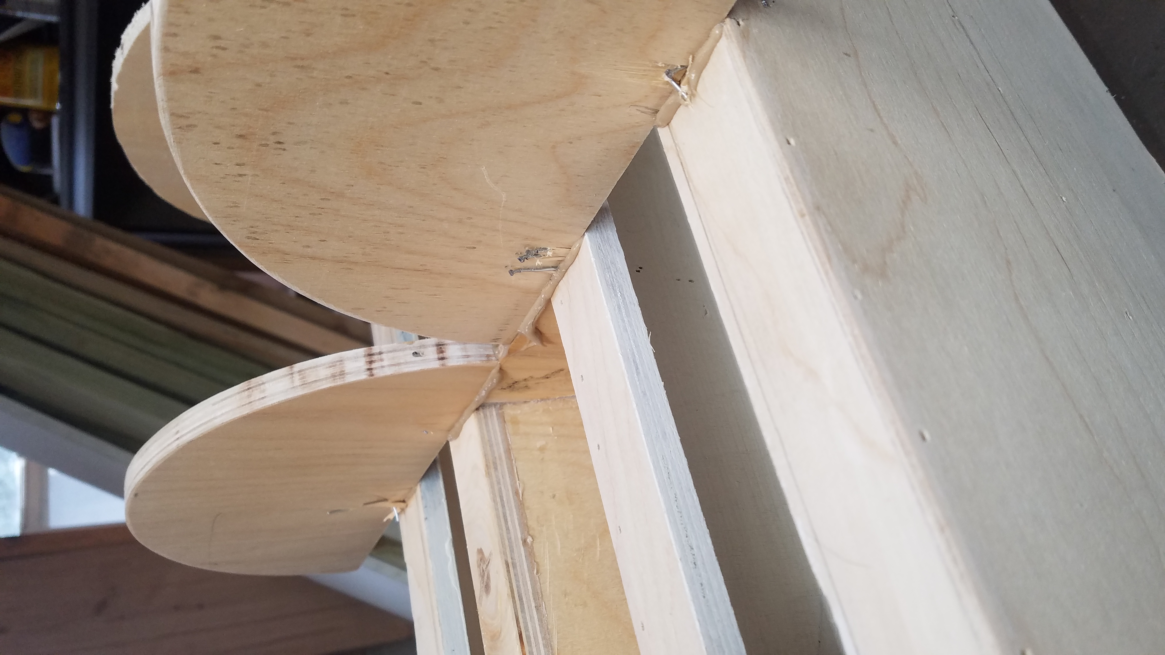

I scraped all the excess PL off the back braces. Cab 1 is splintered a bit from the million billion nails I attempted to shoot. Cab 2 is nice, no splinters, 2 nails each side.
I used my detail sander and orbital sander to clean up the back braces a bit after I c'sunk all the nail heads and cut off the ones shooting all over.

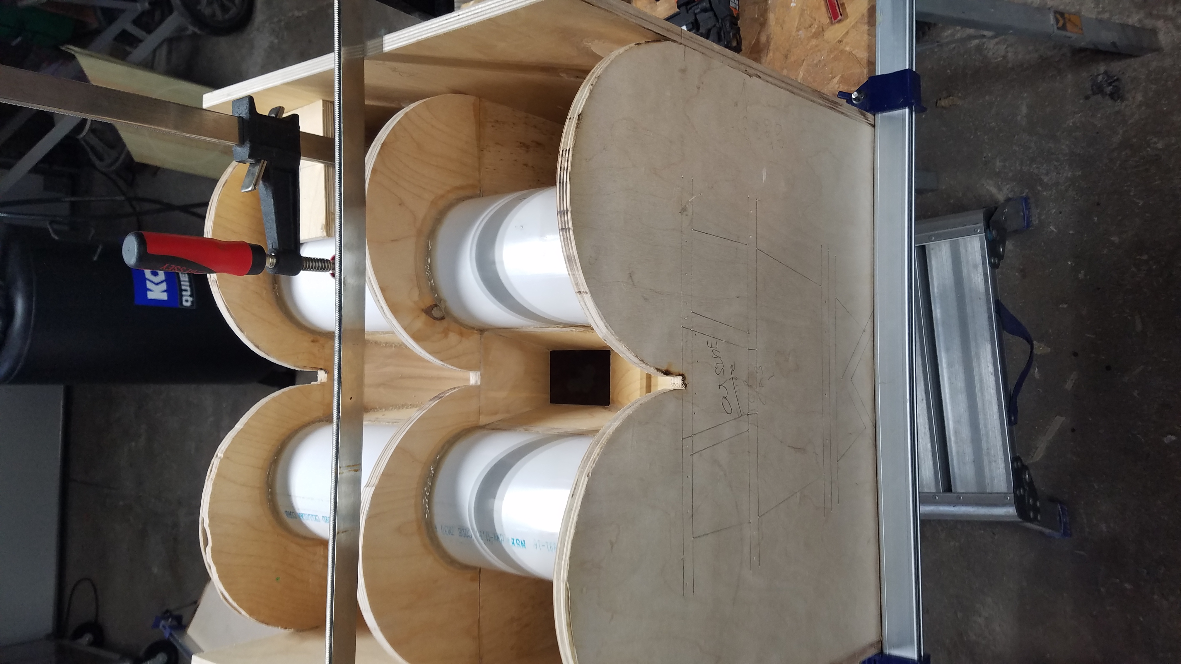

I'll have some pictures in the morning of the reflectors glued in. I also read in another thread about stuffing that reflector before assembly. I glued polyfil in the sides of the sheath near the reflectors and stuffed the reflectors before gluing them in. That was tough enough, so glad I didn't wait.

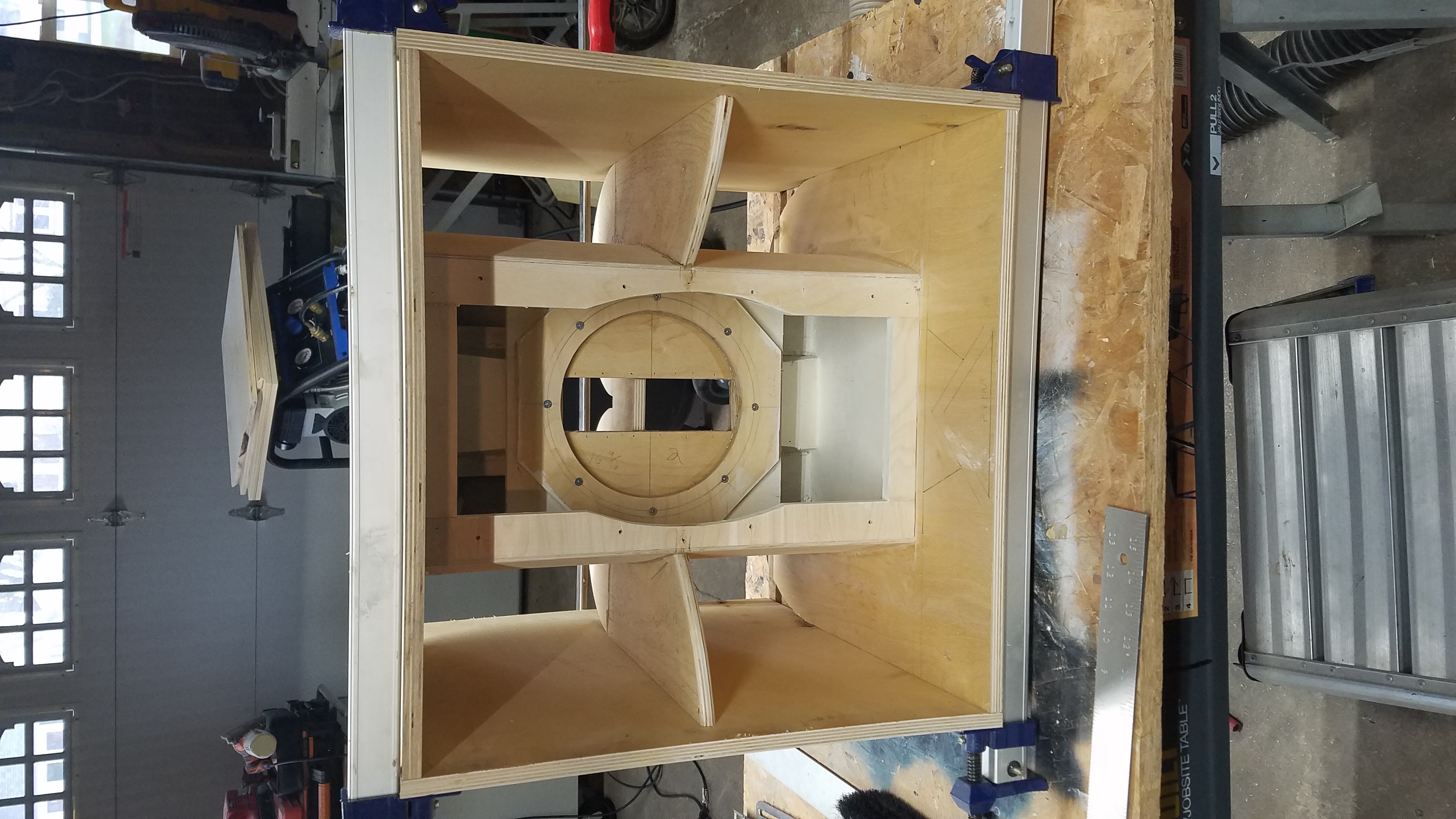

Well, small mishap overnight. I have to move my cabs in the house every night now becasue temp is getting below 60 in my attached garage after I turn heat off a few hours.
My son helped me cary the clamp monstrosity into the basement and one reflector shifted and was proud. I was worried about the seal so I cut it out with a multi tool and started over.
It's re-attached and held with a clamp while the side braces are nailed and glued on.
I had the side braces within about 1/4" of size, so I used the straight edge method from the plans to scribe a line. Each was belt sanded to match it's sheath, and cut down to correct final width. I put one nail in each end to hold it, and two staples from inside the sheath into each. Then I leaned the sided on and clamped to hold them while curing.
