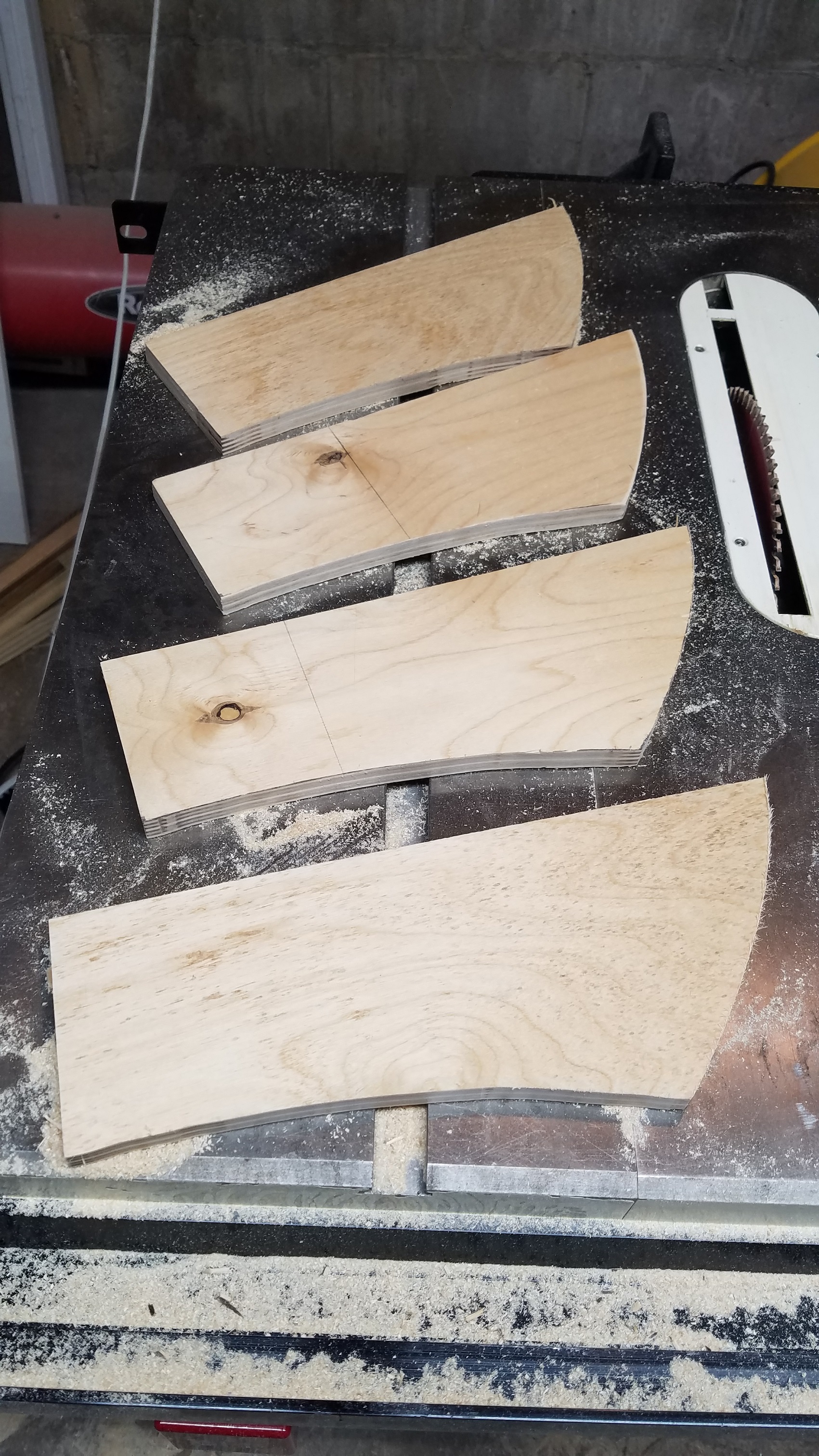

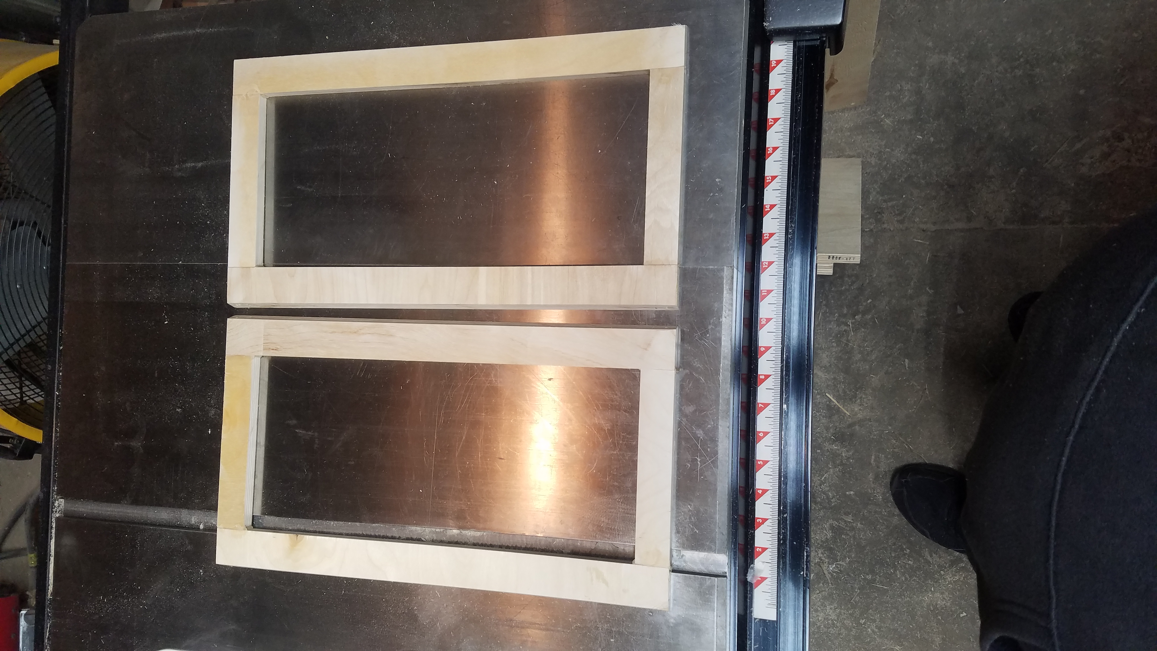

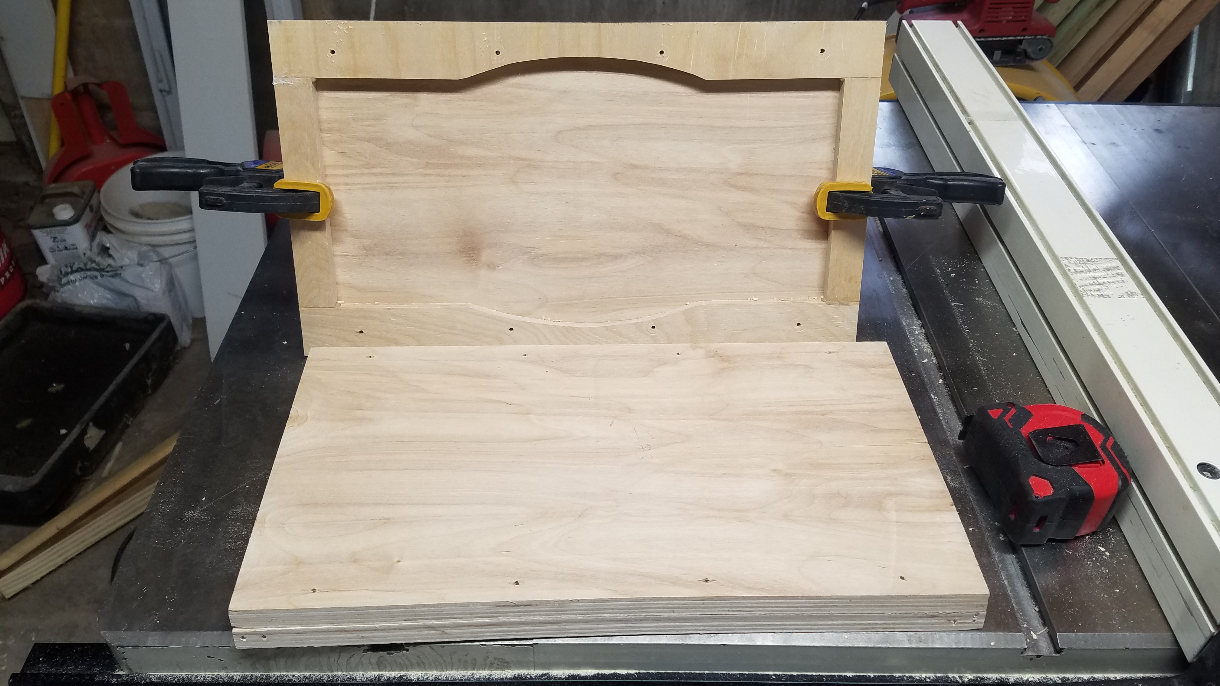

I was able to get my sheath braces/frames glued up yesterday. I left them a little long and I tapered them to size afterwards.
Then I cut my module backs and lined them up for size/taper and match marked some holes. Hope I can get those nacelles easily...

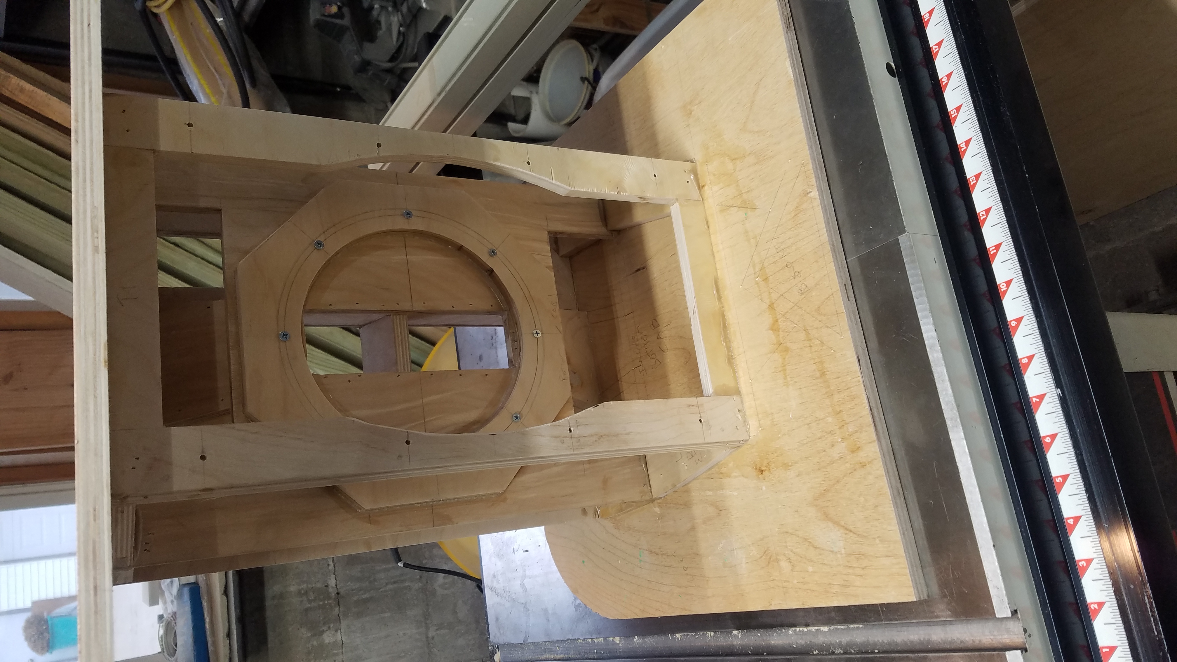

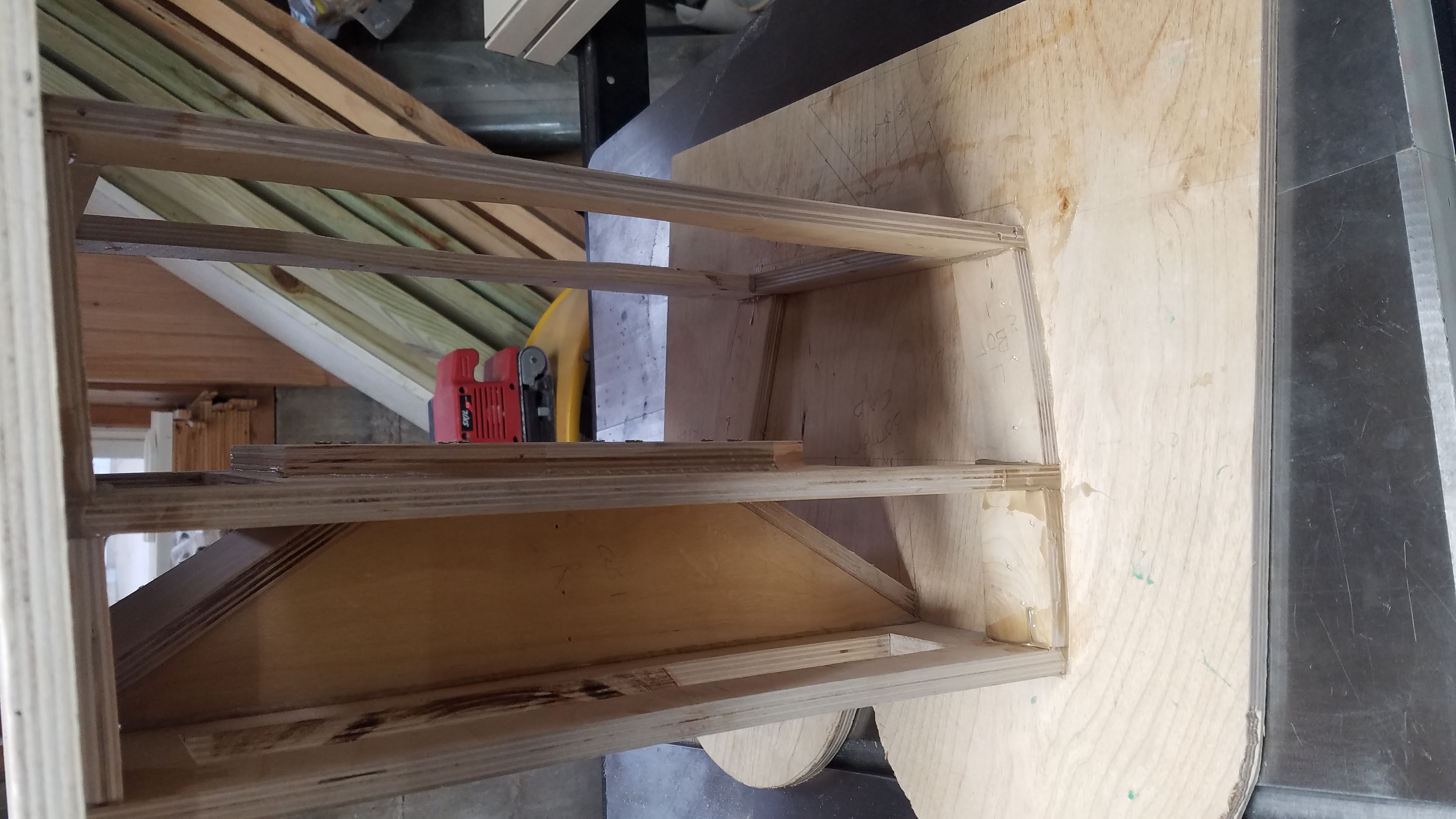

I spent most of this morning cutting sheath cleats. I tried to taper all the ends 3 degrees, and make left/right ones, top/bottom. I swear I have 2 left feet. I labelled them all bottom right, top left, those match, and bottom left, top right etc. I still struggled getting them to fit. I have PL EVERYWHERE. I may as well have glazed the whole cab like pottery. I hope it all works in the end. I'll have to cover my work with lots of paint, oh wait, nobody will see the inside right?

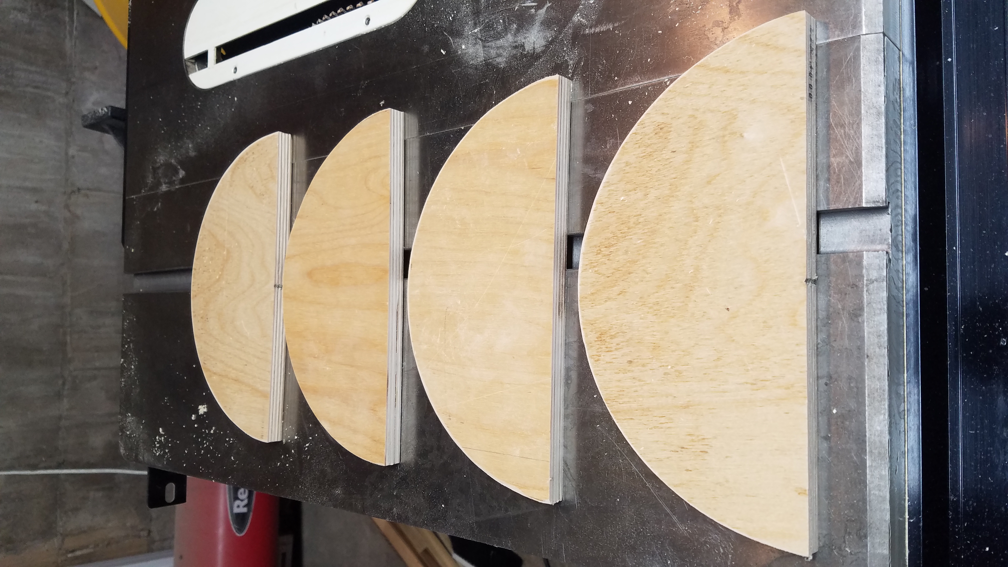

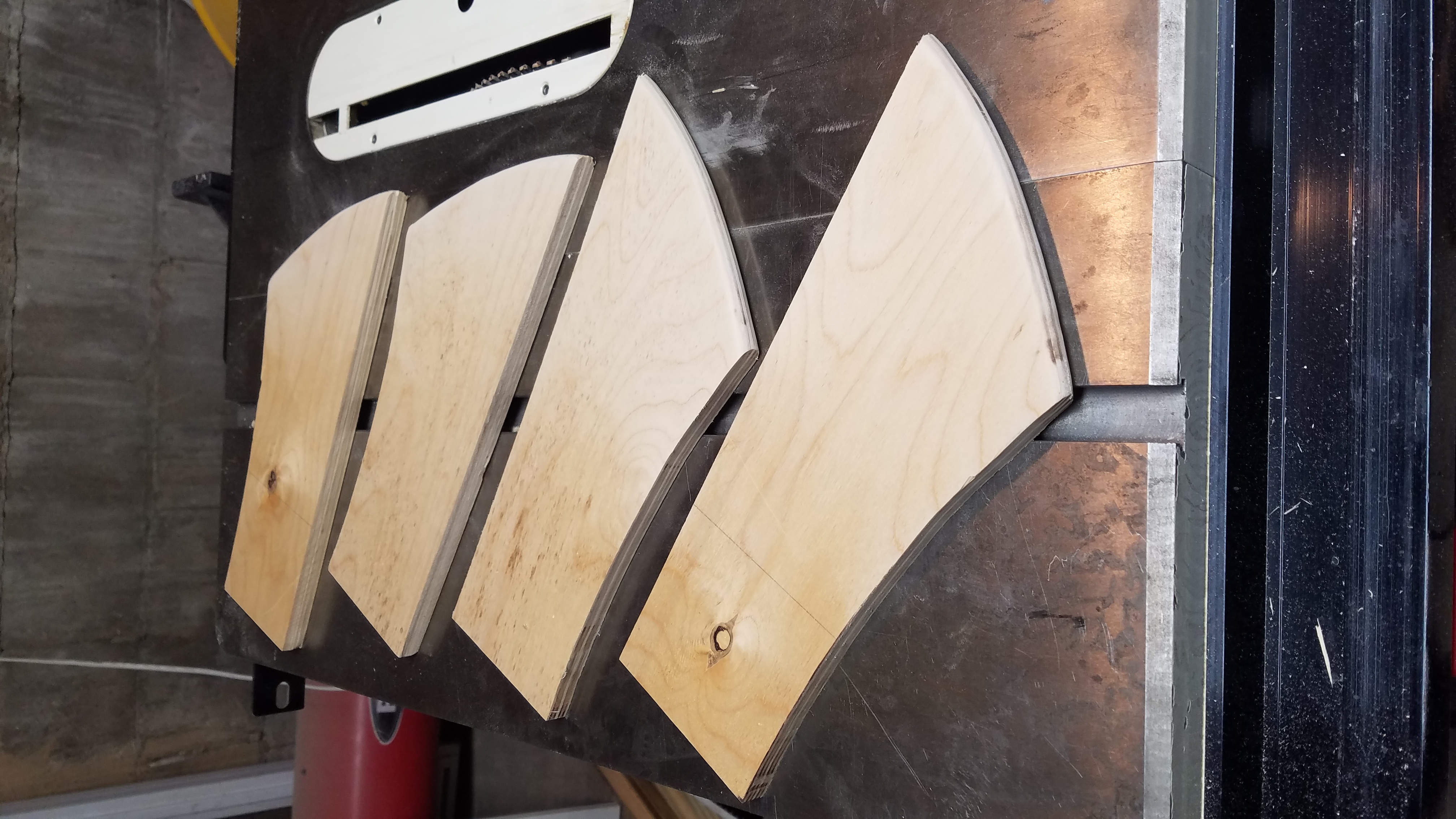

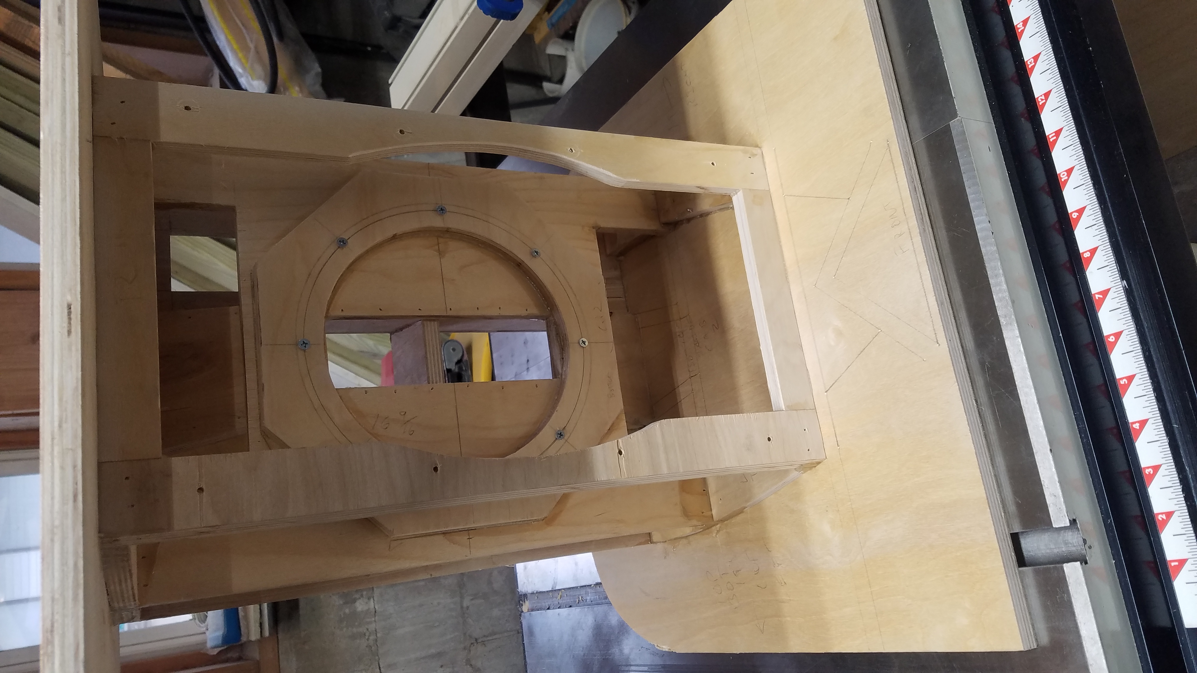

While the sheath cleats and braces are curing, I cut the back and side braces.
My son had just bought a new templating router bit, so i employed that with pretty good results.
I routered one back brace with my circle jig, then roughed the other 3 on the table saw and templated them out. Same thing with the side braces, I roughed all 4 out with table saw and jig saw. Then I sanded one close to profile and used it with the template bit. Lastly I decided to roundover the leading edge. I've seen a few do it, and I had on my tuba and titans, I like the subtle change.

All that PL is fine. However, it seems that there is a little bit of PL, that is proud, on the top RH sheath cleat. Try and make sure that all the contact areas of the sheaths will not jut out, and cause aggravation, LOL.
Re: HowieZ DR200 build
I was figuring i'd have some scraping to do! when i've built THT and Titans, it's always been easy to use a sharp chisel after it cures. With the DR's they are so tiny/intricate, I've finger-tooled some joints, and scraped others clean with a metal spatula after they ooze out. I'm hoping a small bit of chisel work will take care of that!
- Posts: 28969
It will come off easily with a chisel, but don't wait until it's fully cured.
I let it sit about 12 hours then scraped, not bad, but I should have hit it last night late i guess. I have the two cabs cleaned up, extra PL out of the important faces and crevices. I put a little white primer inside before i glue the sheath sides on today. I always like priming my cabinets inside and out just for a bit of wood protection and the clean look. Ok, i'm covering up my PL! I used white on these, all my black primed boxes make it to hard to see inside!

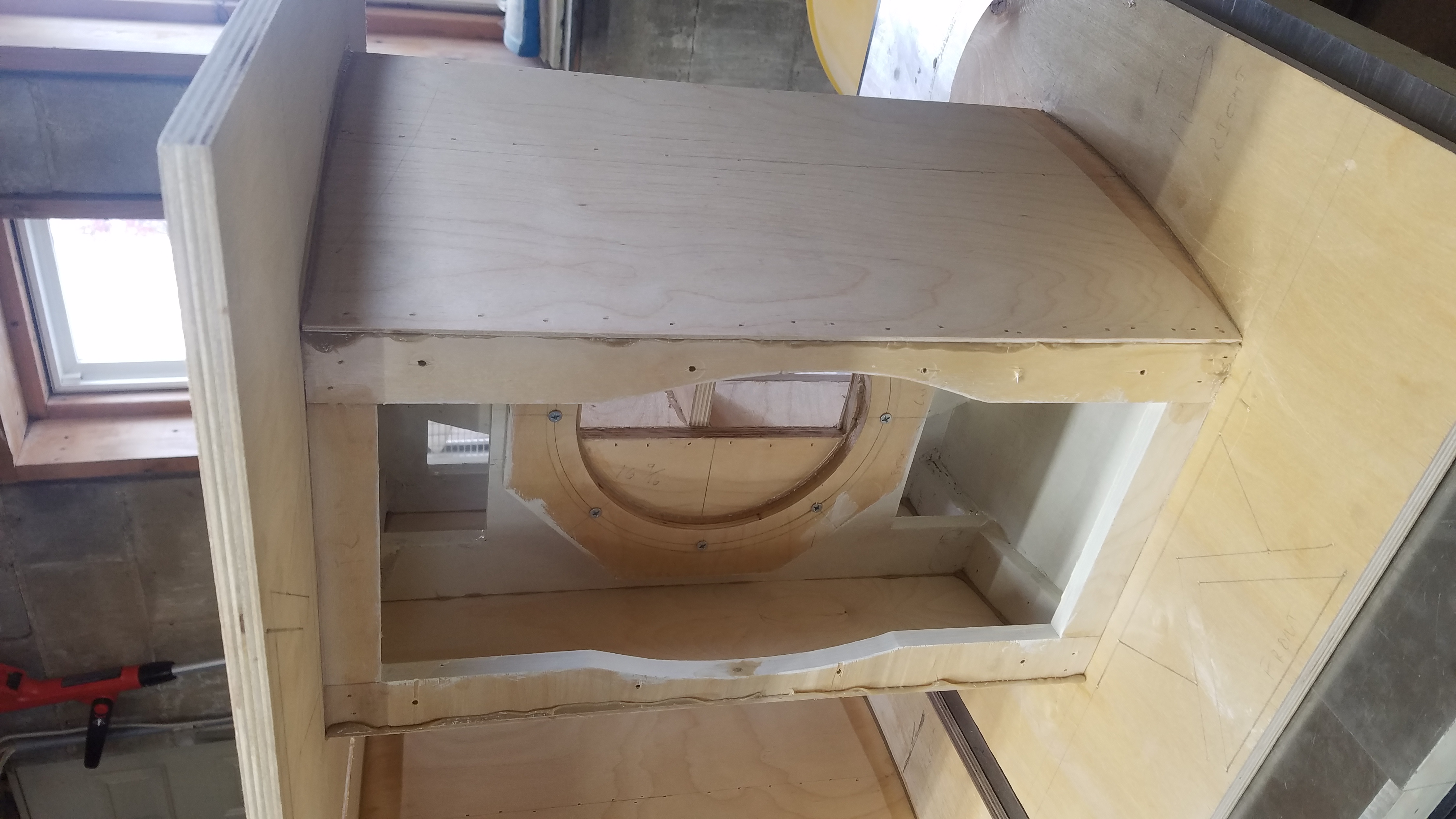

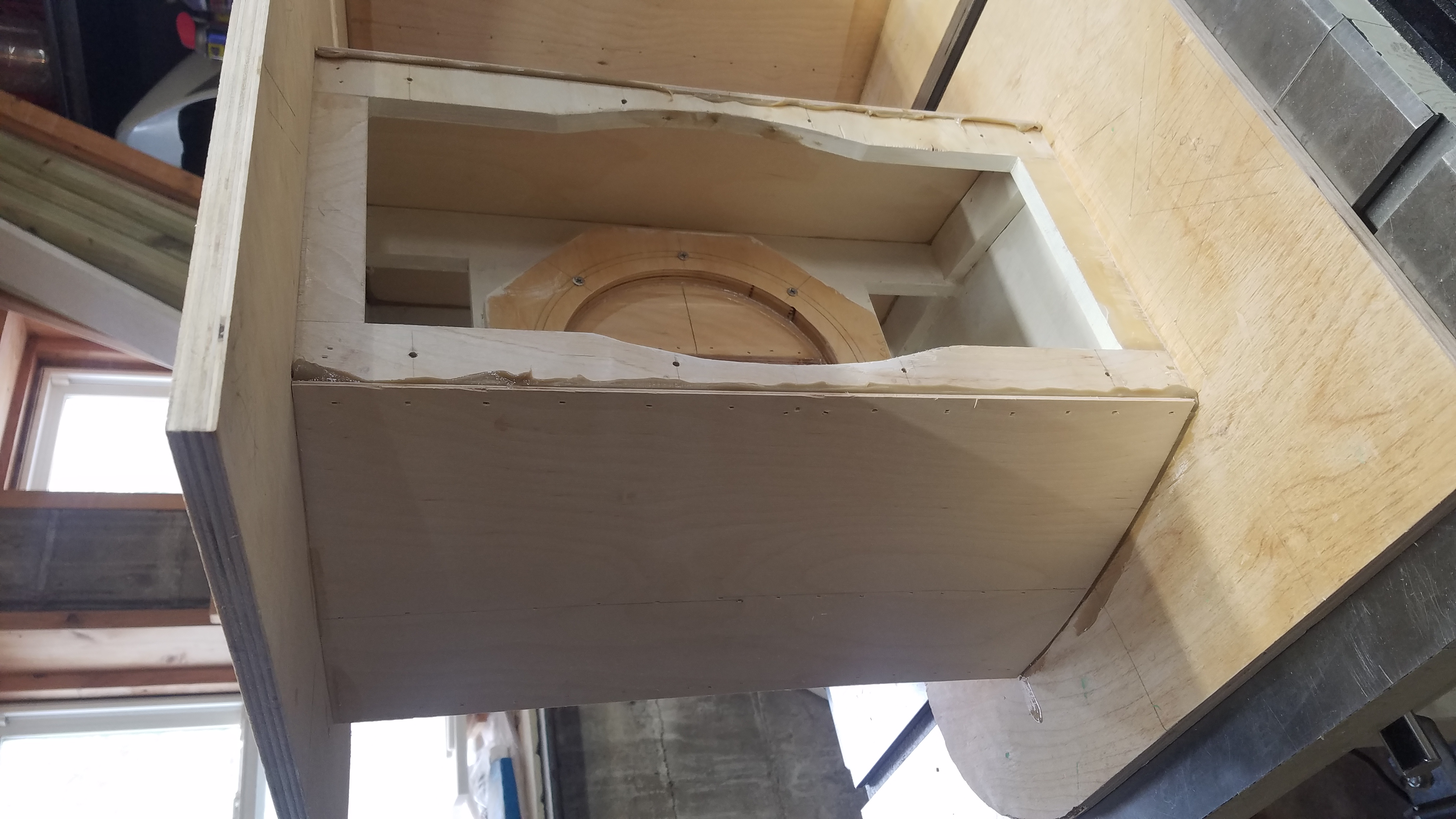

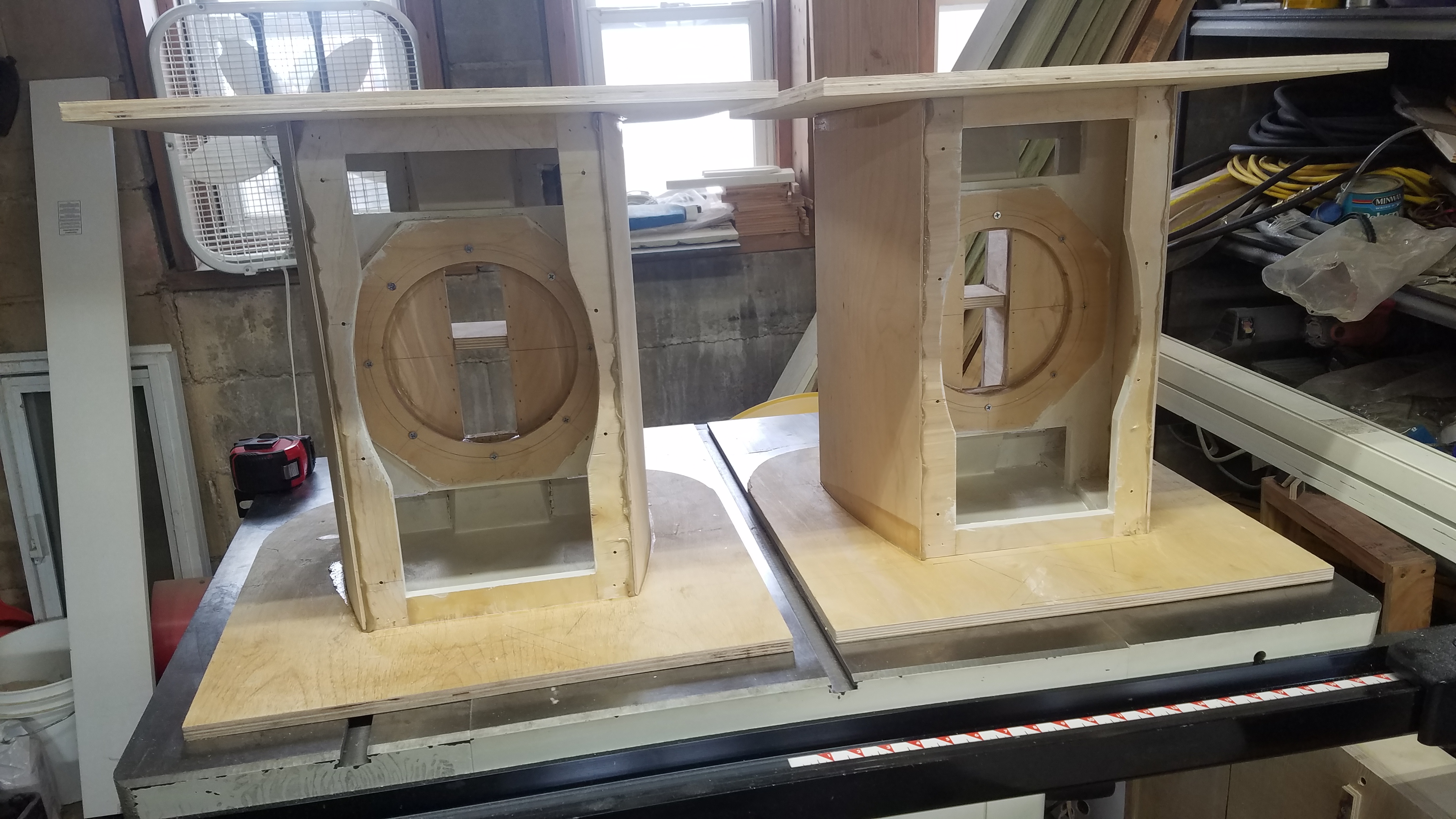

A little more progress today. I have the inside prime pictures.
I was also able to get the horn sheaths on .
Okay. It is now a couple of hours later since you posted the photos, which makes it time to clean off the PL from the front edges of the sheaths. Removing the PL when it is soft enough, without smearing, makes for easier cleanup and better matching of mating parts.
