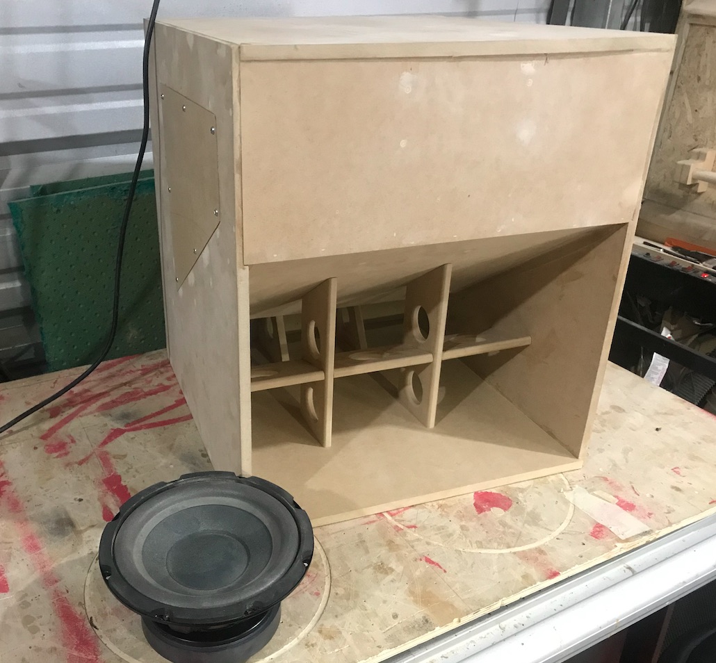

Here I have my 2nd BFM cabinet build. I have already built 6 t24 single 10's. As usual after you build you want to build something else. So an Auto tuba it is. After the T24's I bought myself a small CNC and I've included some of the pics from the machine. I built this cab out of MDF to test all my cnc cuts, fitment and to try out this mini beast before spending on higher quality/priced baltic. The CNC is nice, but the plans are actually faster, and forgiving.

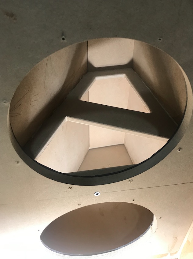

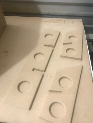

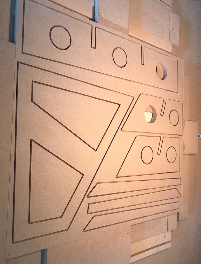

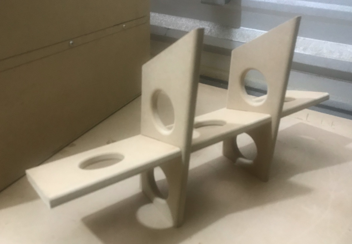

Here are my mouth brace pieces, and a brace for inside in speaker chamber (not really needed but this was a test cab and also a test of my cnc skills)

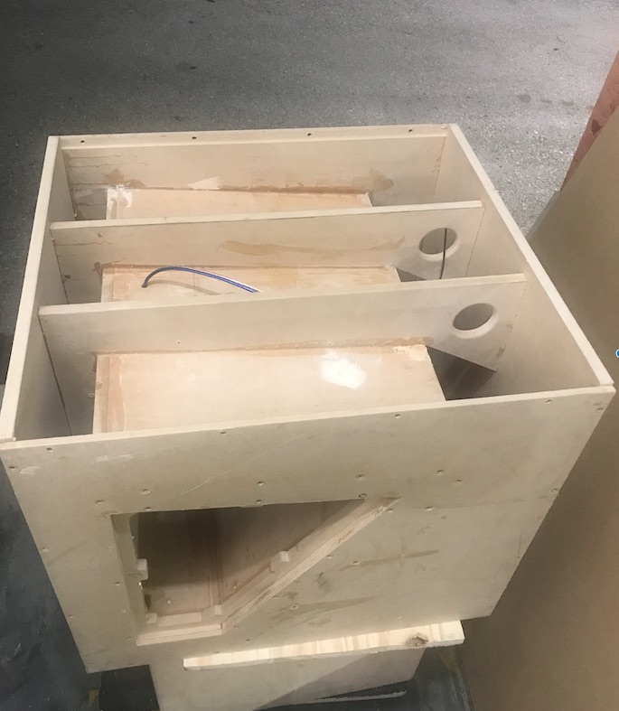

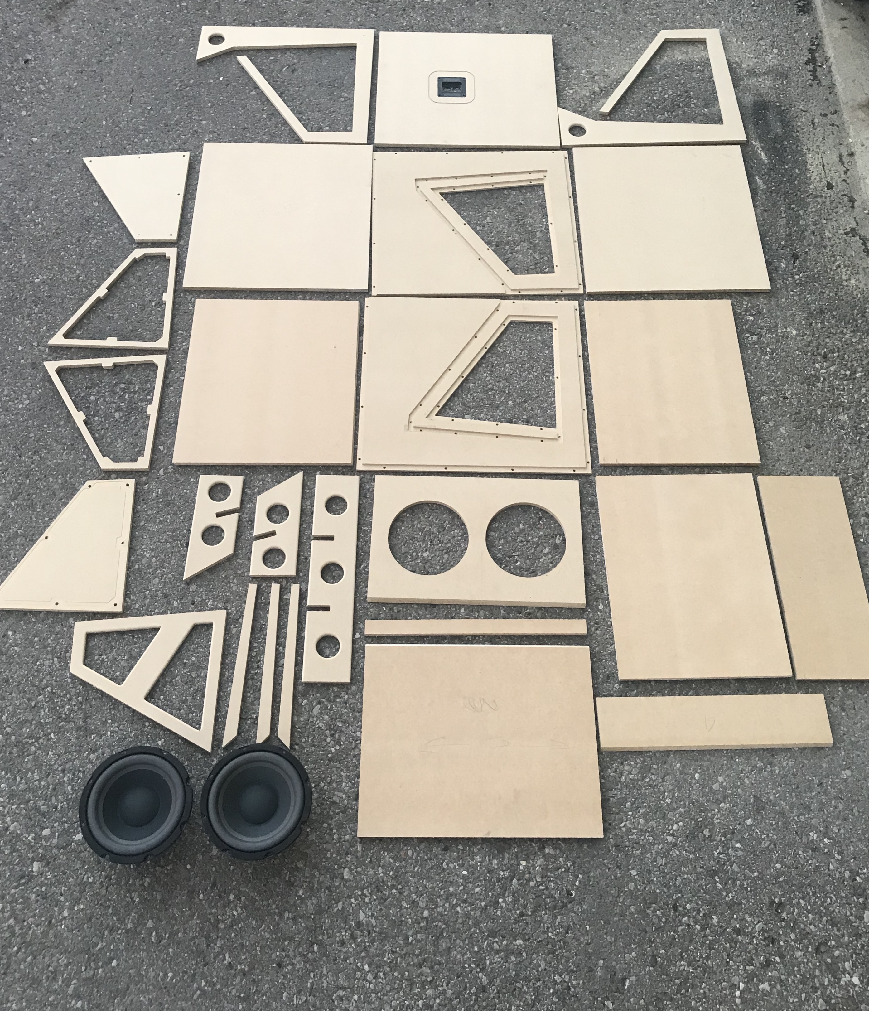

These are all the pieces that are in the enclosure. I decided on two long larger braces that you can see in the top. Nothing wrong with the plans braces. I just did it as a test and to also keep the alighment as I put it all together.
I did a .2 inch rabbit for the sides for the panels to slide into for alignment
Testing the fittings and only the back piece glued in place. Don't worry to the top piece was not secured with that gap.

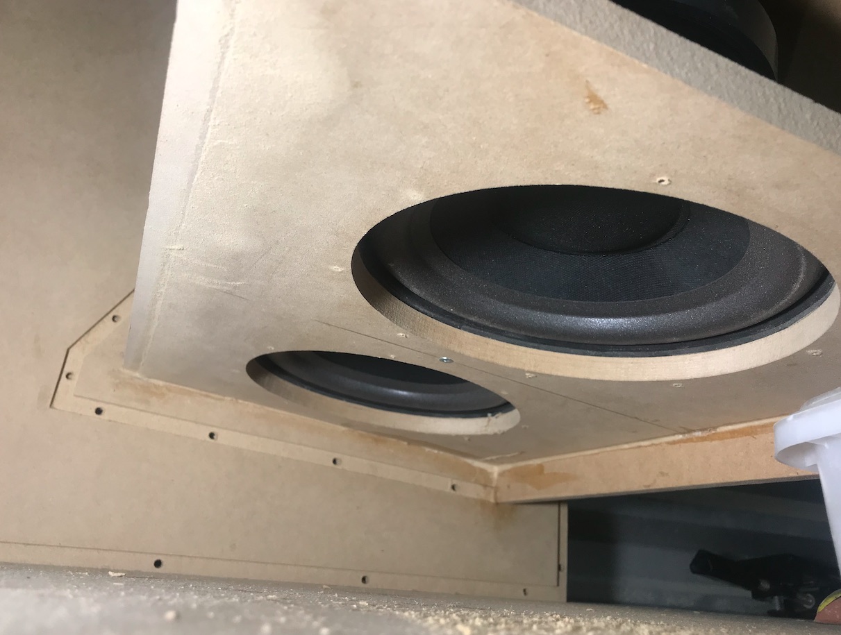

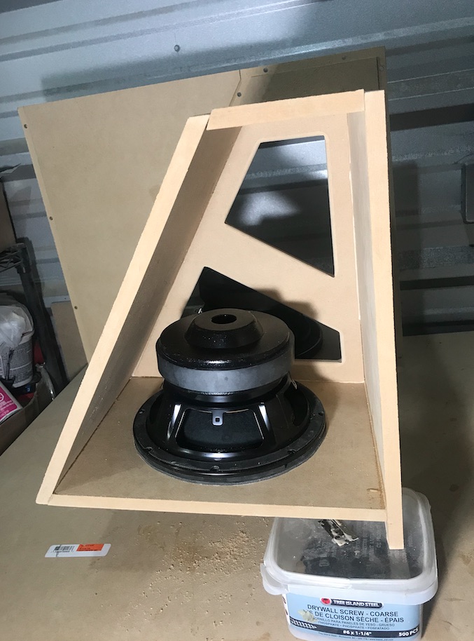

Next testing to make sure the cones were aligned over the screw holes and would not cone rub the baffle before I put the "square blocks" in place
Attached the internal brace which also helped me align my panels. All were very close with the CNC, with just left me to do a tiny bit of sanding edge to make fit perfect. As I already had t24's I was not in any massive rush to build so I took my time. I fitted a piece or two, let dry, then sealed the edges on Both side for any possible air gaps. As the pieces were .2 inch into the panel and fit snug I still sealed to prevent any leaks.
Here is that looong internal brace that is complete over kill (insert Bill rolling his eye emojie here. ...lol) It was built a little out of sequence than the plan, but on only the back and bottom order . As it was very square and let me do my wiring and connection plate work with the back off. I also did a single piece for each access panel "lip" as you can see ,and it only needed a little sanding to slide right is and very snug.
The mouth brace, I copied the look of Functionone bass cabinets as I like that look with the circles
Here is the raw cabinet prior to me starting the finishing. As you can see I purposely left the top edge longer so I can router it nice and straight and then do a round over. Still need to fill the screw holes on the one side then sanding and paint.

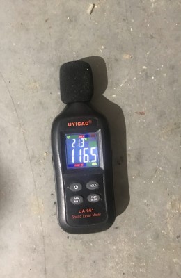

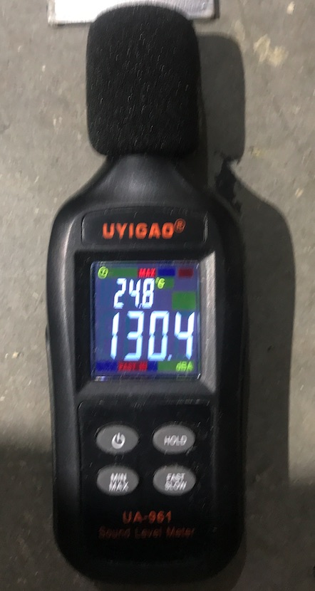

I first set my amp output to 20volts to get the cabinet playing. I was not expecting a T24 output, but was ready for some bass. But no go. as soon as I got little volume it started to make a massive "KAK, KAK" sound. I played with crossover, (no eq was on) check voltage, checked polarity, listened for air leaks everything was good...... but it sounded very bad at 1/3 plus volume. I knew I could not be the design as my t24's sound awesome. Long story short a brand new MCM driver was bad. Luckly I bought 4 of them as the idea was to build 2 Auto8 dual8's and use them for dj monitor cabs, or for bass in small gigs. New driver in and here we go.
On a ground plane (ie my garage) in the middle of the room I'm getting about 110db with music. But place in in my truck, and it maxed at 130.4db playing music. BTW the track I was listening to was Junior Reid -One Blood

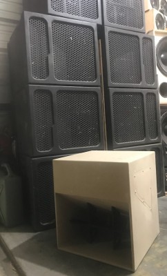

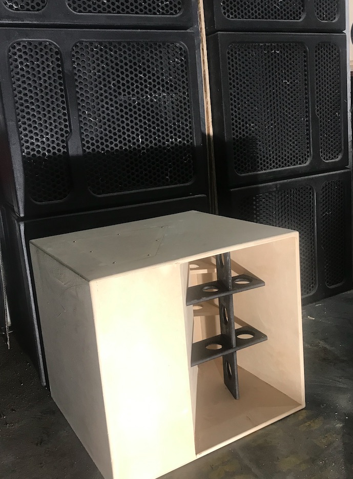

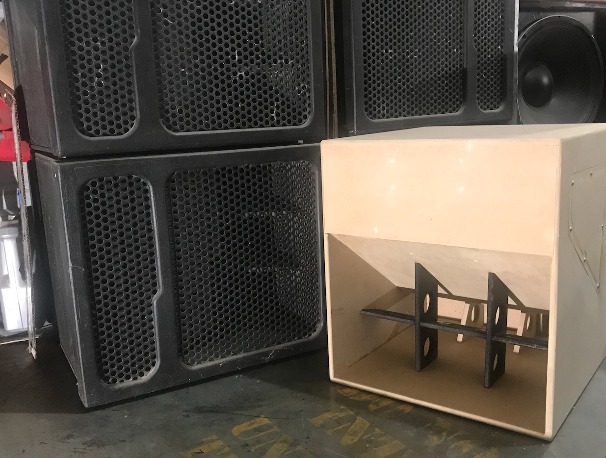

A few update Pictures, and a family picture
Did some filling ,sanding, rounding over the edges and it looks a lot more finished. The final colour will not be black for the brace. Might go silver brace and black duratex for the cabinet.
Shown infront of her bigger brother a T24's single 10 Eminence. 6 t24 cabs in total. Those were all non cnc cut.
Also did some tuning with crossover freq, types, slopes and dialed in voltage. No eq on them. And with music on the garage floor in a non perfect location she was outputting 116.5db at about 1/2 meter on the floor.

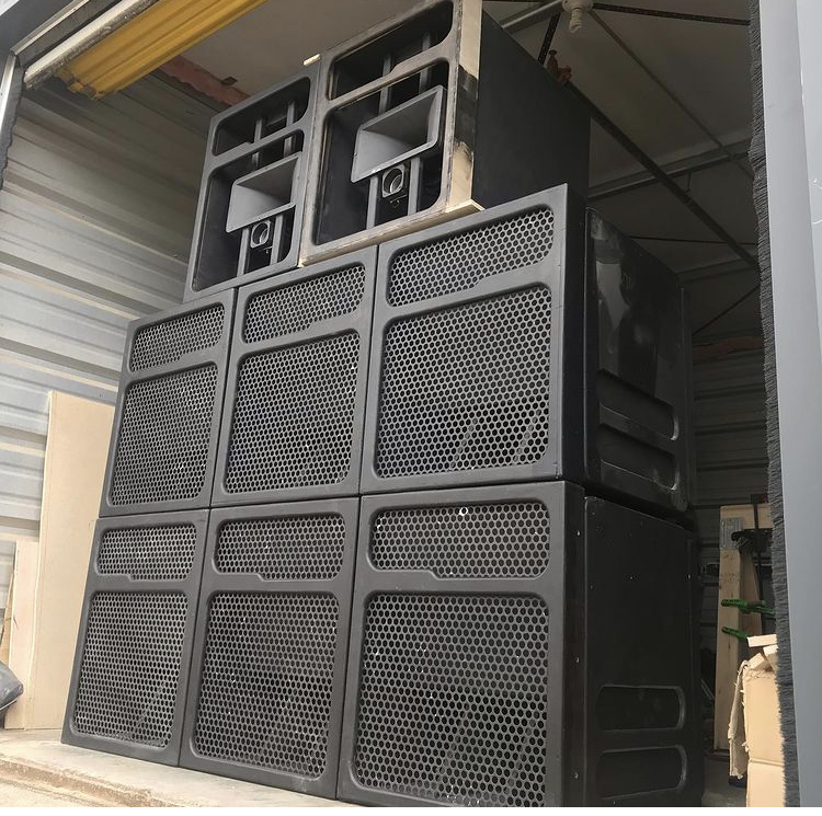

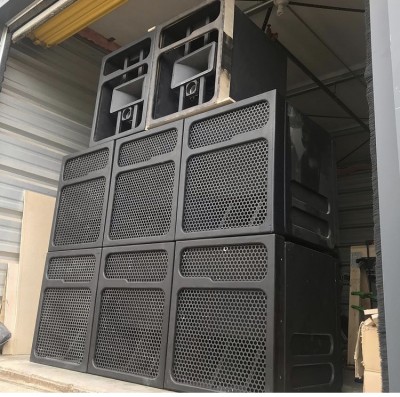

Carter: I built it for a couple of reasons. If I need a smaller sub for a smaller gig, or a sub for dj monitors, but more about to just try one out. The speakers from MCM cost less that $60 total, so a fun cabinet to test my cncing and build skills. If I used it for a potable sub I would build a baltic birch cabinet as it would weight much less. I can sell the MDF version built here to a car audio fan , to fund that build. I also don't need anymore t24's they do exactly what I want for the gigs I do (in fact they do more than I expected). As per Bills design, the autoT it is unreal when placed in a vehicle.
Himhimself: The grills on the t24's are that way for a number of reasons.
Why Grills:
1: Grills on them because of two things that I have delt with in the past as a sound tech at clubs. They get full of bottles and cans, and a rattling bottle in the mouth of the horn sounds horrible. You would be amazed how loud a bottle can get get when a good subs bounces it around. Regardless of speaker placement cans and bottles seam to really like to find speakers.
2: Winter in Canada includes winter coats. The mouth of the subs usually end up being coat storage. One club I worked at , I was removing coats from some CV horns. A girl told me that "she knows the owner, and he said these cubbies are for coats" lol.
Why the shape:
For sound people that see them I wanted to keep them guessing, so the grills looks like its an 18, with a port at the top. Its funny that some people hear with their eyes apparently. I have had people ask if " are those 18's or 21's ?" when I say its 6 -10 inch woofers they say "in each cabinet?" lol. Because they can't see the speaker thought the grills they think I'm telling stories. They look like they double be 18's because I built a 20 inch wide T24 version.
The grills are also left and right versions just for looks. here a better picture of them with my own tops (prep-finished) the tops have the same grill idea to keep it consistent. The little wave/s bend is purely for looks. I have tested with the grill in place, and off, there is no real world difference in the performance or sound.
