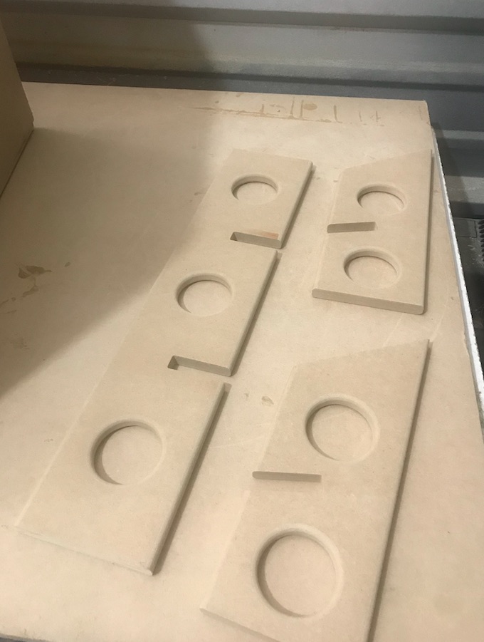

Here are my mouth brace pieces, and a brace for inside in speaker chamber (not really needed but this was a test cab and also a test of my cnc skills)

These are all the pieces that are in the enclosure. I decided on two long larger braces that you can see in the top. Nothing wrong with the plans braces. I just did it as a test and to also keep the alighment as I put it all together.
I did a .2 inch rabbit for the sides for the panels to slide into for alignment

My cnc does unto 32X32 inch, so I can cut the side panels of upto a t30 (I bough plans for t30,t24, and autotuba). The cnc I used for the braces, sides, baffle, and speak plate pocketing on the back. All other panels are cut on my table saw. Yes I have made a few other cabinets that are my designs, but just posted the BFM. Saw dust flies again tonight as I start the finishing process.

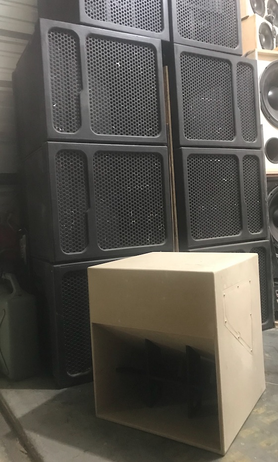

A few update Pictures, and a family picture
Did some filling ,sanding, rounding over the edges and it looks a lot more finished. The final colour will not be black for the brace. Might go silver brace and black duratex for the cabinet.
Shown infront of her bigger brother a T24's single 10 Eminence. 6 t24 cabs in total. Those were all non cnc cut.
Also did some tuning with crossover freq, types, slopes and dialed in voltage. No eq on them. And with music on the garage floor in a non perfect location she was outputting 116.5db at about 1/2 meter on the floor.

Interesting look to your T24s. I like it. Any reason for that shape of the grill frames?

Carter: I built it for a couple of reasons. If I need a smaller sub for a smaller gig, or a sub for dj monitors, but more about to just try one out. The speakers from MCM cost less that $60 total, so a fun cabinet to test my cncing and build skills. If I used it for a potable sub I would build a baltic birch cabinet as it would weight much less. I can sell the MDF version built here to a car audio fan , to fund that build. I also don't need anymore t24's they do exactly what I want for the gigs I do (in fact they do more than I expected). As per Bills design, the autoT it is unreal when placed in a vehicle.
Himhimself: The grills on the t24's are that way for a number of reasons.
Why Grills:
1: Grills on them because of two things that I have delt with in the past as a sound tech at clubs. They get full of bottles and cans, and a rattling bottle in the mouth of the horn sounds horrible. You would be amazed how loud a bottle can get get when a good subs bounces it around. Regardless of speaker placement cans and bottles seam to really like to find speakers.
2: Winter in Canada includes winter coats. The mouth of the subs usually end up being coat storage. One club I worked at , I was removing coats from some CV horns. A girl told me that "she knows the owner, and he said these cubbies are for coats" lol.
Why the shape:
For sound people that see them I wanted to keep them guessing, so the grills looks like its an 18, with a port at the top. Its funny that some people hear with their eyes apparently. I have had people ask if " are those 18's or 21's ?" when I say its 6 -10 inch woofers they say "in each cabinet?" lol. Because they can't see the speaker thought the grills they think I'm telling stories. They look like they double be 18's because I built a 20 inch wide T24 version.
The grills are also left and right versions just for looks. here a better picture of them with my own tops (prep-finished) the tops have the same grill idea to keep it consistent. The little wave/s bend is purely for looks. I have tested with the grill in place, and off, there is no real world difference in the performance or sound.
