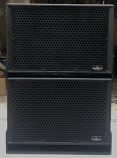

One side done. What a pain. Could be better, probably will try again someday but this will be good enough for now. For sure will look fine in the dark, but the next couple things coming up our outside during the daytime. Oh well

Second set went a bit better. Not sure the foam is adhered well in the middle. Maybe too hot and humid today. I think the compression around the edges will keep it in place. All four strapped back on their wagon now.

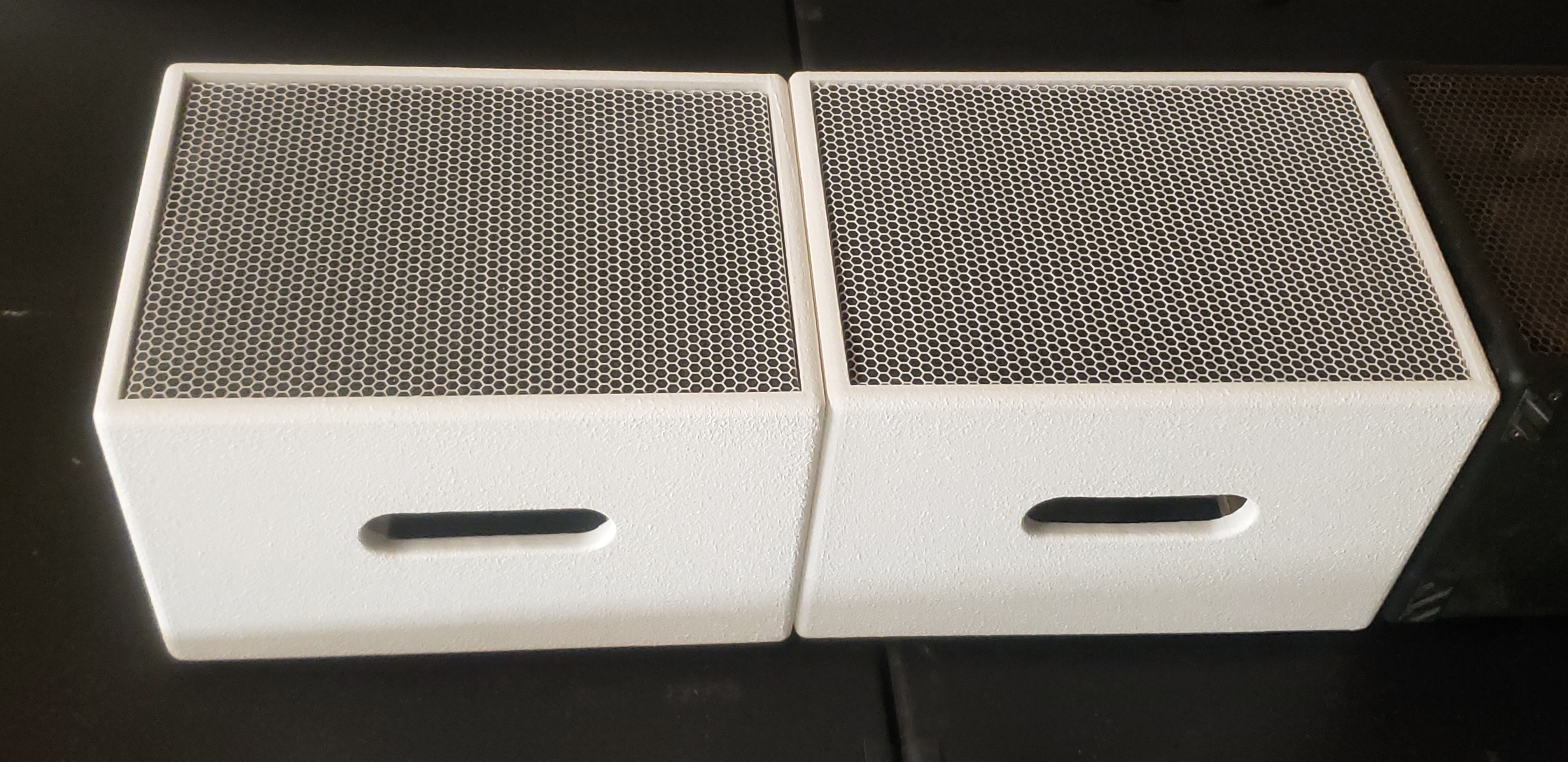

I ended up getting a can of the Gurilla Glue spray adhesive last time as it was the only stuff I could fine in stock.
Turns out, I think I like it for attaching grills. It doesn't really spider web like the other stuff.
I spray a heavy coat on the back of the grill and then light coat on the foam. Give them a few minutes or so to tack up and carefully unit the two.
Here's some artic "Minis" 2x6 SLA I used it on th3 other day.

They look great, nice job. Might have to look for some gorilla spray next time.Strange Kevin wrote: ↑Sat Aug 28, 2021 3:50 pm Here's some artic "Minis" 2x6 SLA I used it on th3 other day.
