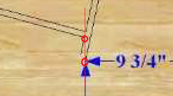

on thr page 4 on the diagram i have two same parameters 9 3/4 is there two times and there should be another number because it is not straight on the image

There is no mistake. The measurements were taken directly on the sketchup model. Measure your own sketchup and you'll see.

I assume you're talking about the lower right corner of Layout Diagram 1 on page 4 and Layout Diagram 2 on page 5...
Here's how those two 9¾" dimensions coincide with each other, each is indicated with a red circle
Screenshot (106).png (59.69 KiB) Viewed 1030 times
