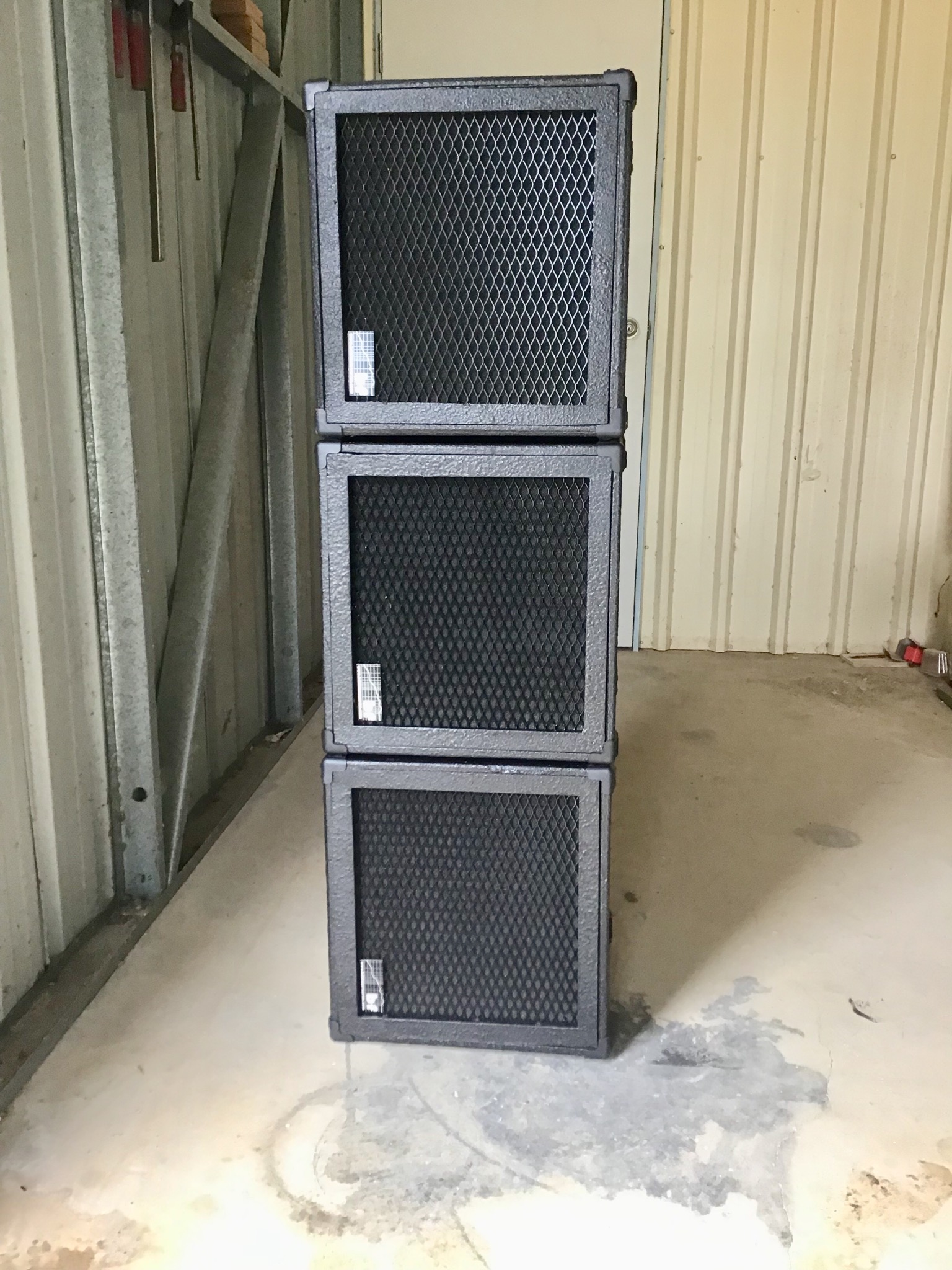

Well, nearly twelve months later, the second trio are done!
The build was essentially the same as described earlier, cut up all three, assemble one, then assemble two.
In testing, at lower power, and a little tweaking, these monitors surprised me again at their full range capability.
Just in time for the gig they are required for on Friday...

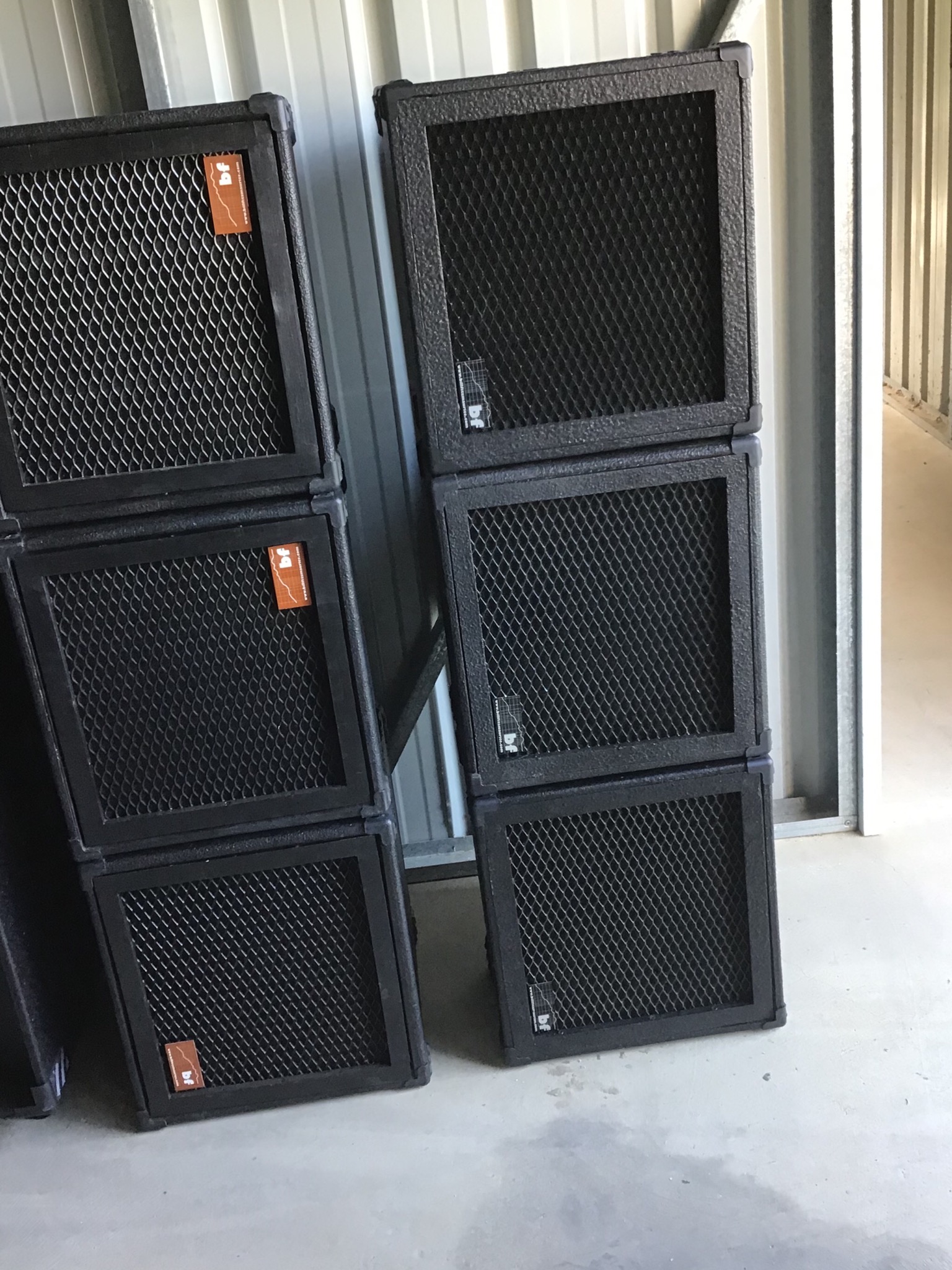

All 6
