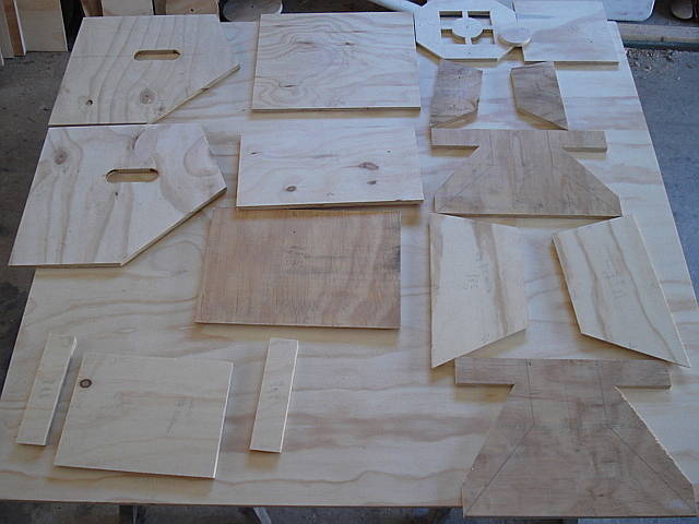

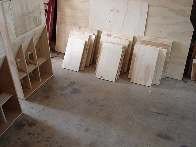

A shot of three piles of blanks cut.
There's some unfinished business just to the left, but that's another thread :lol:
After the blanks were cut I started working my way through 3 sets of cutting everything to correct final size..

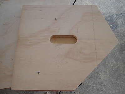

Starting at the beginning, with sides. I screwed each cabs sides together, drew up and cut both at the same time so they are identical on a cab to cab basis. Then did the ports.
Cab 1 done, all looking good:

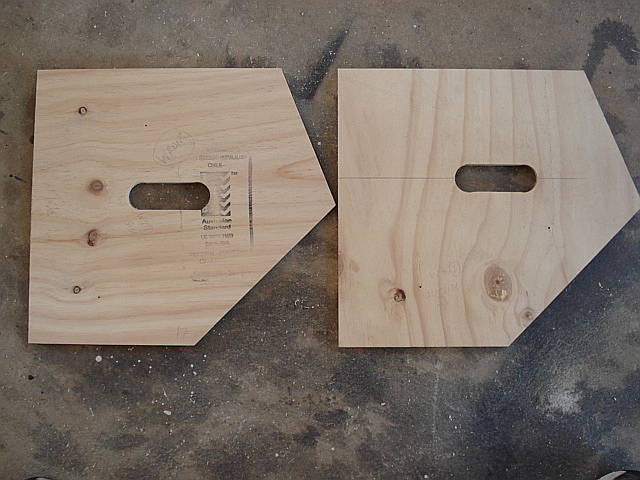

It was only when I was drawing up the second cabs ports position I had a niggly feeling. Like something was wrong. Yep, given all the builds I've been doing lately, you'd think I would take more care reading the plans (especially after the DR mistake) and measuring twice and cutting once.
Turns out I had the 6 and the 7 the wrong way around!
All was not lost, I had a couple of exactly 15" left over pieces large enough to redo the sides for cab 1, because they were wrong :wall:
It did slow me down though. Simple mistakes argghhhhh.
The side on the left is wrong, it says so in bold pencil:

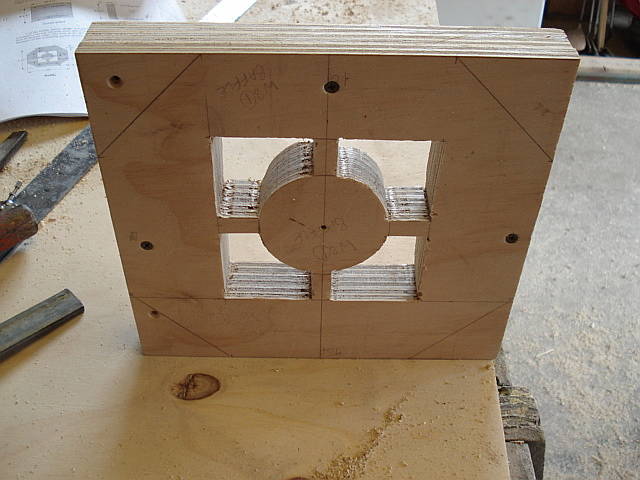

I got to the baffle. Hmm, can I do all three at once?
I screwed all three together and went for it. If it all messed up I had more ply.
I would like to have had time to do a template for the router, but, oh well.
A slab of baffles:
They turned out fine, just a little extra trimming and sanding/filing and they are good to go!

Yes I did do the cutting out of the baffles with a jigsaw. I drilled some holes as blade access points and flipped the baffles over as most jigsaw blades don't cut straight.
After I pulled the screws out a finer blade and some sanding sorted them.
Some things you can't rush.
When I did my braces I screwed them together and used hole saws rather than jigsaw. Huge difference, done in a flash..

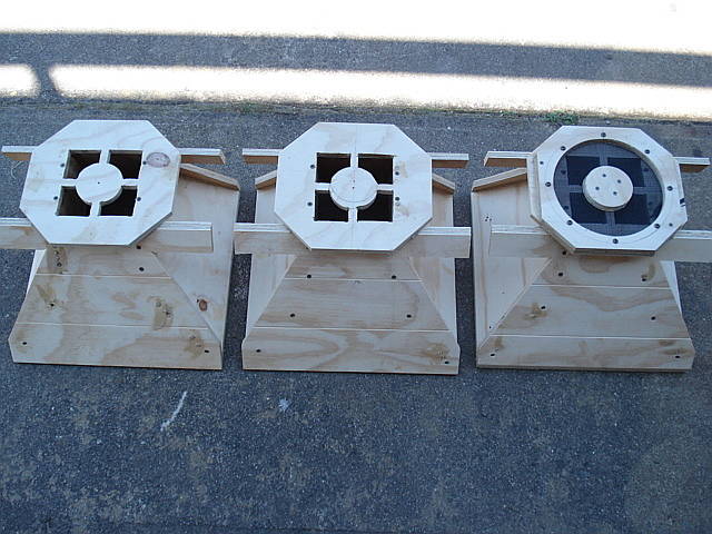

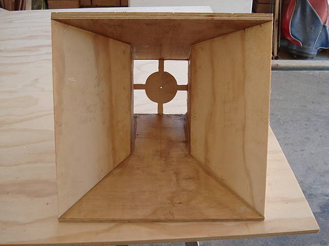

All three throats built:
So far I've built one "outside':

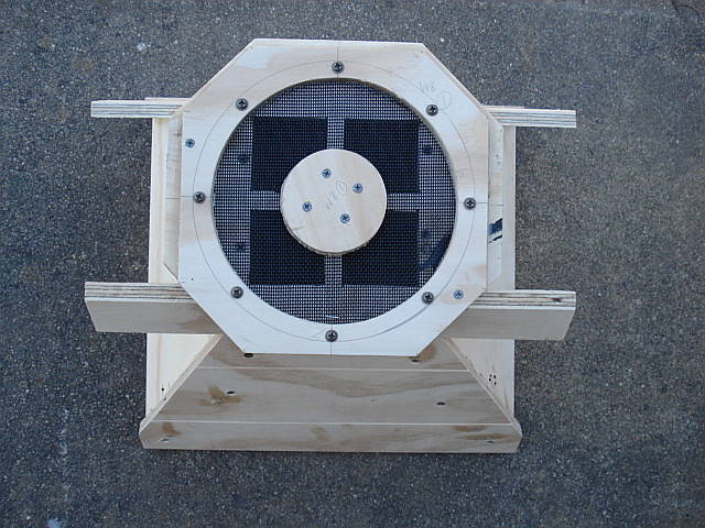

Driver spacer cut and after assembly:
You can see driver screws holding down the spacer until the PL sets.
This one has also been trimmed to fit the cab...

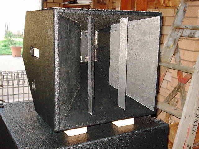

Cab 1 is assembled and has been trimmed, bondo'ed and sanded and routed.
Horn of cab 1 painted.
Cab 2 shell is built.

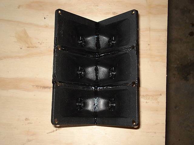

Here's a shot of a randomly selected melded array for the WH8's:
I'm very happy with these arrays....

Array diffusers added and arrays painted with rattle tin, plum purple same as the arrays for my DR's.
