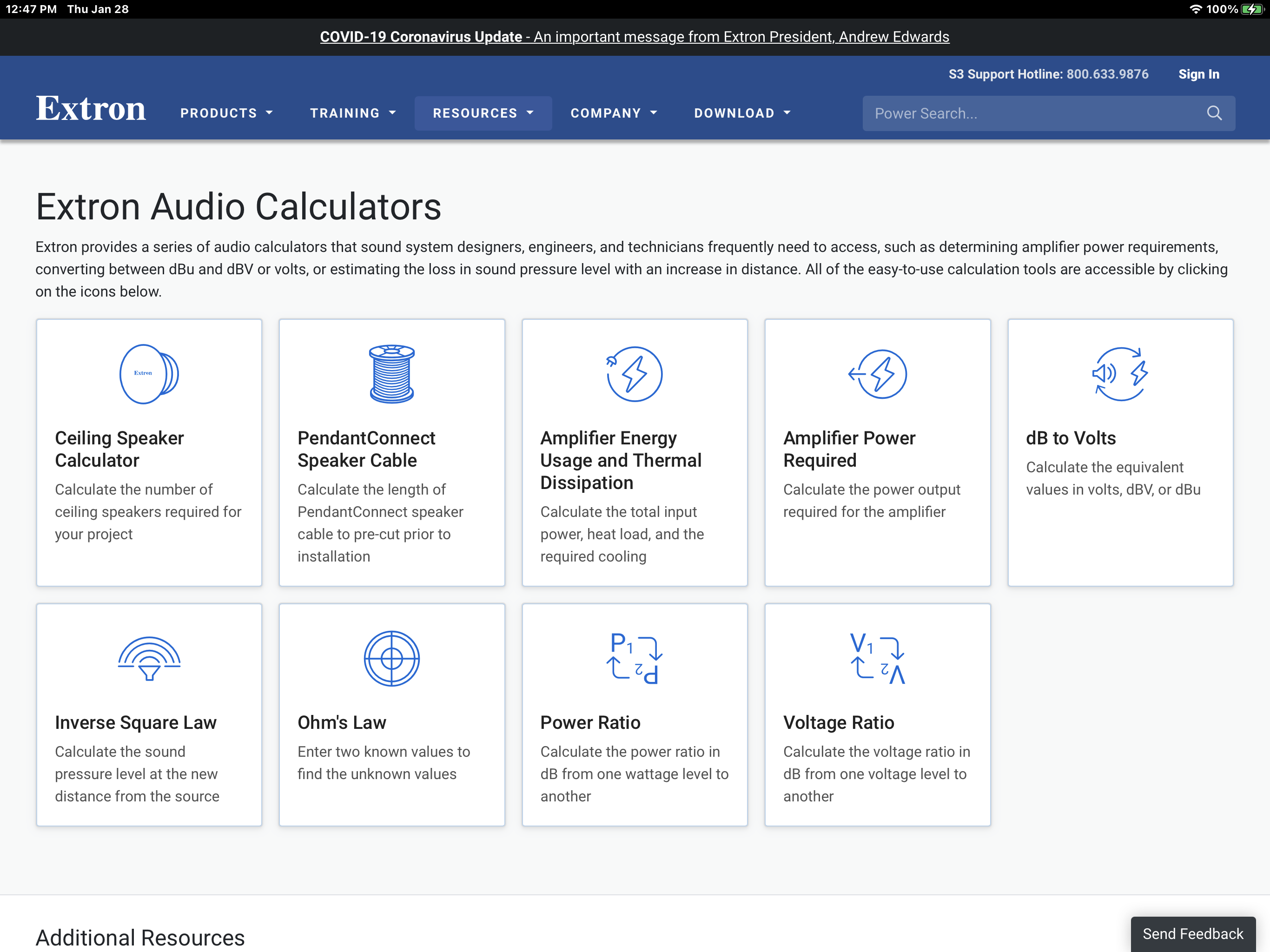

Does this calculator from this company be of any benefit?
I only see Dbu on my DBX IN LIMITER setting don’t see voltage and there is a gain thing too.
How exactly do I put wires from pink noise to LAB 15 To break in ?
That just arrived, it’s cool

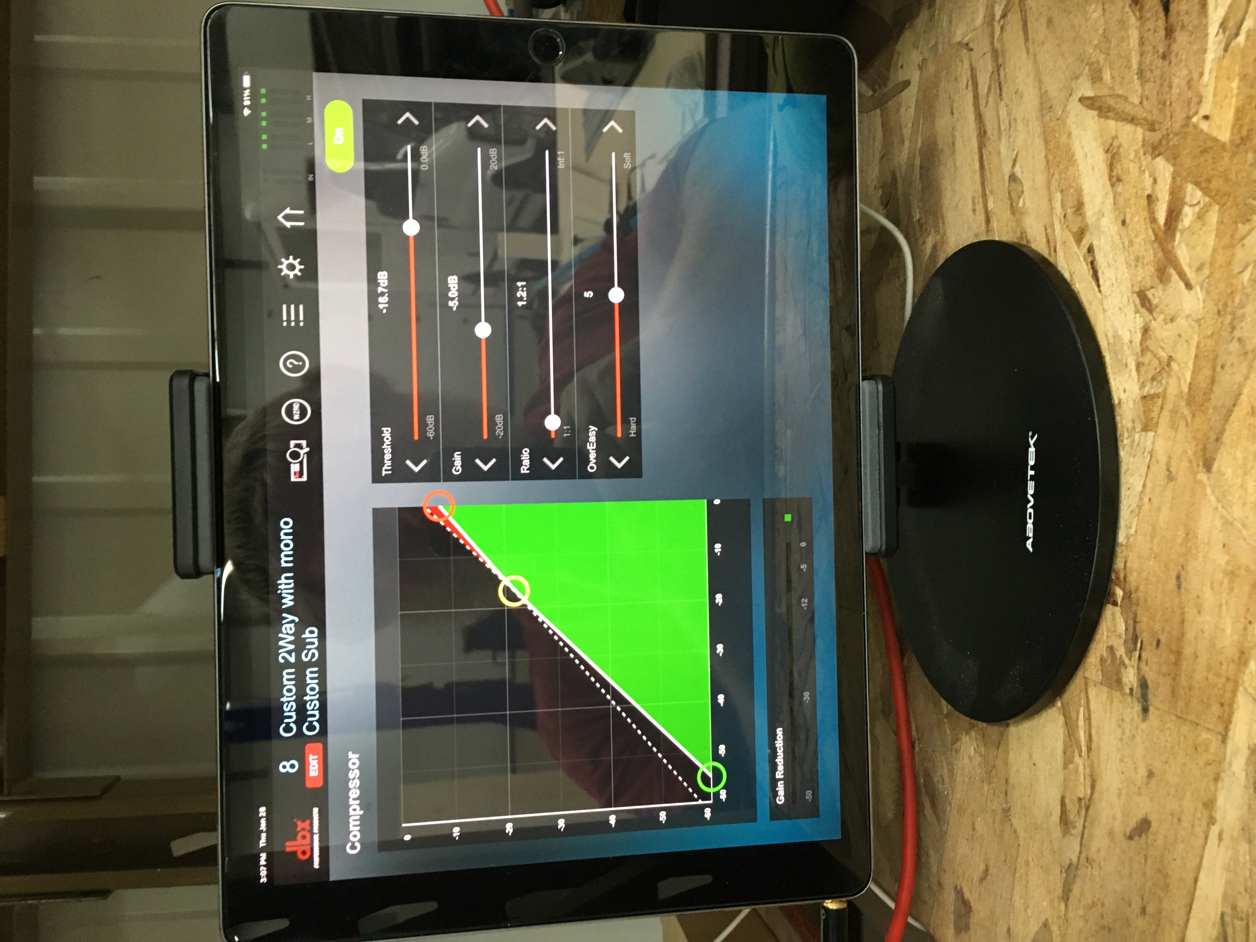

Ok got speaker doing it’s break in
Trying to send a screenshot of my DBX limiter screen so far fail http error
Compressor pic seemed to work
Pics too large
Got to figure camera quality out

Start with Threshold all the way to the right, then you'll move it to the left until you're amps output voltage comes down to 60 volts.
Gain in the middle, 0dB
Ratio all the way to the right, Infinite.
OverEasy... uhhhhhhhhhmmm. Not sure about that one. Read the description in the manual. Not sure it's too important since you're not likely to be riding the limiter. Perhaps one of the guys who have used this unit will chime in.
Bruce? Looks to me this unit has the same " PeakPlus™ type limiters" that the Xti amps use (notice the trademark).
dbx DriveRack PA² Manual, limiter settings are on the page marked 44 (page 46 of the document)

Turn the compressor off on all outputs.....highs, mids, lows. You'll only use two of those, but turn 'em all off.
You will be limiting the LOW output. In the limiter, turn off the over easy.
Do not use the dbx setup wizard. Set everything to CUSTOM.

Overly easy is explained in manual as a soft knee or hard knee for the cutoff of the limiter.
Any thoughts on how much amp I need for the Lab 15?
Currently using Peavey 1500 bridged @ 1,000 @ 8 ohm, but I have PV 900 also

50 volts into 6 ohms is 416 watts
To calculate watts from volts... Volts times volts divided by ohms = watts
To calculate volts from watts... The square root of the product of watts times ohms = volts
Out of the amps you have, either one channel of your IPR2 3000 or the PV900 bridged.
Wow now that explains a lot, the fog is lifting
