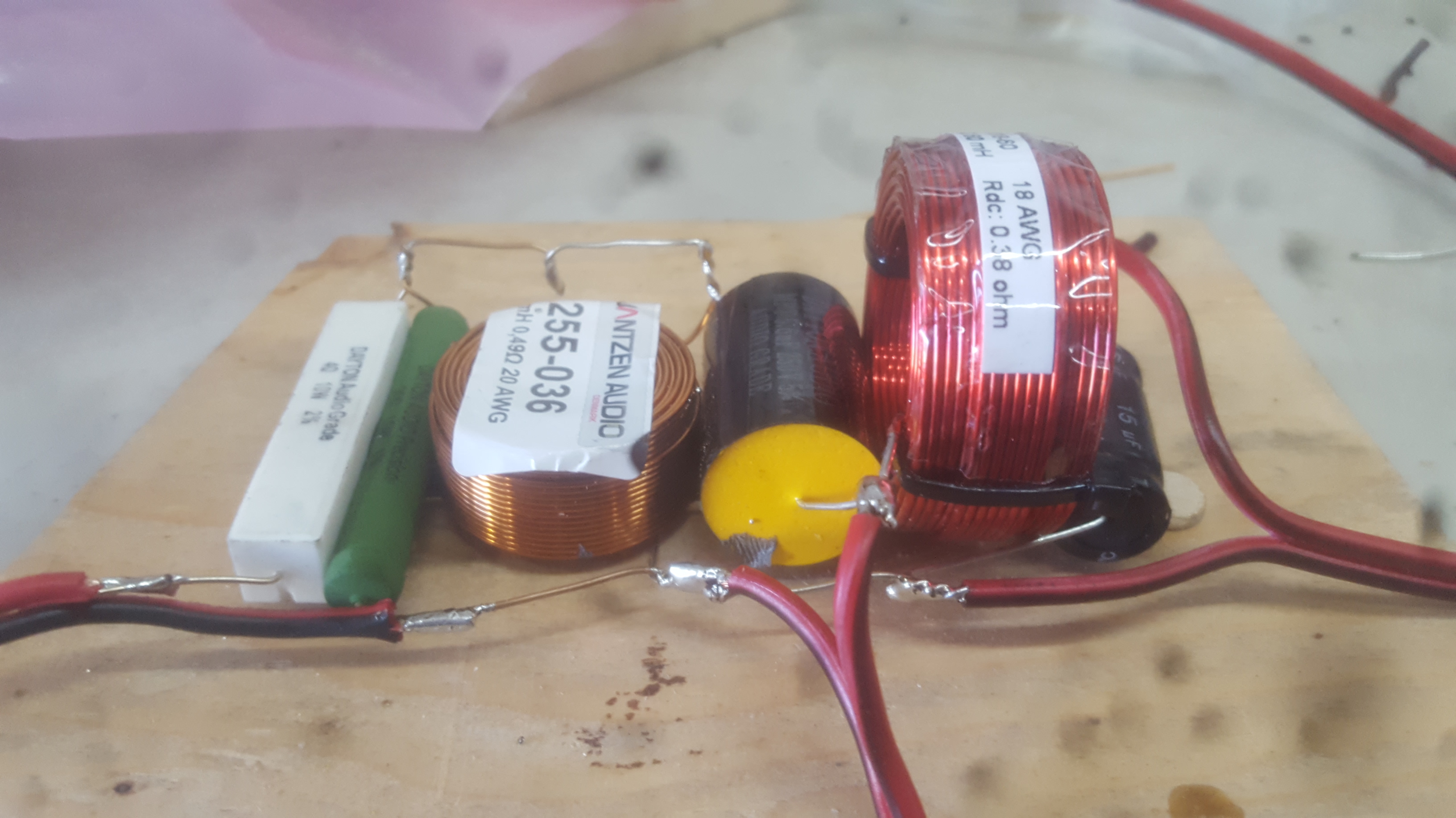

Was inspired from the Parts Express video on YouTube of the assembly of the passive crossover for one of their DIY speaker kits, where they just solder all the components together without mounting them on anything and just glue the soldered components in the box with some polyurethane glue. Didn't want to do it exactly that way. Wanted a little structure for the components to hang on to until they're glued in their final spot in the cabinets. So, I chose to assemble them on popsicle sticks. Took a good amount of thinking the layout through to make the components easy to wire up without any jumpers. I'm pretty happy with how they came out.
The black messy stuff is rubberized CA glue that I used to affix the components to the stick.
Here they are all soldered up. Input is in the middle, tweeter out on the left, woofer out on the right.
