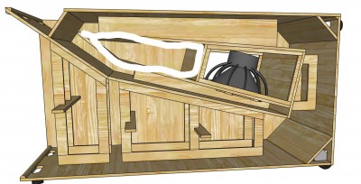

My friends are going ahead with their T60s and are going to build a stack of DR250s on top. 4 with a melded piezo array and 2 with a flat array, Deltalite 2510s.
They've mapped the T60s into their CNC software and it's looking very tidy (exciting). However, they decided it's a good idea to leave a hole in the side of the bin, because they would prefer cable access there:
Both sides of that otherwise sealed chamber which isn't a part of the horn path (meaning a hole right through).. I told them I think this is a really dumb idea as it will change resonances and perhaps even pressure.
I know I was told to "follow the plan to a T", which I respect! I'm not the one doing the build or funding it though, merely consulting. Curious on how this would affect the performance of the bin and why, hoping I can talk them out of this decision as I'm concerned at worst it could alter the pressure or resonance of the bin and change it's power handling? Perhaps I'm wrong though :)
Posts: 29119
Re: T24 as a "kick bin" above T60?
That is an option, along with putting the Speakon connectors inside that chamber to prevent people from tripping on them. It's in the plans and is shown in two of the Sketchup models.
