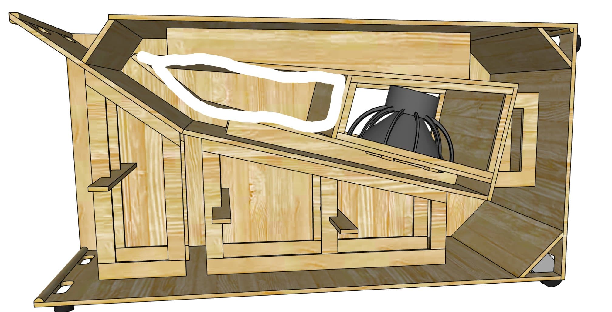

I have a friend building 8x T60s as an outdoor party / bass music rig. We are wanting to have a four way system for cleaner low low extension and better low mid transient response also (take some of weight off the tops). In looking for options which wouldn't provide too much difficulty with potential phase issues, I looked at the T24 design and response.
Since it gets most responsive around 80Hz and looks solid up to 200, I figured it could work reasonably well, since it's also a similar design.
Wondering a few things. If anyone else has done this or if there's any obvious reason this is a dumb idea.
I note the suggested driver (Eminence BP102) has a stated usable frequency range of 40Hz - 2k, so I'm curious how the T24 would go above 200Hz (say we wanted to cover 2 octaves 80 > 320 with it)? Tbh it's more likely it would only cover 80 - 160 anyway, but just wondering about the usable range of this box.
If it's a reasonable idea, how many T24s would be needed to keep up with 8x T60s (assuming X of 30 - 80 & 80 - 160).
If it's a dumb idea, any links / suggestions of a more suitable design for the purpose would be awesome!
