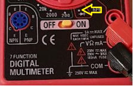

Ok Bruce this is what I hooked up to see a reading

My suspicion is that you have this meter... https://www.harborfreight.com/electrica ... 63759.html
Anyway, if you look on the lower right you will see an upside-down horse shoe, which is the "ohm" symbol. Place your dial on the 200 of that part of the range. The red lead should be in the middle red hole that has the "ohm" symbol, and the black lead in the "com" hole.

#70 Post by djlivex »
Yes Tom that is a Harbor Freight meter I have, and is shown on the pic above how I tested the connections.

If you put it in this setting and touch the leads together, does it beep?

SethRocksYou wrote: Fri May 29, 2020 12:40 am thumbnail-22.jpeg
+1
That's what I was going to say.....if it doesn't, then move the red lead to the upper hole. You aren't reading anything, just seeing if it is passing signal.
That's the setting I use mine on 99% of the time - because I test every cable I build that way. Great for checking them on the fly at a gig when you aren't sure if you have a bad cable (other people's cables - I don't have bad cables :mrgreen: )

Bruce sorry late reply I did a lot of errands with the wifey, you know how it goes. Anyway no beep in that picture. I did rearrange my sound system for testing purposes I pulled out the turntable, amp, mixer, and BBE. Will test soon my son in college is online class. He'll be done in a couple of hours. Thanks
