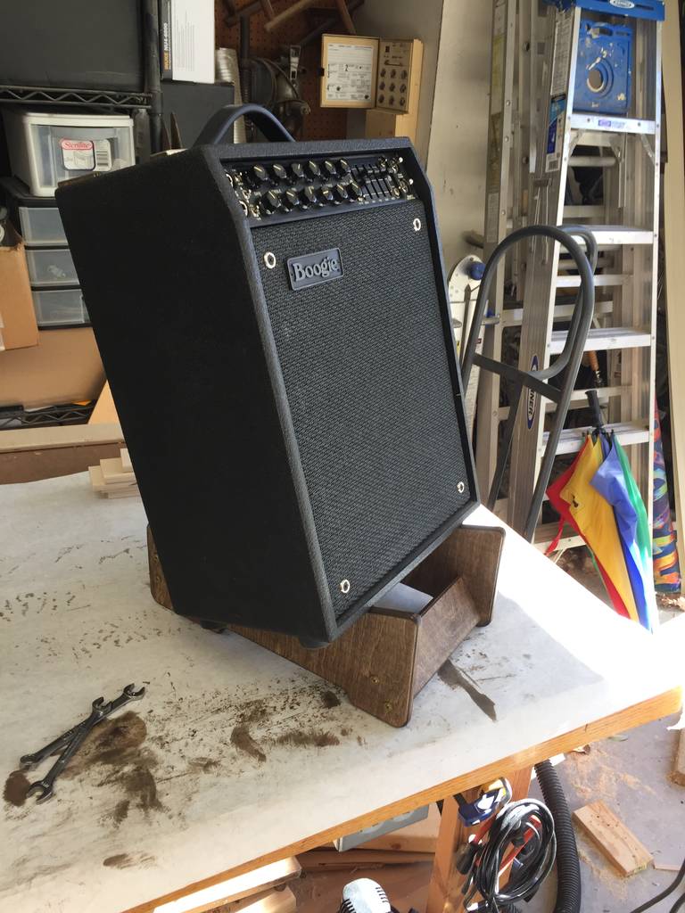

A vertical orientation will have a wider dispersion than a horizontal orientation. The XF has a crossfire configuration to try and get back some of the dispersion lost by putting the drivers side by side.
I built an amp stand to hear mine better.....It looks much better than the tall metal stands.
